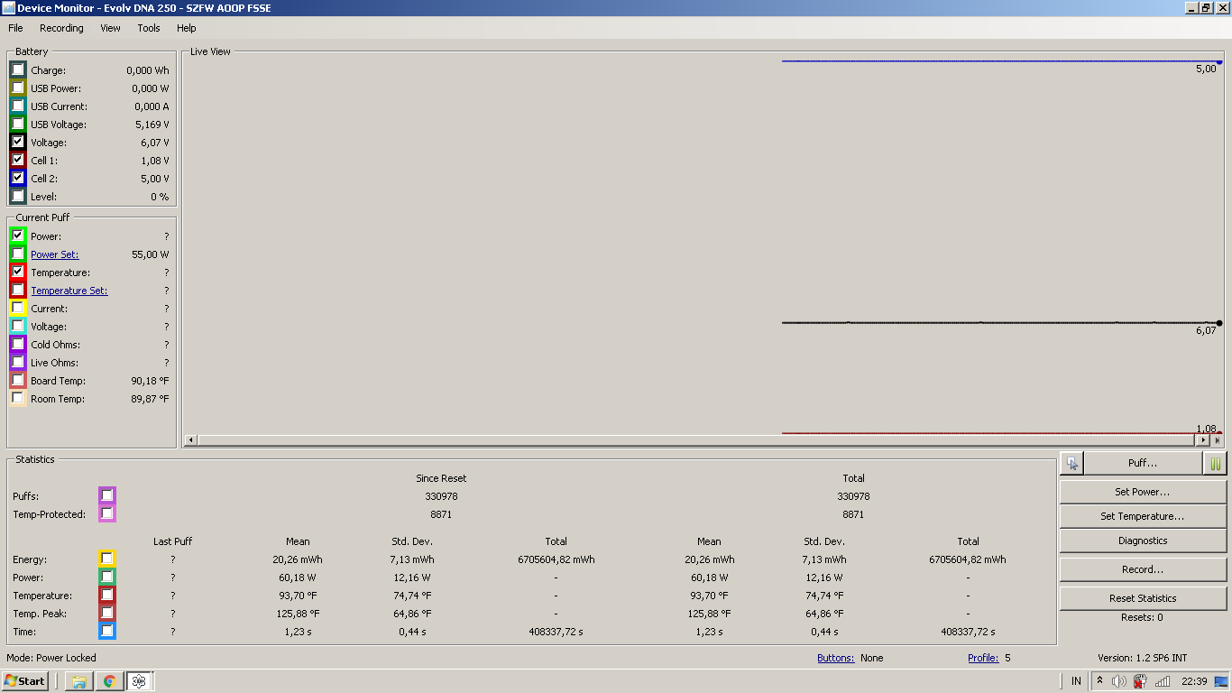

Kurora Posted August 1, 2021 Report Posted August 1, 2021 (edited) hi everyone, i just bought a therion 166 with dna 250 but the device had a empty battery indicator, i've tried restore to default the device, but i had a problem that the device wont turn on unless it had an usb power, so i put the battery setting to power supply mode, and the device can firing but the battery indicator still empty, what should i do next, is this sign of a dead chip or somthin else, some of my friend from therion dna indonesia said that this happend bcause my battery IC is dead, and i notice on device manager, the number 1 battery voltage is low not like the second 2, ive tried swap and still the same that the number 1 battery low voltage Edited August 1, 2021 by Kurora
Wayneo Posted August 1, 2021 Report Posted August 1, 2021 Yes! The seller sold you a mod with a dead/blown battery management chip and 331,000 puffs. The cheapest thing might be for you to find a local electronics repair place 1
BillW50 Posted August 1, 2021 Report Posted August 1, 2021 (edited) Your friend is right. Be careful about running in power supply mode. Since one battery could drain dangerously low in about 12 hours. I also recommend you follow @Wayneo advice. Edited August 1, 2021 by BillW50
Kurora Posted August 1, 2021 Author Report Posted August 1, 2021 6 hours ago, Wayneo said: Yes! The seller sold you a mod with a dead/blown battery management chip and 331,000 puffs. The cheapest thing might be for you to find a local electronics repair place yeah, i bought it for a cheap price for only $18 should it be normal again after repairing the battery management chip ? 6 hours ago, BillW50 said: Your friend is right. Be careful about running in power supply mode. Since one battery could drain dangerously low in about 12 hours. I also recommend you follow @Wayneo advice. yeah ill not use it for now, i tought it can only be repaired for only reset the escribe, but i was wrong, im to happy to see a dna mod sell for only $18 hahaha thanks for the advice
Wayneo Posted August 2, 2021 Report Posted August 2, 2021 43 minutes ago, Kurora said: .... should it be normal again after repairing the battery management chip ? It will fix the battery issue. If you're going through all that effort, you ought to check the entire mod components (510, battery contacts, wiring, buttons)
