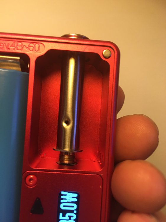

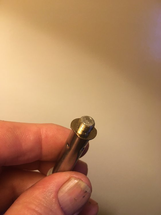

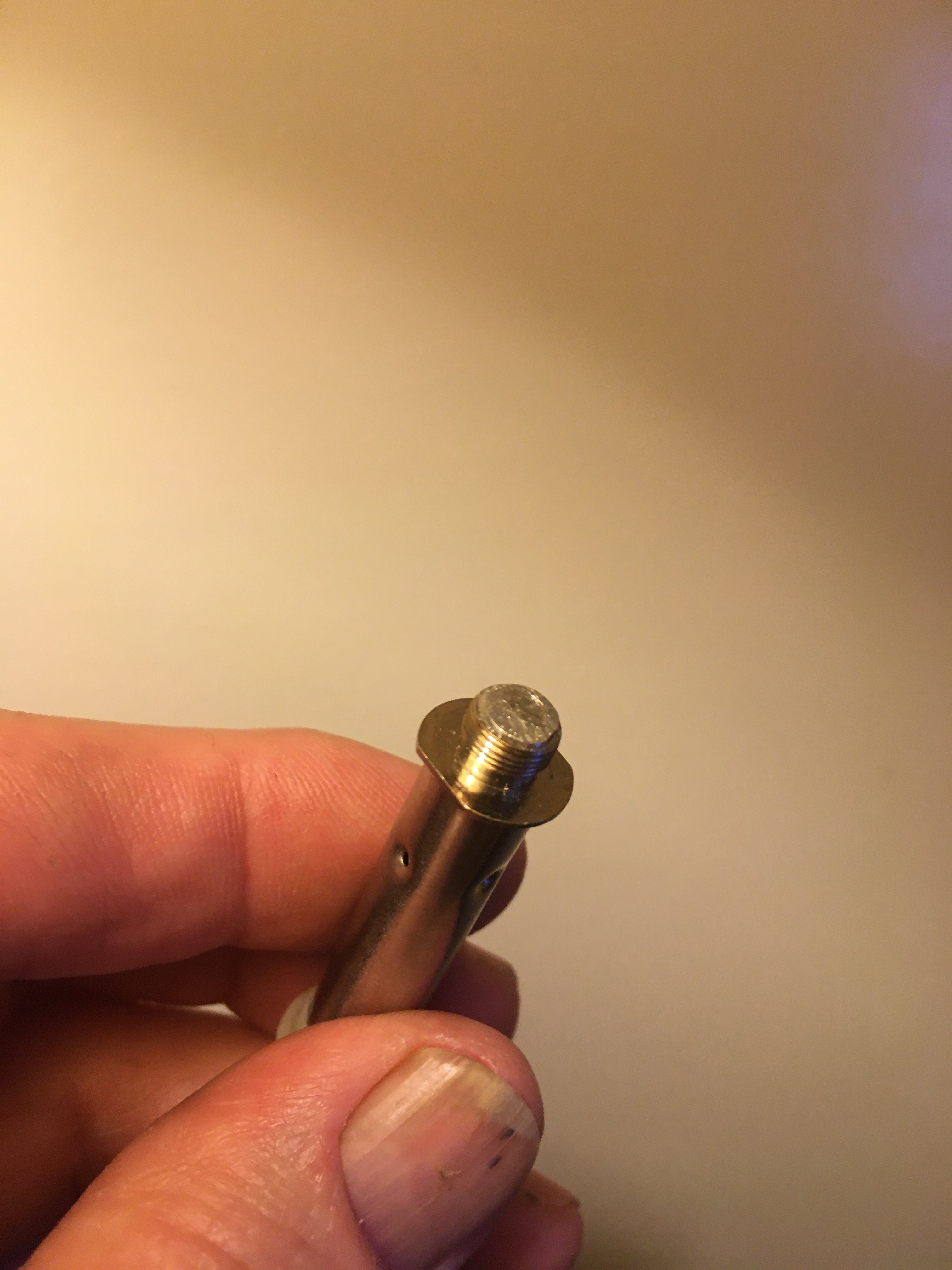

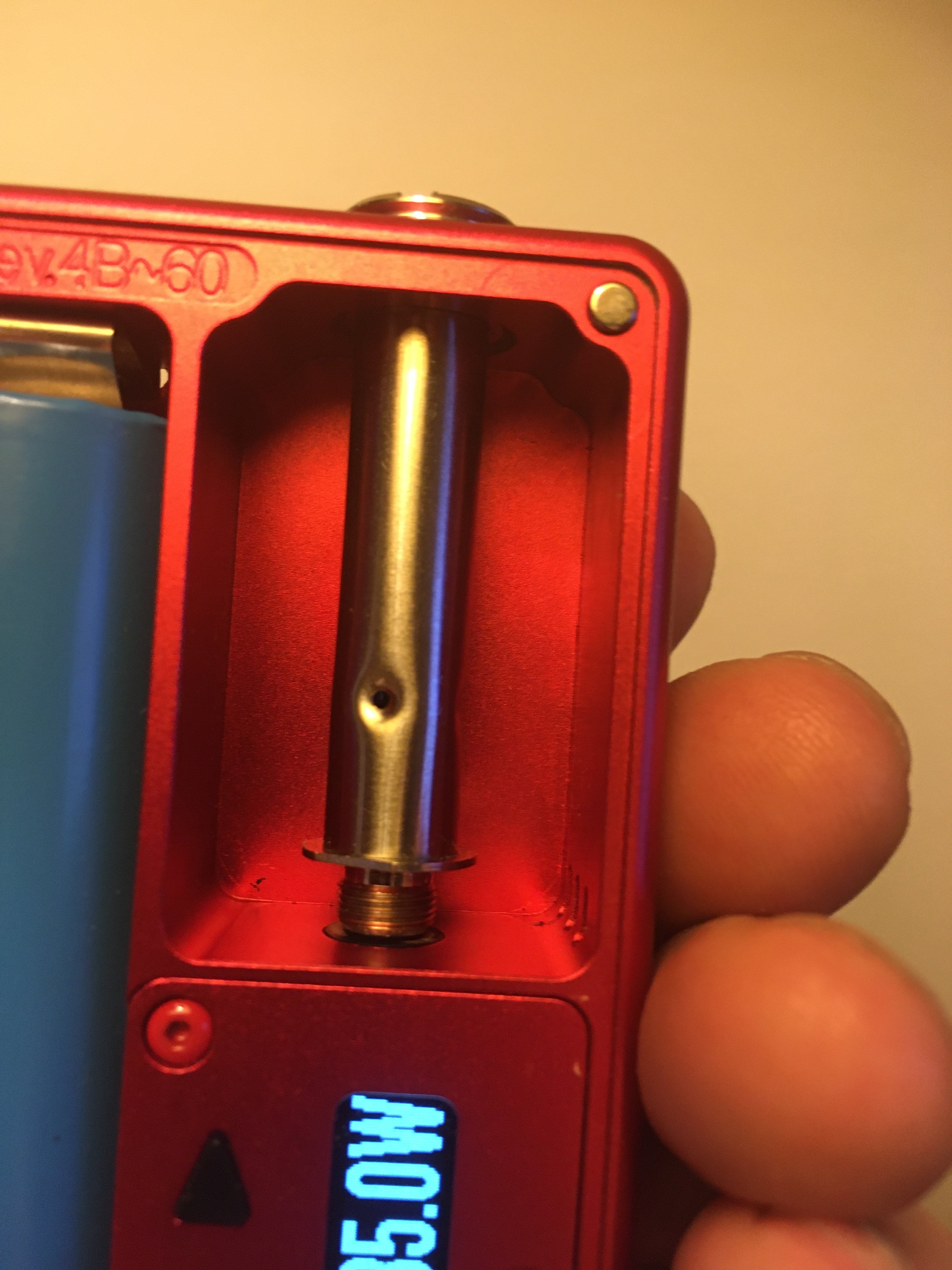

dwcraig1 Posted May 27, 2021 Report Posted May 27, 2021 For what it's worth. The mod resistance on my two SXK Billet boxes are set to 0.011 ohms. They were measured using my shorting tool. One came out to 0.010 and the other at 0.011 so I set them both at 0.011 ohms. Contact area need to be clean 1st. 1 1
