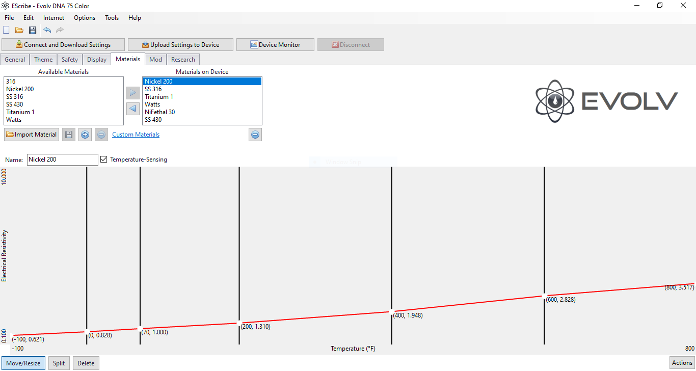

dwcraig1 Posted May 23, 2021 Report Posted May 23, 2021 Wire that changes the most resistance when heated work best. Go here to see TCR values: https://www.steam-engine.org/wirewiz Use the drop down menu to change wire type. Read the value in "TCR in Vaping Range" Note Ni200 is 6000, that would be 0.006 for the DNA TCR setting. Personally my wire of choice is SS430 which has a much greater resistance change than SS316. 2
leea12345 Posted May 23, 2021 Author Report Posted May 23, 2021 4 minutes ago, dwcraig1 said: Wire that changes the most resistance when heated work best. Go here to see TCR values: https://www.steam-engine.org/wirewiz Use the drop down menu to change wire type. Read the value in "TCR in Vaping Range" Note Ni200 is 6000, that would be 0.006 for the DNA TCR setting. Personally my wire of choice is SS430 which has a much greater resistance change than SS316. thank you as looking at 430, do i just download the csv file as i did for ss316, i get confused about the tcr , do i need to enter this as well? ,if so how , i was under impression i just added the csv file , sorry little confused with all the tcr thing

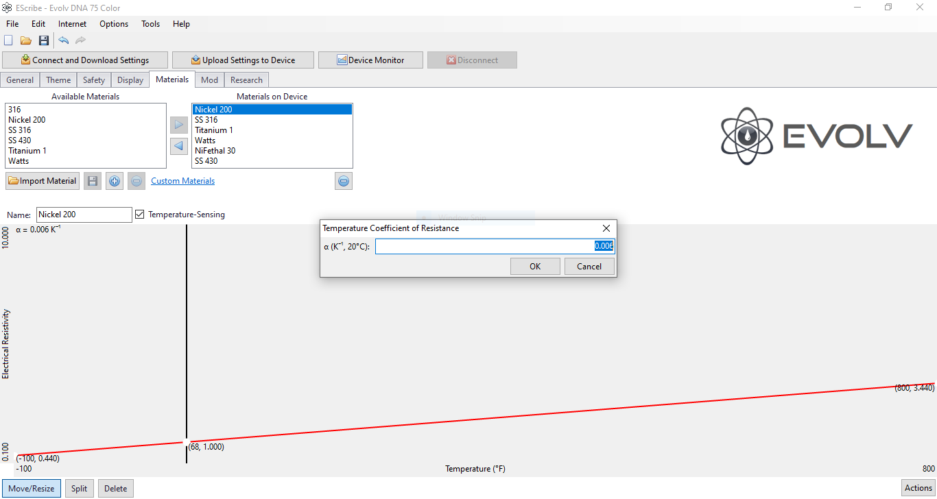

dwcraig1 Posted May 23, 2021 Report Posted May 23, 2021 Yes you can simply use the CSV file but you also can manually add it as indicated here: By using the "Action" tab in lower right corner. 1
leea12345 Posted May 23, 2021 Author Report Posted May 23, 2021 3 minutes ago, dwcraig1 said: Yes you can simply use the CSV file but you also can manually add it as indicated here: you are very kind, thank you for your time, now just got to find some in the uk to buy, does not seem a lot about , also just wish i could have got 316l working ok , spent more time playing about than vaping it , Thank you.
