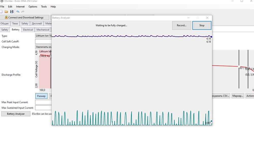

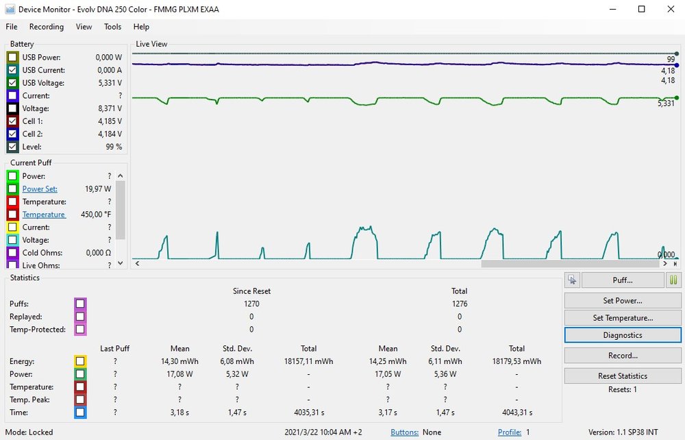

StemDeath Posted March 22, 2021 Report Posted March 22, 2021 (edited) Good day. I have such a problem, DNA-250C cannot fully charge the batteries. I want to analyse the battery, but the program writes that I would wait for a full charge. I left it to charge overnight, and it did not reach 100%. I charged the batteries in an external charger, the device says it is 100% charged. EScribe doesn't want to run the battery test anyway. Batteries 2 cells (Sony vtc6) have been in use for about a year. Edited March 22, 2021 by StemDeath

Wayneo Posted March 22, 2021 Report Posted March 22, 2021 In looking at your screenshot, notice up at the top it shows both batteries at 4.18V Right now that's what battery analyzer believes to be 100%. You could (in the screen behind it) move that far left value down to 4.18 as being 100% so some light or theme message appears. Totally off topic, and not related to this, you could also upgrade your version of escribe. Link in my signature. 2

retird Posted March 23, 2021 Report Posted March 23, 2021 I find that some 250C can be a bit finicky to reach 100%. I have one that will reach 99% and will just trickle charge for a long, long time but eventually will get to 100% and the LED will turn green. With the CVS for the batteries I don't worry about only getting 99%. Doesn't effect the battery usage... I also have other DNA devices that do the same with single batteries... 2
dwcraig1 Posted March 23, 2021 Report Posted March 23, 2021 I have only one DNA250C and it does the same thing as in Retird's post.
