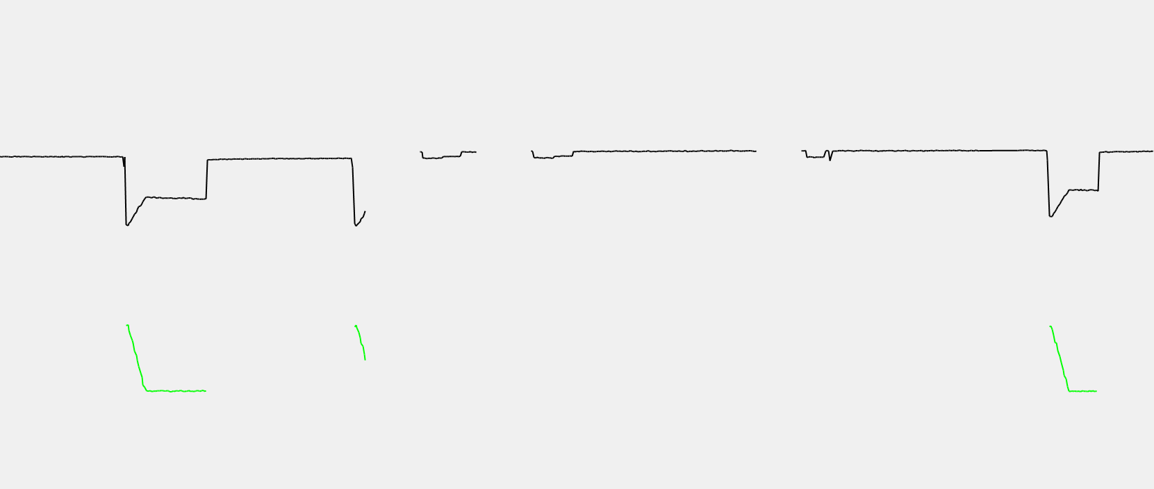

Edwin1967 Posted July 22, 2020 Author Report Posted July 22, 2020 This is what it looks like in Escribe:
Edwin1967 Posted July 22, 2020 Author Report Posted July 22, 2020 The openings in the curve show when it misfires and resets.

Wayneo Posted November 30, 2021 Report Posted November 30, 2021 I guess you could start with a full screenshot and post it here. In Device MonitorView - set time scale to 60 Enable/click volts Wait a minute then do the screenshot. Do you remember having any leaks, or was this the behavior from new? Does it happen with all atty's?

Edwin1967 Posted December 1, 2021 Author Report Posted December 1, 2021 Thanks for sharing, but this is the Vt75D, so with 2 18650 batteries. I will try to create the device monitor screenshot in the weekend, hopefully someone will have an idea, for I love the size format of this mod.
