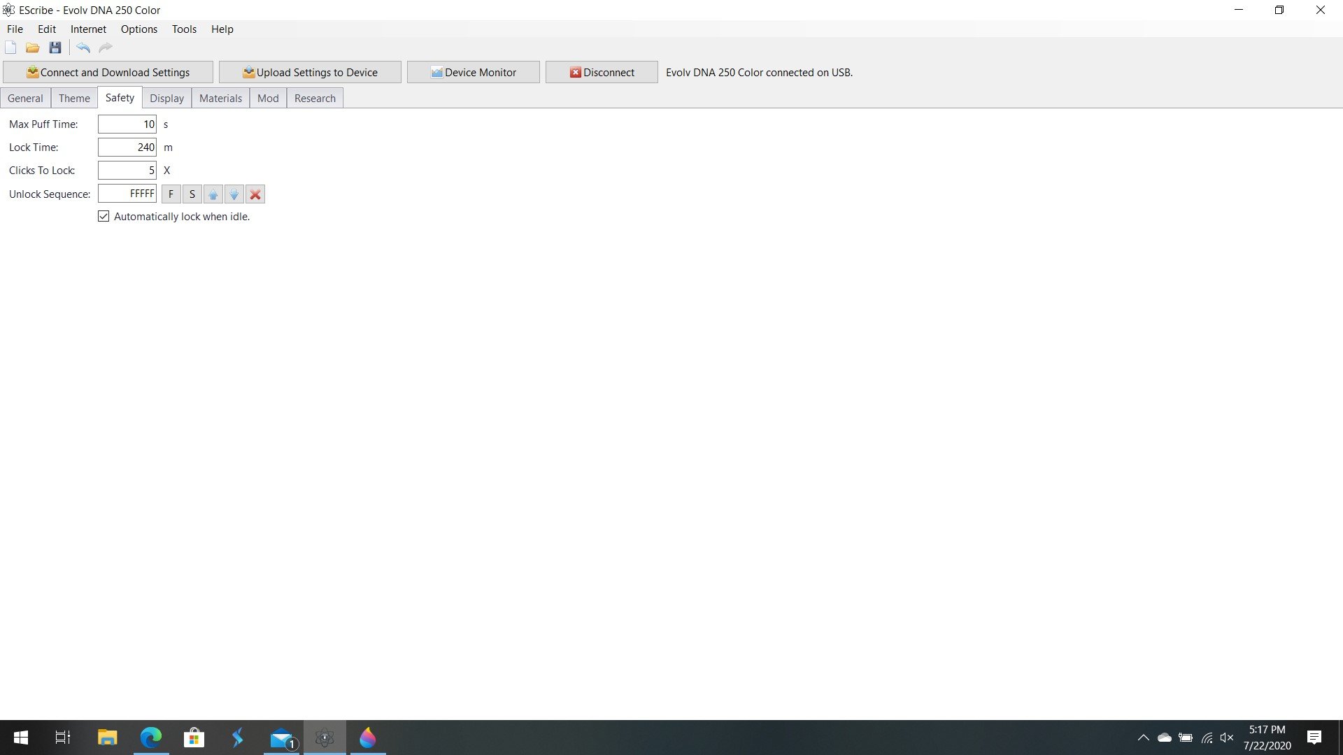

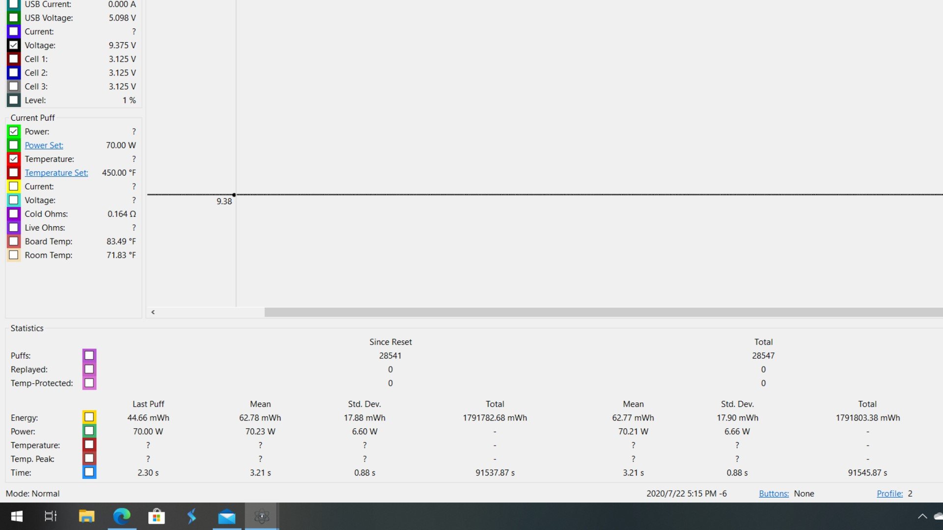

From within Escribe ....... Can you post a 'Device Monitor' and a Mod - Safety tab printscreen
And which vapestation are you using and who built it
I'll post it when I get home this afternoon.
Analog box mod station and mod (built by them did not get the DIY kit)
http://analogboxmods.ca/Custom-Built-Box-Mods
The Xbox power box option on the work station  and a previously offered 250c chip in the mod (they are no longer offering it for some reason)

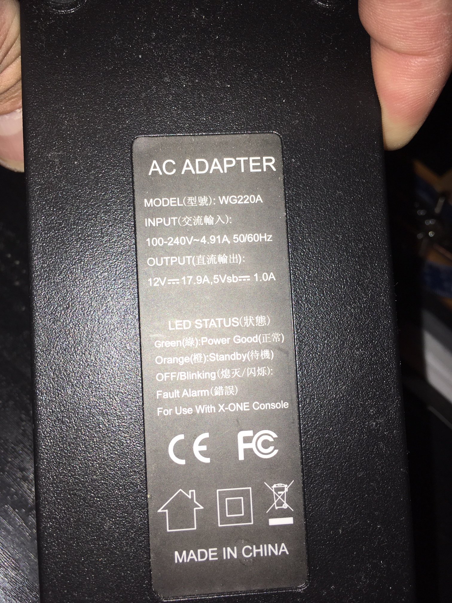

You said this is a pass thru mod (no batteries in the mod).  Is the battery selection in EScribe set to "power supply" 12 Volts.  Your power supply is 12 volts, right?

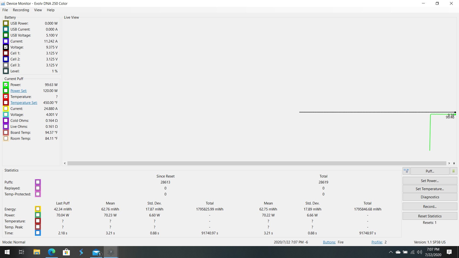

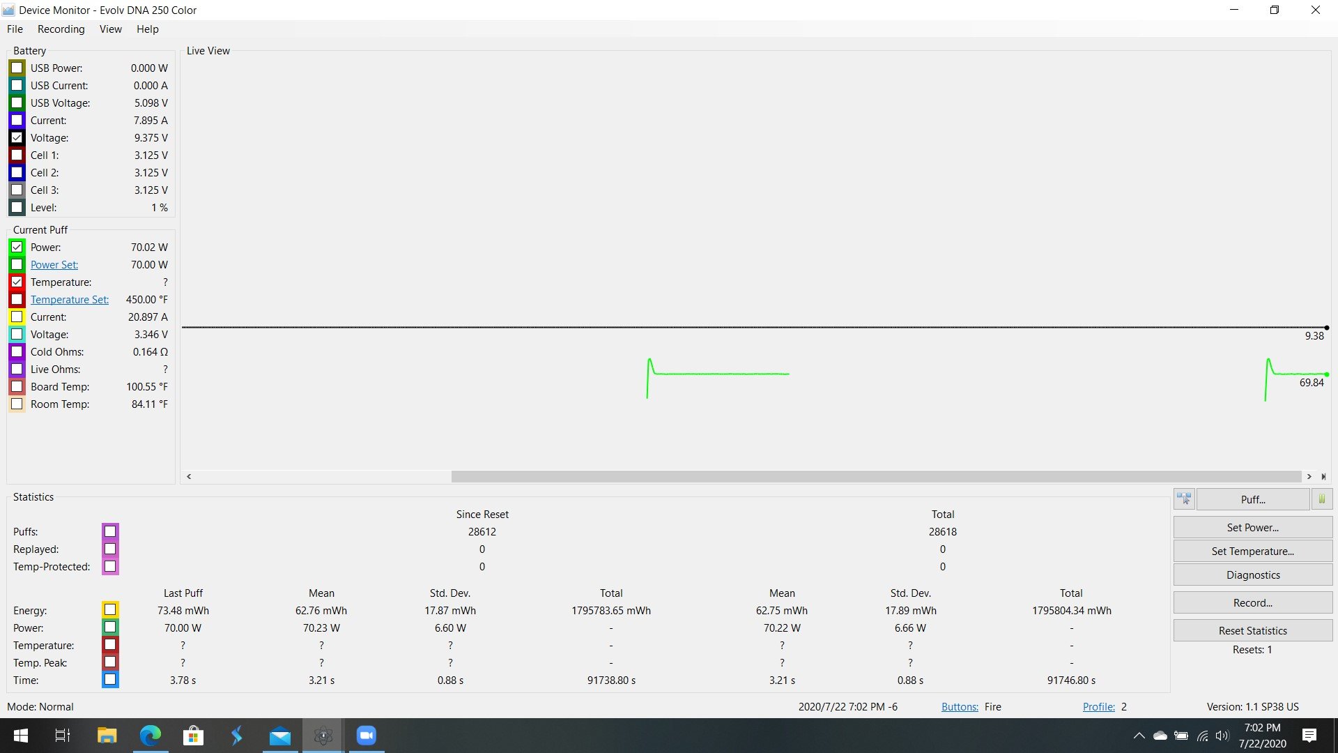

Measured voltage at the PSU at 9.3v and the manufacturer is saying it should be 12v so  I am waiting on them to see how we are going to move forward.
  • Like 1
Posted
Surely they will guide you to a  PSU that will make the  250C  hum................
