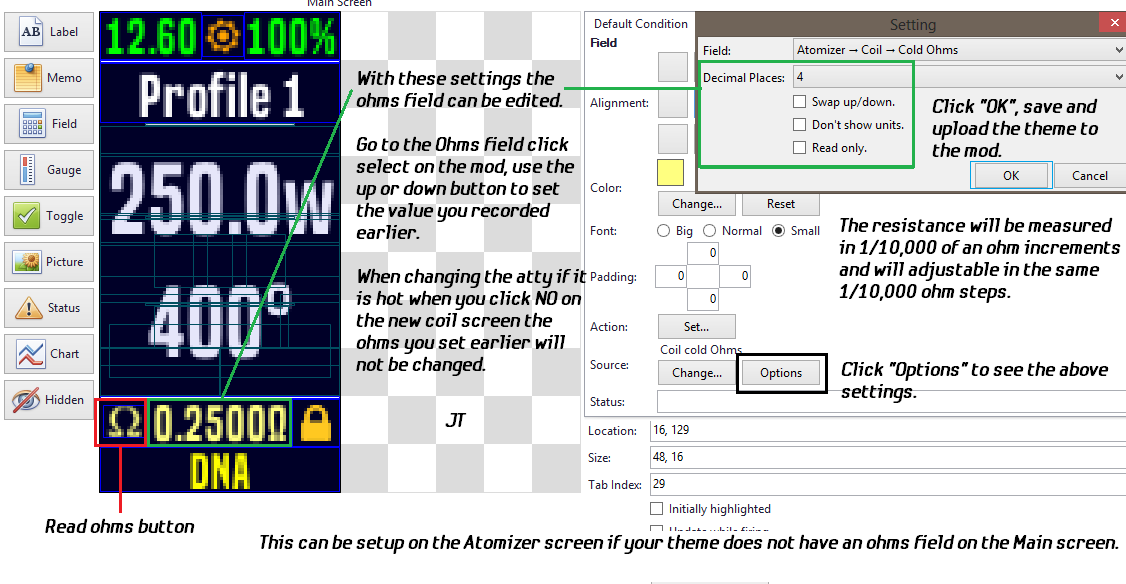

Jetro Posted April 4, 2020 Report Posted April 4, 2020 (edited) Tub Thumper, If I remember correctly the board reads the ohms to five decimal places. It is very important to use the 1/10,000 setting when editing the ohms. At the default 1/100s the ohms could be 10 to 20% off from the actual resistance if the coil is below .15 ohm. Measuring and setting the ohms in this fine of scale should help in evaluating the different tcr/tfr settings. This is the default Evolv theme with the read ohms button and ohms editing field. I replaced the upper ohms field with the battery voltage. I also made the Atomizer screen ohms field read only. Download the theme and have fun!! JT About the tcr/tfr's I use the Steam Engine version. I feel that the default 316 profile vapes too cold. The temperature setting for the stock 316 profile was 20 to 30 degres higher for me than the Steam Engine profile. Hope this helps, JT 250c default with ms ohms.ecigtheme Edited April 4, 2020 by Jetro added info, brain dead
TubThumper Posted April 4, 2020 Author Report Posted April 4, 2020 19 minutes ago, Jetro said: Tub Thumper, If I remember correctly the board reads the ohms to five decimal places. It is very important to use the 1/10,000 setting when editing the ohms. At the default 1/100s the ohms could be 10 to 20% off from the actual resistance if the coil is below .15 ohm. Measuring and setting the ohms in this fine of scale should help in evaluating the different tcr/tfr settings. This is the default Evolv theme with the read ohms button and ohms editing field. I replaced the upper ohms field with the battery voltage. I also made the Atomizer screen ohms field read only. Download the theme and have fun!! JT About the tcr/tfr's I use the Steam Engine version. I feel that the default 316 profile vapes too cold. The temperature setting for the stock 316 profile was 20 to 30 degres higher for me than the Steam Engine profile. Hope this helps, JT 250c default with ms ohms.ecigtheme Many thanks Jetro! Its a shame there is no option to avoid the resampling of the resistance, but once I find the right TFR for me it should no longer be an annoyance for me. I cant say I have tested the Steam Engine version too much as yet, but I will be sure to do so when time allows. Like yourself, I see many using and recommending it! I will also be sure to ditch the stock theme and check out the one you have provided. I wasnt planning to delve too much into themes until I had the profiles configured to my liking, but it sounds like there could be some valuable information and functionality Im currently missing out on, that could be making things easier. Thanks again!

Jetro Posted April 4, 2020 Report Posted April 4, 2020 (edited) I forgot to mention, When using the measure button. Do it once for the most accurate reading. Each time you read the ohms the mod sends a tiny amount of current to the atty to make the measurement. If the button is selected over and over the resistance reading will rise as the measuring current heats the coil. JT To add to this it can be dangerous to edit the resistance without a good reason. T/C Depends on the correct resistance to be measured and set. Inputting the wrong values high or low will cause the temperature of the coil to be VERY different than what is set on the mods screen. Inputting a KNOWN resistance value is not a problem in the least. Butt changing the resistance to make it vape better is in my opinion is not a very smart thing to do. Edited April 4, 2020 by Jetro
