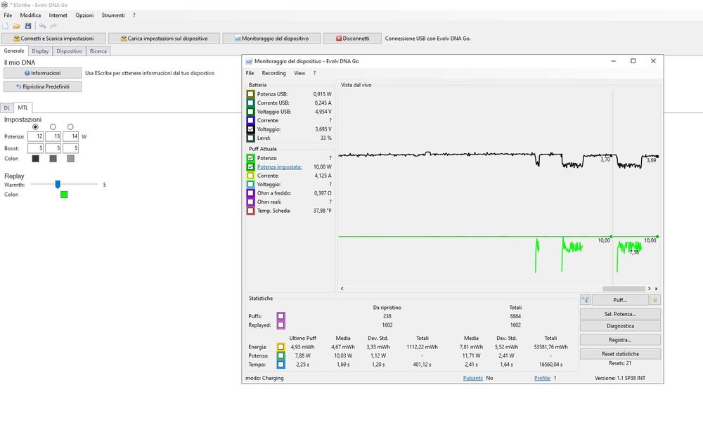

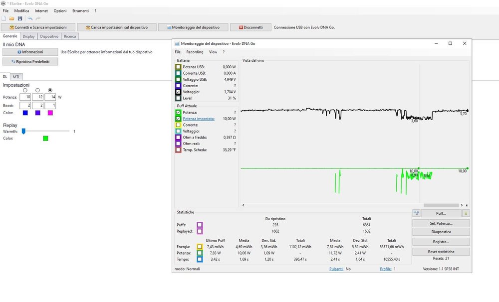

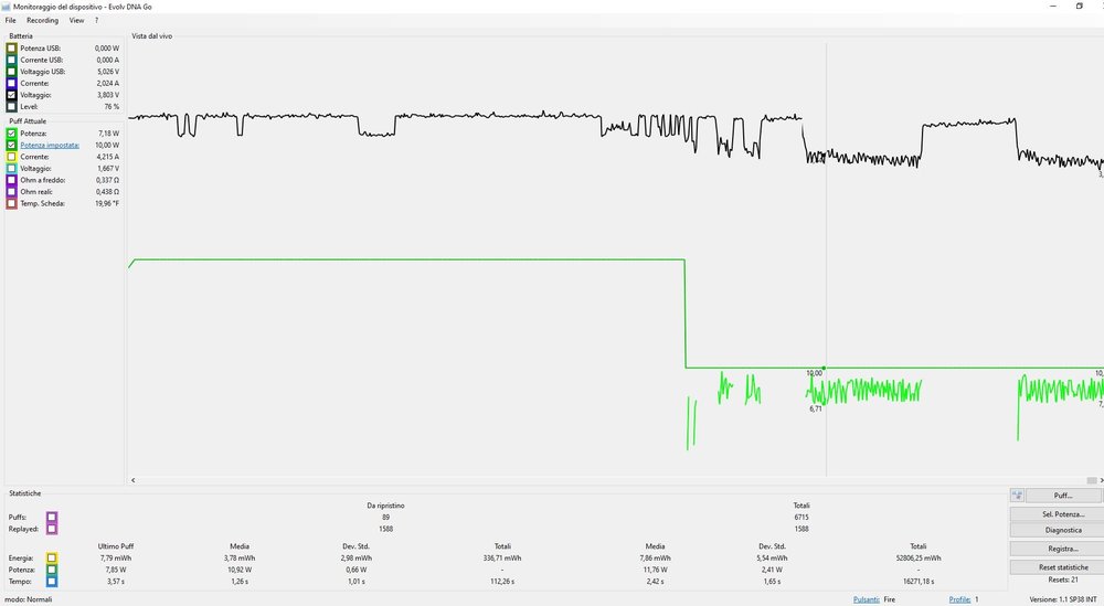

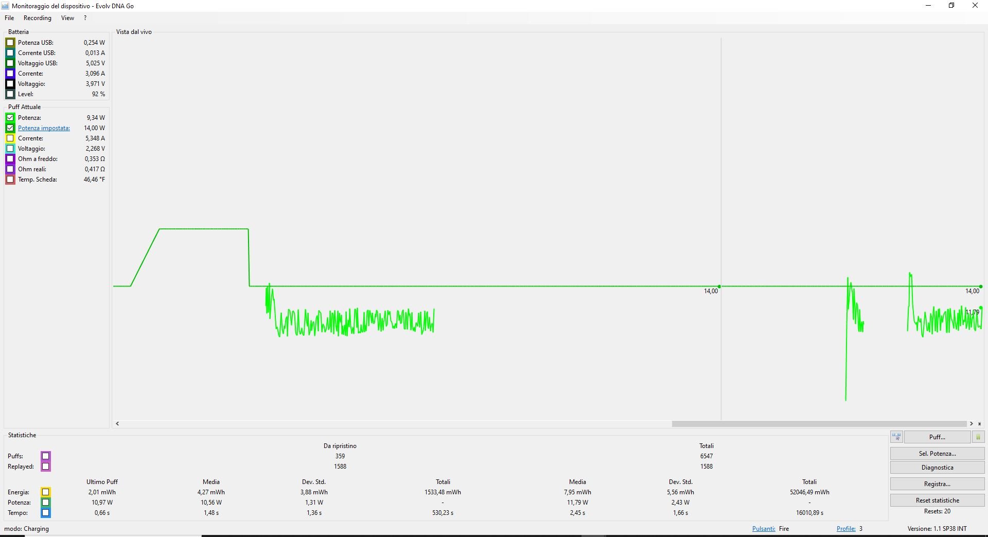

The problem is that I am experiencing an output power output, very unstable and well below what it should be according to the law of ohms, let's say that the power set is different from the output at least 4-5 watts on average , this applies to all values that I set, for example if I set 11 watts at the output, the power actually delivered will be 8 watts ...
Also you can see that the two green lines in the device manager are not even parallel with such a low power, but that of the output power fluctuates very much in frequency, as if it were a sort of activated tc.In my case, there is no tc on the dna go, but the replay function that I have deactivated. if I activate the replay the output power oscillates even more.I tried to contact the modder who builds my Box and said that according to him 99% are one of the cables of the cup of the pin 510 loose, but I checked well, and they are not loose at all.

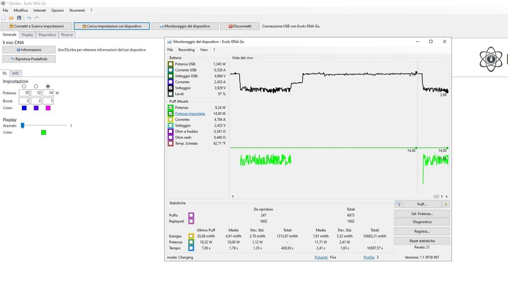

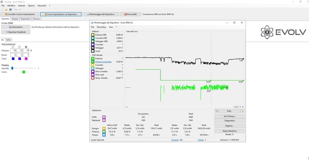

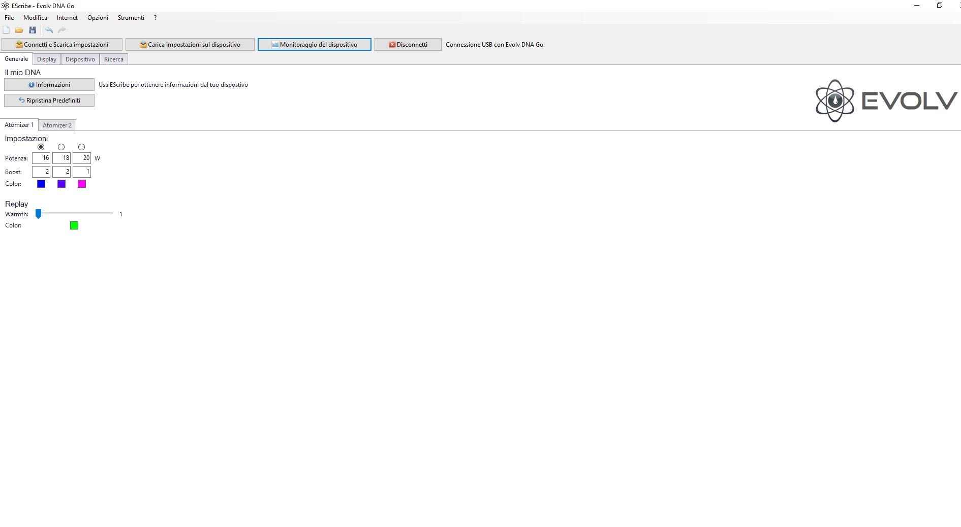

Hi retrid

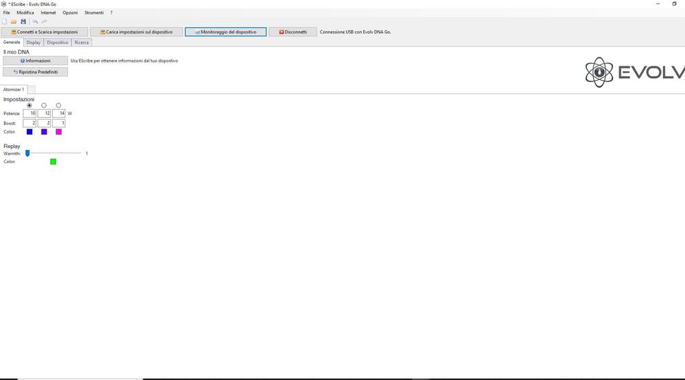

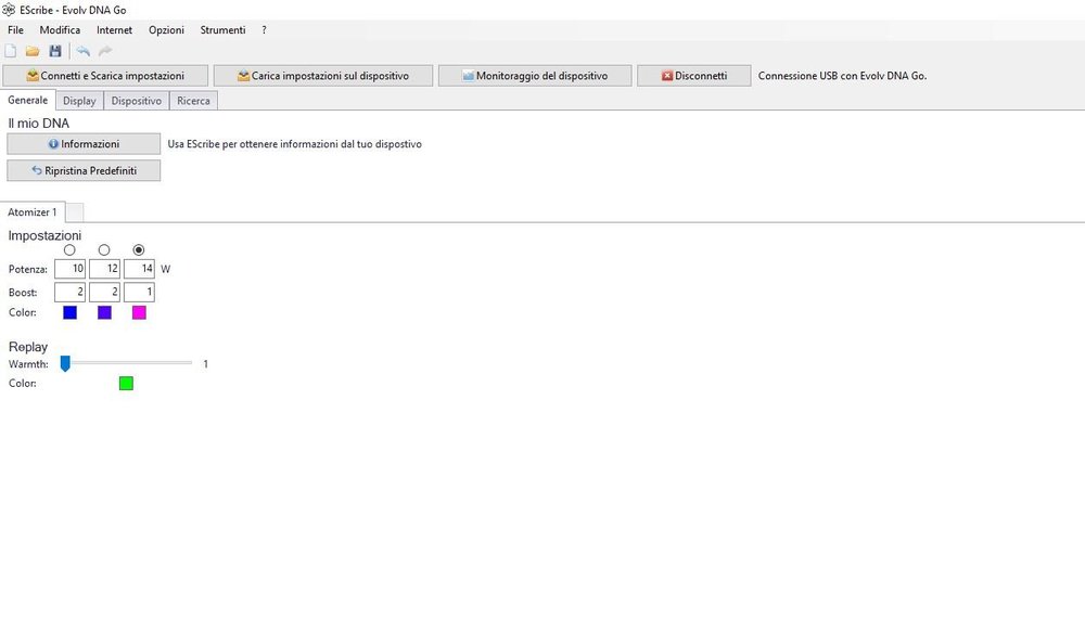

The replay is disabled, also you can only activate it by pressing the button on the Mod and not in the software, it is the first thing that I have ascertained,

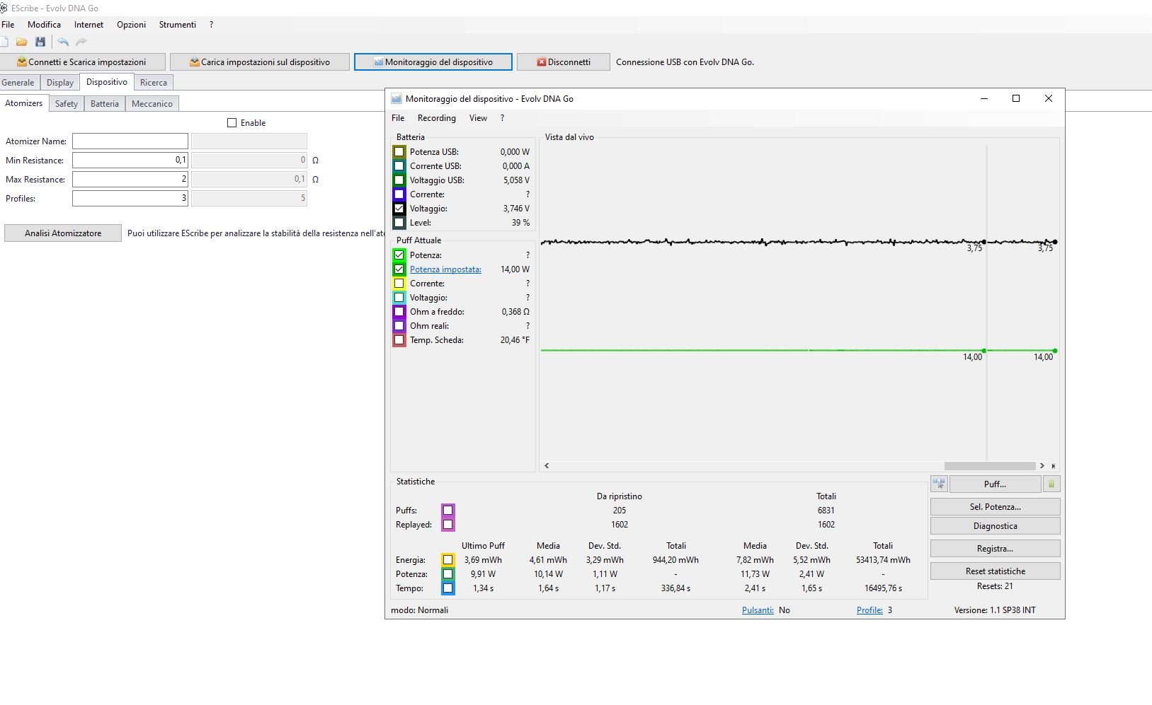

I put 4 attachments so you can see other settings too. you also see that I have also changed the watt setting, I even lowered it with 3 new values, but in the graph, I can barely reach 70% of the watt value I set See the volts as they go down to the Puff box.
Pino

In your 1st printscreen, 14 watts set, 11 watts average delivered.
In your 2nd printscreen post, 10 watts, 8 watts average delivered.

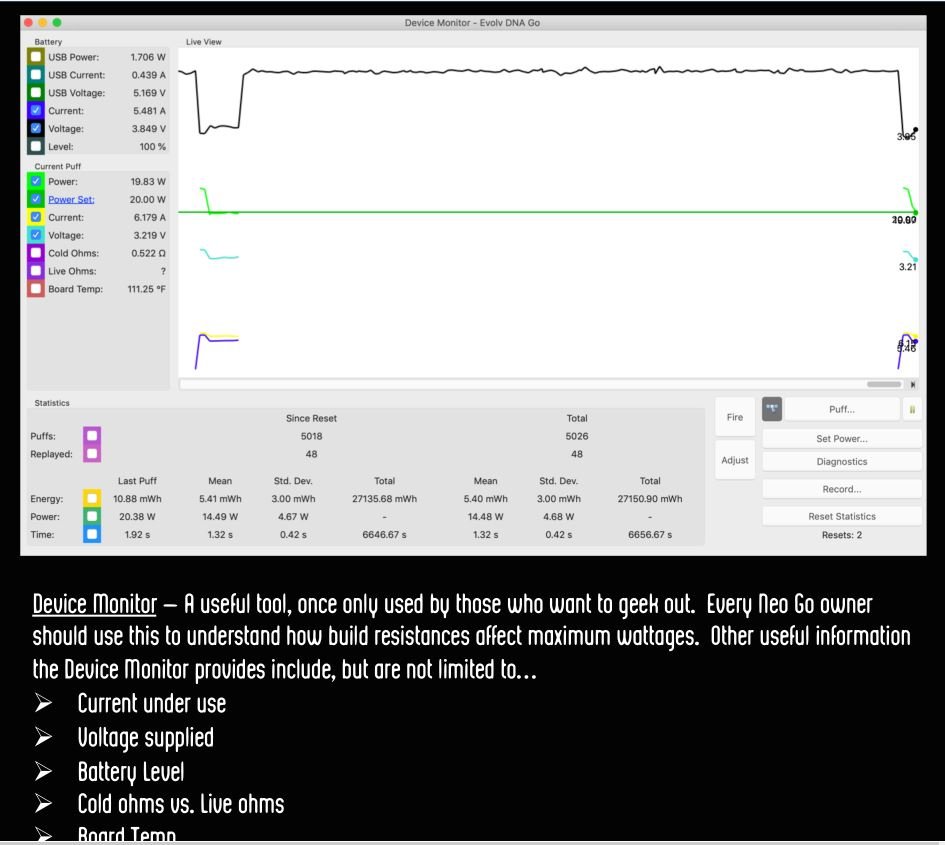

I bought the Box a week ago, I let you imagine if it has no guarantee, it would be absurd! the Modder, Sixstyseven Vapor has washed his hands, because the pod seems to be built in CHINA by STIMYVAPOUR. Another important thing, the modder did not customize the mod in any way with software modifications, it came with all default settings, also in the OFFICIAL instructions of my Mod, it is clearly evident in a screen of their manual that the two green lines of the powers they are also parallel to 20 watts, mine not even to 10 watts. I insert screen of the manual of the Mod.

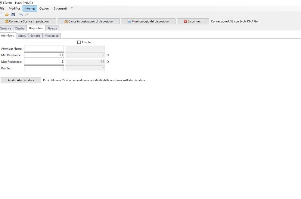

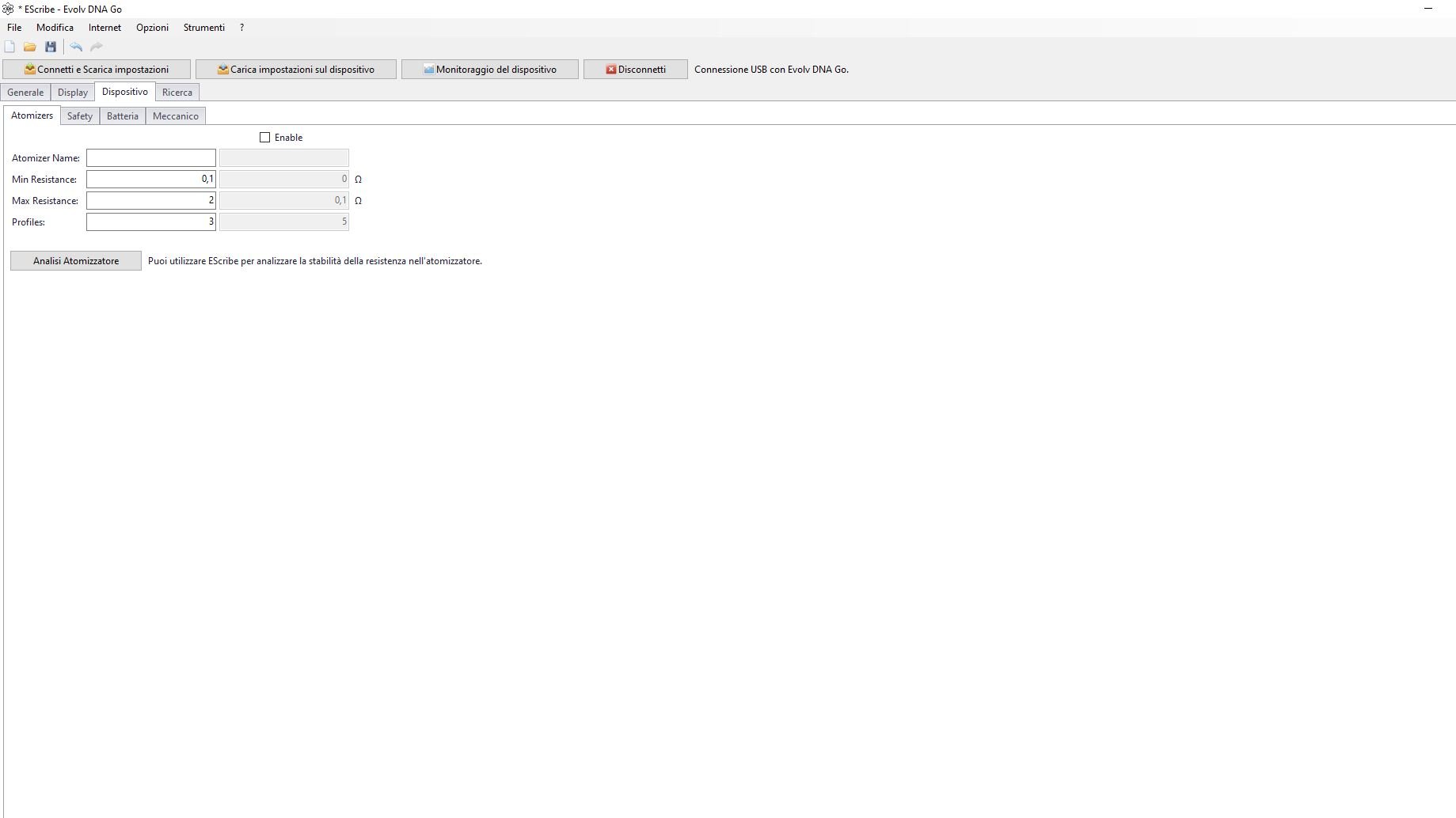

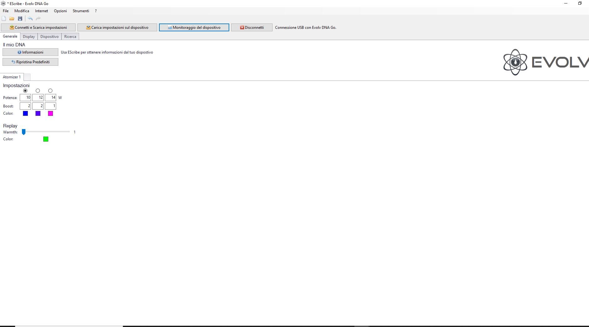

i have disabled atomizer profile, i use default setting in atomizer tab,
I tried to use the profile values those of the manual 0.50 mtl, and 0.25 dl but it changes little, the box is always irregular. then I disabled the dl and mtl profiles, and I always use the profile with a single atomizer.

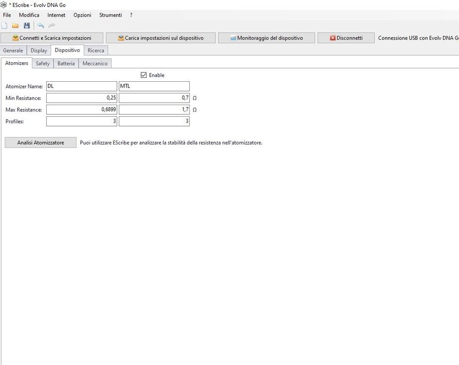

Give a screenshot of Atomizer2  profiles. Screenshots are with the device connected to EScribe.

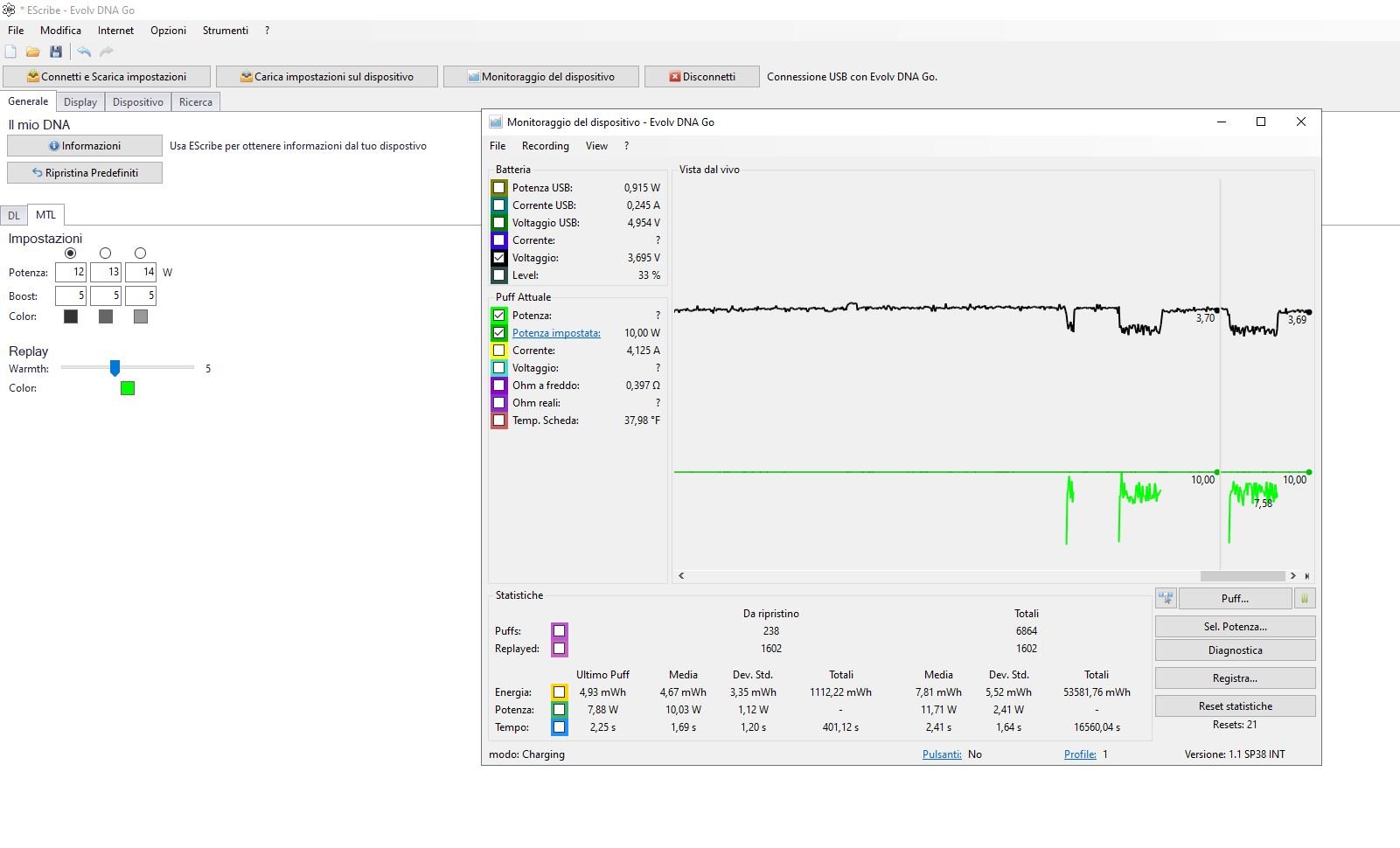

Do you see in the General Tab the Settings screen for choice between "DL'"and "MTL" now?  Connect device and screen shot DL profiles and then screenshot MTL profiles.
Posted (edited)
if I don't enable atomizer profiles, in the general tab I see just one tabs  that by default atomizer 1 which corresponds to profile 3. now I enable them and let you know
Edited by Pino74
Posted (edited)

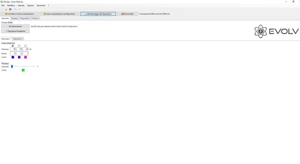

But I noticed a strange behavior, when I change the profile, in the general tab between mtl and dl, the colors on the mod button always remain those of the Dl profile, maybe there will be some mess in the profiles?
and then the power of the profile does not match with the power in the device manager .... I don't understand why ...
