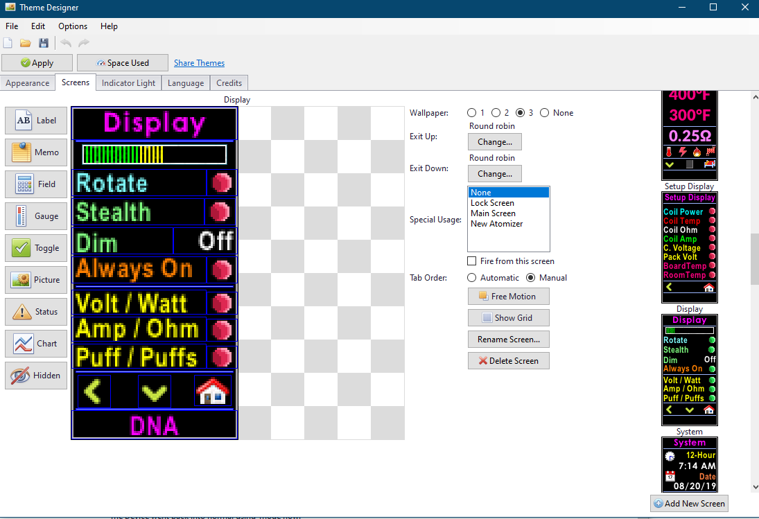

I thought that article was probably not correct.  There is a stealth mode in the Theme I use with my 250C devices.  Here is a screenshot of one screen in Theme Designer.   So with the 250C you turn Stealth on and off from the menu. I think Stealth only works when firing the device as you need to see the screen to use the theme.  Here is another part of a reddit post I see:   Although they do have a lock. But the screen will light up in either case. There is a stealth mode, but it is only stealth when you fire it and not in the menu system.

I am not versed in designing Themes but if possible  and if the functions you want are available for a theme they would need to be designed into the Theme.  You might look at the design of your theme and see if Stealth is already there.
There are numerous Themes in the Downloads part of this forum where you can look at the screens and functions and choose the Theme you want.   I recommend you save your current theme before changing to another in case you want to go back to Lost Vape Theme.  Here is the link for 75C and 250C Themes:    https://forum.evolvapor.com/files/category/6-dna-75-color-250-color/

@mexus Try a few different themes, and you'll find one that mostly fits with what you like. Use Theme Designer with that theme and others to see 'how' they did it. The 'Main Screen' is really the heart or 'meat and potatoes' of any theme. Many will take the theme they like and customize it further to match their needs, and give credit to the original designer if they decide to publish it here.
