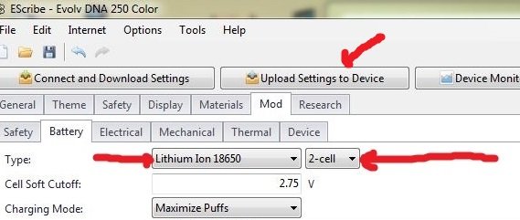

To reset device with Escribe go to: Tools/Diagnostics/Reboot Device/Click on your choice of soft or hard reboot
If you don't have the reset choices go to Options/User Interface and set it to Manufacturer and you should then have reset ability.

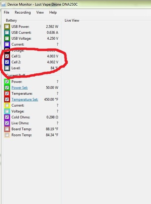

I checked before and it was already 3 cell and all 3 show 0.00V.
hard reboot didn't fix.
I'm suing Samsung pink 30Qs almost new, they work fine in Hcigar VT250s dna200. Only other battery I have is single 18650 for DNA75 MOD.

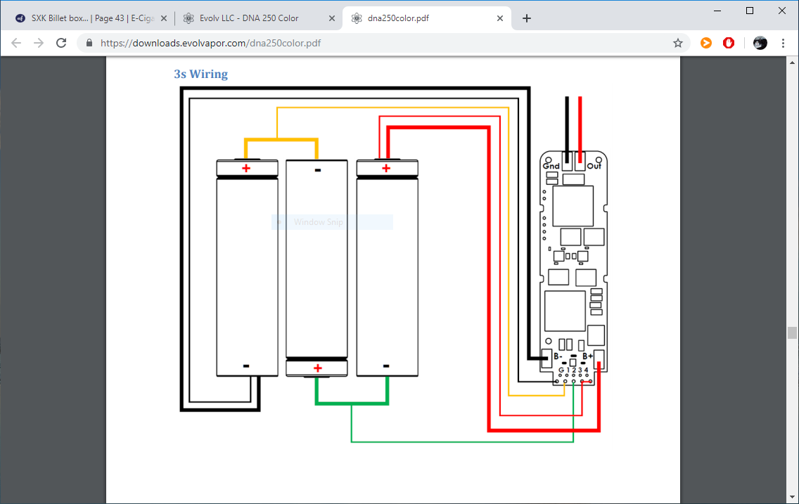

I don't know if they used a JST plug to attach the battery sled to the balance tap on board or not but most likely they soldered the wires on. It looks as if the battery tap is not connected. If you are unable to check this yourself I suggest you start a ticket with Evolv rather than sending it back to China.

I opened it and it was a PITA to open BTW, uses the smallest hex/star screws of about 9 mods I've owned and I do own a set of like 30 different mini bit heads but had to file down a flat head to fit, anyway, it seemed all connected together, I didn't remove the board from the mounting and totally disassemble it, I just checked the solder joints all seemed good.
