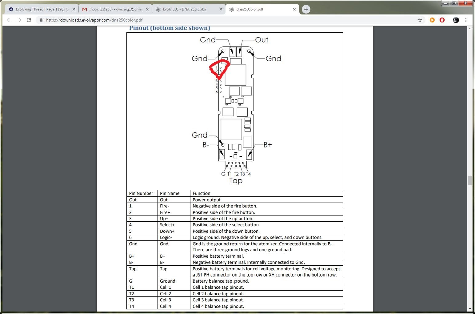

dwcraig1 Posted August 1, 2019 Report Posted August 1, 2019 https://downloads.evolvapor.com/dna250color.pdf I have no idea about lights, perhaps someone will chime in. The battery tap configurations are in the data sheet. I solder bridge mine right on the board......or you can wire it. Generally the boards are the same, there are some exceptions like Vaporshark and others that remove parts of the buttons or add daughter boards. 2 x2xxxx is same as 2 18650's, you may want to change the discharge profile but that should not be necessary. Which of your mods is the donor? I'm guessing the Vapecige squonk, the board from mine is in another mod.
