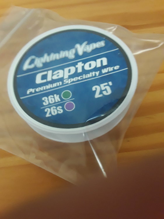

Tj Roberts Posted June 4, 2019 Report Posted June 4, 2019 Does anyone know why this wire will not work in replay mode on my paranormal 250c the inner core is ss316l outer core is kanthal

jinx'd Posted June 4, 2019 Report Posted June 4, 2019 perhaps because the kanthal is what is "touching" the contacts ? idk, just say'n. but sounds reasonable.
Wayneo Posted June 4, 2019 Report Posted June 4, 2019 Moderator Edit: Your duplicate posts were merged. Does the theme you're using support Replay? Is your mod in a Profile that supports Replay?
Wayneo Posted June 4, 2019 Report Posted June 4, 2019 Follow from the 2nd paragraph in this post from @dwcraig. Up earlier in that post is how you can check, but if it's still not working ............. Post a printscreen of Device Monitor showing the live/cold ohm boxes ticked.

dwcraig1 Posted June 19, 2019 Report Posted June 19, 2019 Replay will work with Kanthal or Nichrome coils only when there are numerous poor connections between the board and coil resulting in a resistance change due to voltage loss between the parts. Only TC wire is supported with Replay, Nichrome and Kanthal are not. 1 1
zark Posted June 19, 2019 Report Posted June 19, 2019 26 минут назад, dwcraig1 сказал: Воспроизведение будет работать с катушками Kanthal или Nichrome только тогда, когда между платой и катушкой имеется множество плохих соединений, что приводит к изменению сопротивления из-за потери напряжения между частями. Replay поддерживает только провод TC, а Nichrome и Kanthal - нет. Это абсолютно правильное мнение. Для того чтобы не продолжать дискуссию ни о чем, нужно понять, что Replay работает на принципах TC, по этому для проверки катушки попробуйте использовать её в режиме TC. Если катушка будет уверенно работать в TC, значит и режим Replay будет доступен. 1
