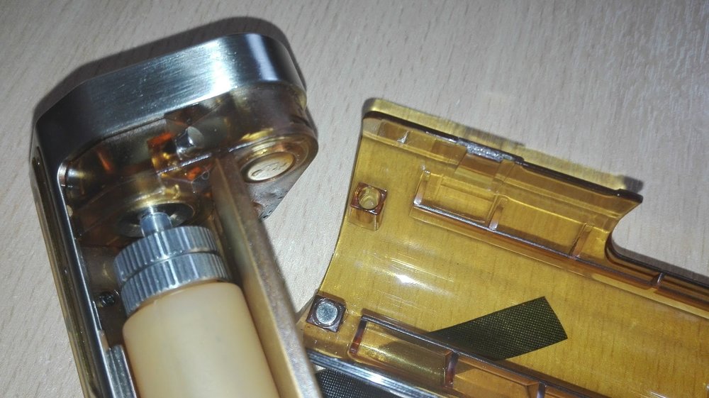

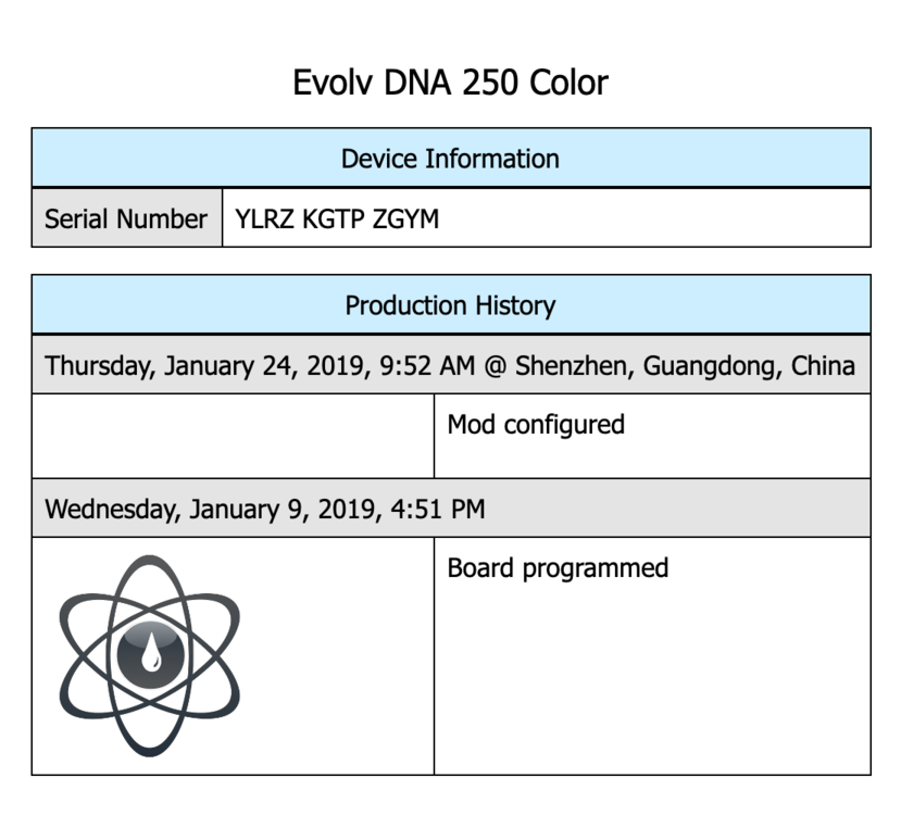

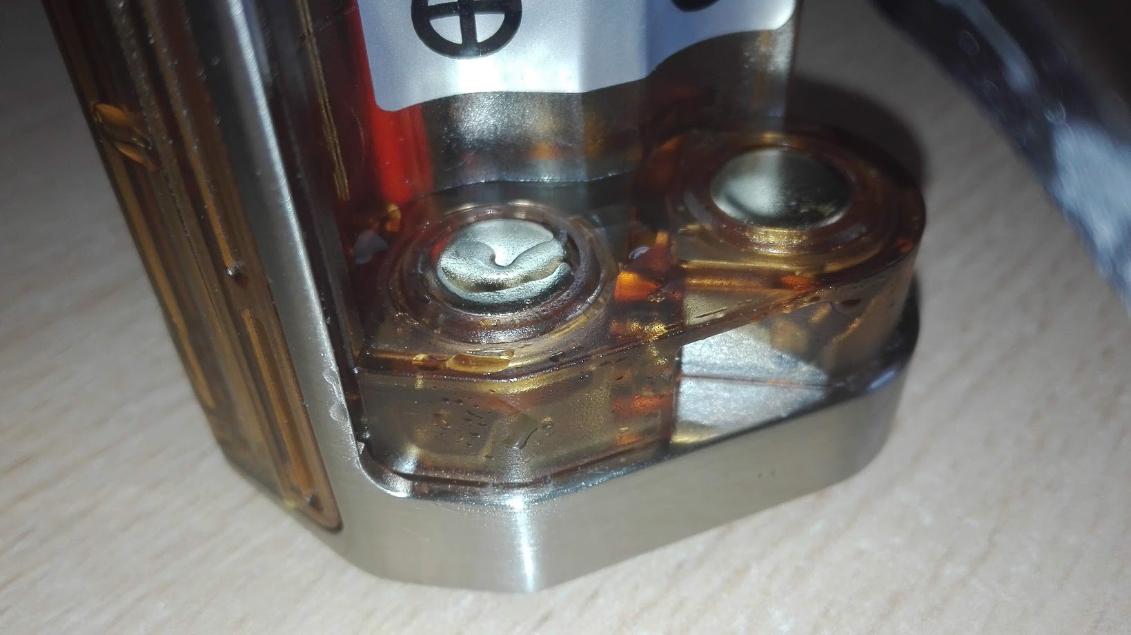

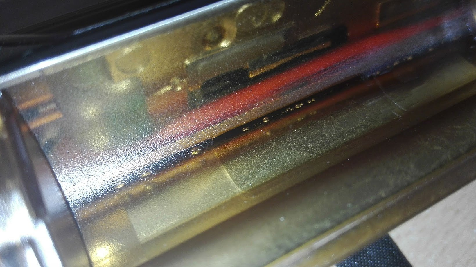

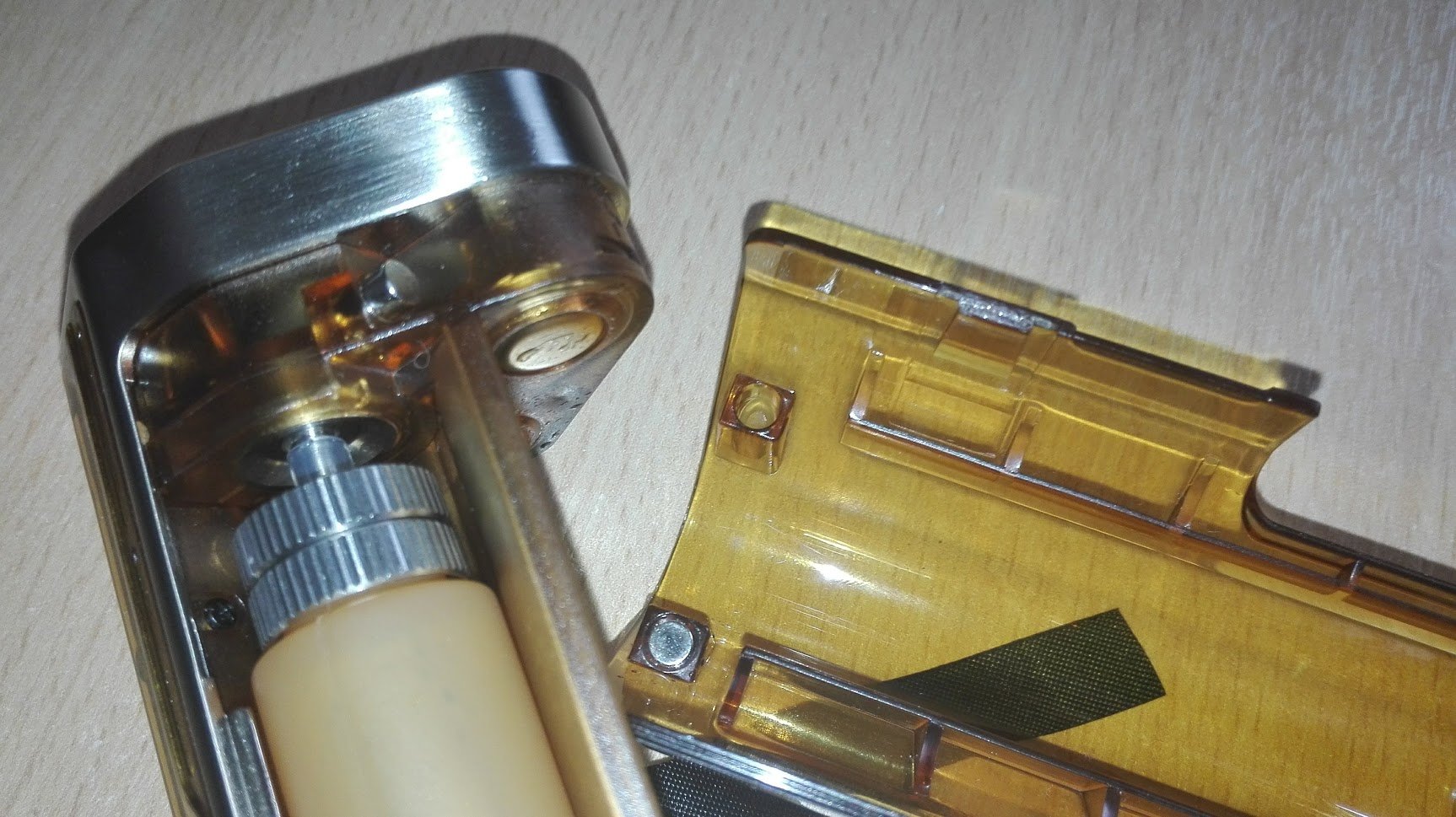

etab75 Posted May 3, 2019 Report Posted May 3, 2019 Got a Drone the other day, probably should have googled "drone issues" prior to purchase, but I've had squonkers before and they all leak to some extent. Oh boy, this thing takes leaking to a whole new level. Briefly tested, barely a bottle (7ml) before the leaking became apparent. See pics. There is literally liquid coming through from underneath the 510 angle connector and dripping into the positive terminals straight into 2 brand new Sony batteries (now full of liquid) and bubbles of liquid through the centre of the mod and coming out of the bottom lol The tubes are secure its the 510 when an atty is screwed on. One door magnet fell of on day one and the overall feel is flimsy. The DNA250C chip is fantastic, big thumbs up there, but unfortunately this mod cannot be used, its not safe in my opinion. One more interesting thing was when hooked up to escribe, it said the stats had been reset once (?). I've never had a "new" DNA mod that the statistics had been reset before, always says "0". Not saying its used, looked mint, shrunk wrapped, the mod in selothane, no juice residue anywhere, just struck me as odd. I never reset my mods. Pretty gutted about this experience, love DNA chips but there are so many poorly made devices out there. 1
Wayneo Posted May 3, 2019 Report Posted May 3, 2019 All of my LV C chips have come with around 6 puffs and 1 reset.
etab75 Posted May 3, 2019 Author Report Posted May 3, 2019 Cheers Wayneo, just never had it before, no doubt some testing... Lost Vape probably should start doing a leak test as well lol

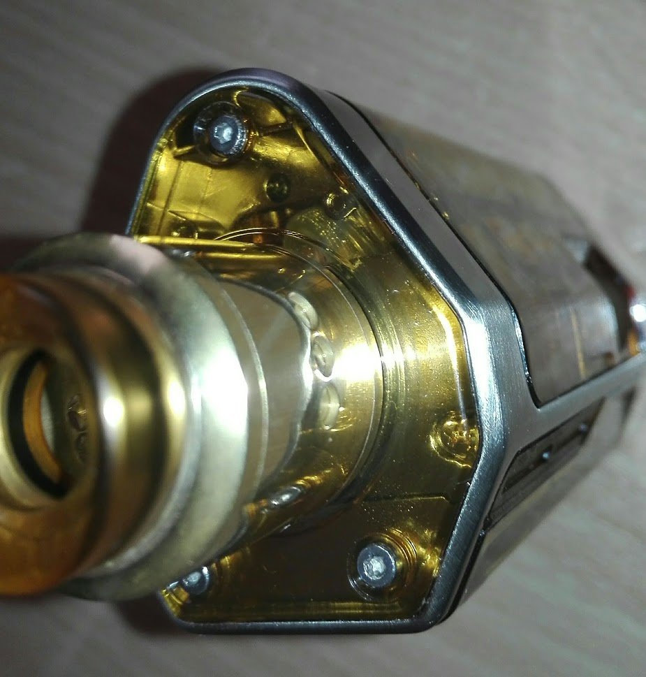

etab75 Posted May 4, 2019 Author Report Posted May 4, 2019 (edited) UPDATE I have taken the mod apart and dried out the internals. Removed the tape which was under the plastic plate and covering the screws now you can see inside the 510 area - quite handy to see if anything is going wrong. The leaking stems from the seal around the centre pin when an atty is screwed on. I saw a video where this area had a drop of sealant placed upon it thus stopping the leaking. Not a perfect solution but it will suffice - its back in use and no problems so far. See video here for reference, similar disassembly though different model: Cheers for the replies. Edited May 4, 2019 by etab75 - added video link
etab75 Posted May 4, 2019 Author Report Posted May 4, 2019 ... forgot to say, also used a small o-ring from the Avocado RTA, the tiny one that is fitted to the ceramic block. Fitted over the centre pin, sealing off any excess, now the 510 well is dry. Think that is probably the easiest method if your Drone leaks. Squonking fine now 👍 1
Vapors Tongue Posted May 4, 2019 Report Posted May 4, 2019 5 hours ago, etab75 said: UPDATE I have taken the mod apart and dried out the internals. Removed the tape which was under the plastic plate and covering the screws now you can see inside the 510 area - quite handy to see if anything is going wrong. The leaking stems from the seal around the centre pin when an atty is screwed on. I saw a video where this area had a drop of sealant placed upon it thus stopping the leaking. Not a perfect solution but it will suffice - its back in use and no problems so far. See video here for reference, similar disassembly though different model: Cheers for the replies. your drone looks different to mine its not as see through as yours at the top did you buy it new ? mine is relatively see through but has a plate underneath this bit you show
etab75 Posted May 4, 2019 Author Report Posted May 4, 2019 15 minutes ago, formula 1 said: your drone looks different to mine its not as see through as yours at the top did you buy it new ? mine is relatively see through but has a plate underneath this bit you show Yep, bought new, I had to remove a triangle I suppose you could say "drone" shape piece of tape to access the screws and dry the contacts out. It left a sticky residue and as I need to access that area (to make sure its dry etc) I left it off so its now totally clear rather than opaque. Its cool as you can see the liquid going up the tube now. 1

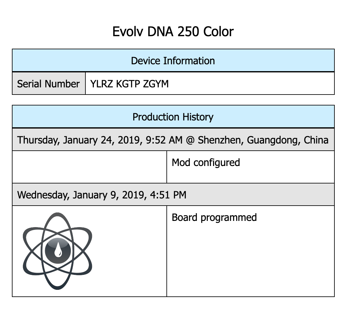

etab75 Posted May 5, 2019 Author Report Posted May 5, 2019 1 hour ago, Wayneo said: Wow! I haven't started squonking yet. My 'Information' shows this, but no clue what batch it would be. Mine was programmed 21 December 2018, and configured in Shenzhen, 23 January 2019. Weren't the first models out in October '18? Suppose these could be early ones, but funny how the ones we are getting here in the UK date back to January. When the DNA75C came out I got one in June and the configured date was May, much closer. On a side note, mine is still working fine, no leaks at all.
Wayneo Posted May 5, 2019 Report Posted May 5, 2019 I'm in Canada so no idea. I think they kept pushing the release date out. Between the door closure issues, ultem to not ultem, blah blah blah 😎

etab75 Posted May 10, 2019 Author Report Posted May 10, 2019 (edited) 2 hours ago, Wayneo said: Sad . Mine is now an official leaker My condolences Wayneo, really disappointing to here this. Firstly I'd try the o-ring (1mm cross section 2mm inner diameter) that is the easiest way, same with Hyperar message above. Try that first. Good luck its bloody annoying!!! BTW Rob at Stealthvape said the majority of leaks come from a under tightened negative nut or tube. Not in my case it came from the centre post when an atty was screwed on, it just oozed out around the bottom, not much but over a period it builds up. Edited May 10, 2019 by etab75
Robbybob Posted May 29, 2019 Report Posted May 29, 2019 Where are you putting the 1mm CS 2mm ID oring? Just over the centre pin from the outside?
etab75 Posted May 29, 2019 Author Report Posted May 29, 2019 21 minutes ago, Robbybob said: Where are you putting the 1mm CS 2mm ID oring? Just over the centre pin from the outside? Yes, unscrew atty, dry out 510 and slip over centre pin, can be a bit tricky I found 2 toothpicks helped with that.
Robbybob Posted May 29, 2019 Report Posted May 29, 2019 At the moment I'm trying out tightening up the square nut on the underside of the 510. It doesn't seem like it will tighten up but using a 510 tightening tool and a 12mm spanner you can get an extra half turn. With some success. The whole 510 is completely reliant on one rubber washer to seal. If the nut is tight and the 510 pin which has the potential for lateral movement moves straight up and down there "should" be no leaks. It's really frustrating
etab75 Posted May 29, 2019 Author Report Posted May 29, 2019 29 minutes ago, Robbybob said: At the moment I'm trying out tightening up the square nut on the underside of the 510. It doesn't seem like it will tighten up but using a 510 tightening tool and a 12mm spanner you can get an extra half turn. With some success. The whole 510 is completely reliant on one rubber washer to seal. If the nut is tight and the 510 pin which has the potential for lateral movement moves straight up and down there "should" be no leaks. It's really frustrating Good luck - let us know how you get on. It is fixable, but annoying nonetheless!
