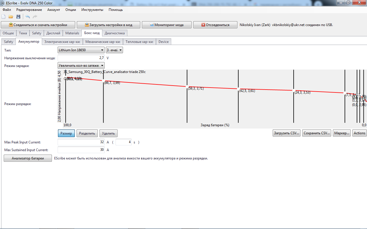

zark Posted April 29, 2019 Report Posted April 29, 2019 22 часа назад, onikami сказал: I am finding that the battery life isn't all that great on the DNA250c think finder. Here is a description of the battery test.

zark Posted May 8, 2019 Report Posted May 8, 2019 В 28.04.2019 в 22:03, onikami сказал: I am using 3 x LG HG2 3000 mah 3.7v Brown batteries The battery should have 4.2 volts when fully charged. 3.7 volts should correspond to 80% charge. You need to change the batteries or set the battery to 100% charge at 3.7 volts. Try a battery test
