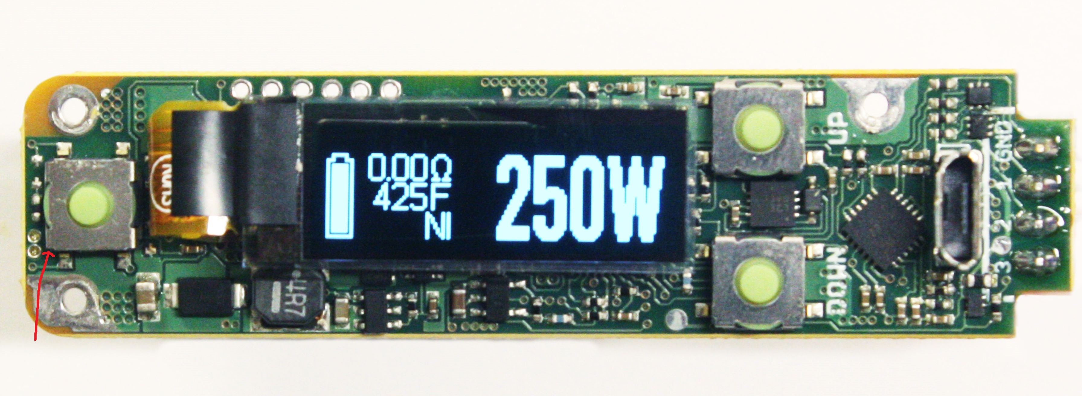

The screen sticks to the board. Be sure the screen comes with the board and not sticking in mod.
Carefully pry off the metal cover of the switch (red arrow). Try to bend it as little as possible, remove rubber piece, remove small metal disc.
Remove the screen prior to cleaning too.
Ok. Am I looking for anything in particular once I get in there?

In the switch?  once dissembled, clean out any liquid that may have gotten inside....either your e  juice or the alcohol.

It's quite possible that you might not have any problem inside them as they kind of seal. But since you have it out in front of you you might as well check them.

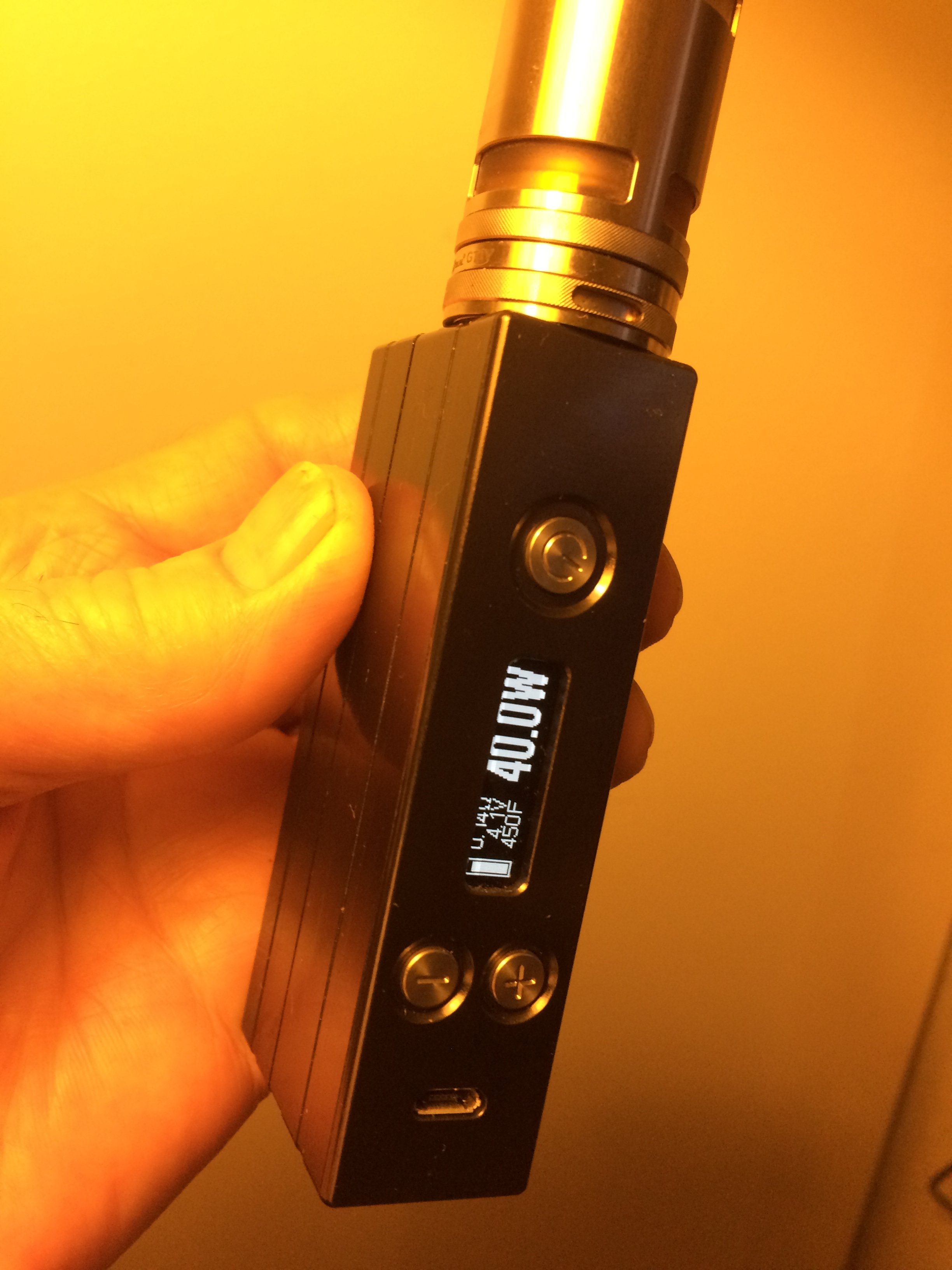

Just wanted to update. Had to scratch the itch that I could build it if I had everything working so I may hope evolv sees this or reach out to them to see if I can get the dna75 board fixed. Here I turned the single lavabox m into a dual 18550?dna75 device. Still showing the too hot warning though.
