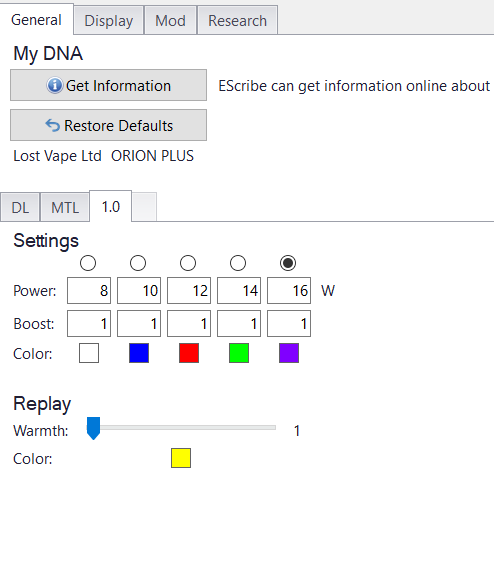

DarkAngel4Now Posted December 12, 2019 Report Posted December 12, 2019 I got the new Q Pro 1.0 ohm coils. They're actually very good. Here are the settings I used on my plus for them. Here's a where I got them: https://www.lostvapeshop.com/lost-vape-coilspods-c-121/?page=LOST VAPE COILS%2FPODS&zenid=q84k1pomjovot7kqkt9gnq6h17

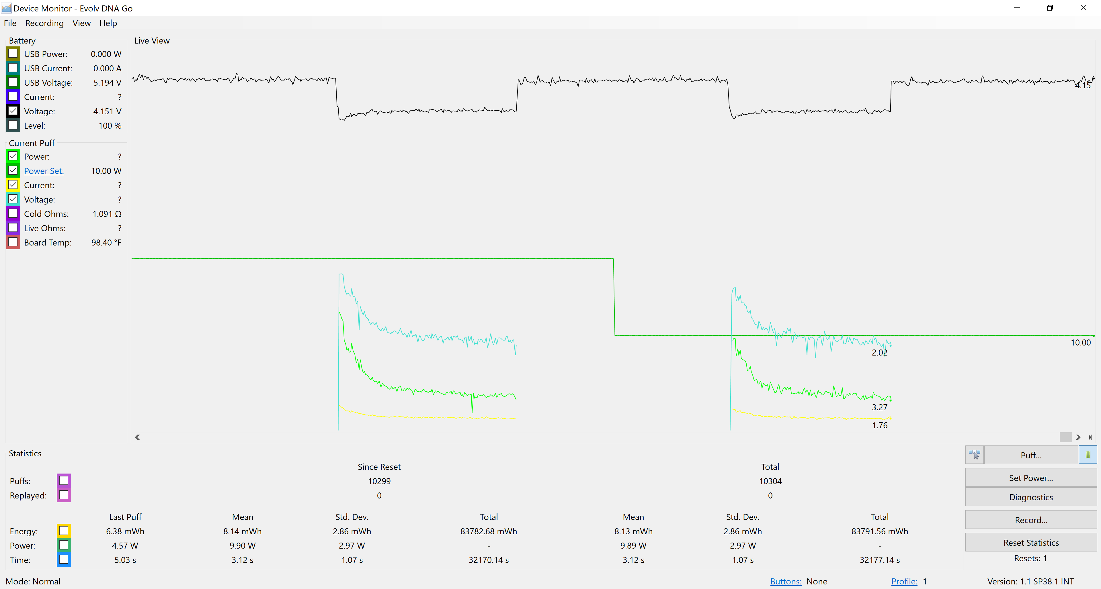

bradbqc Posted November 2, 2020 Report Posted November 2, 2020 I've been trying to get the 1 ohm coils to work with my orion plus, but no matter what settings I try, I never get more than ~4 watts of sustained output when looking at the device monitor. Like, I set it to 4 watts (either via the profiles or directly via the device monitor), and I get 4W. I set it to 20W... still get 4W. I've tried changing pretty much every setting I can think of, and nothing seems to help. I've attached a screenshot demonstrating what I'm talking about. I'm at a total loss here, so any help would be extremely appreciated. Can't even get a good hit at the moment.
bradbqc Posted November 6, 2020 Report Posted November 6, 2020 Figured it out, posting my solution here in case it helps anyone. So, because the 1 ohm pods aren't supported on the orion or orion plus by default, anyone who wants to use them has to change one of their atomizers to accept the 1 ohm pods. When I did this, the acceptable range that I (totally arbitrarily) chose was 0.8 - 1.2 ohms. In my experience the cold ohms of the coil tend to err slightly on the high side, usually between 1.0 and 1.1. And when you take a hit, the coil heats up and the resistance increases. So when I was taking a hit, pretty much regardless of the power I had set, the coil was very quickly approaching that 1.2 ohm limit and the dna chip was automatically reducing the power to keep the coil resistance below 1.2 ohms. As soon as I increased the upper end of the range for the 1 ohm atomizer, I was able to get the power output I had been expecting. I ended up going with 1.5 ohms for the top end, and everything works perfectly now. tl;dr If your system refuses to output as much power as you think it should, try upping the acceptable resistance for your atomizer. 1
