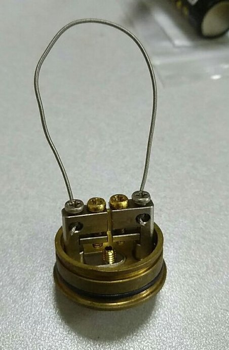

Lanzarotechris Posted October 17, 2018 Report Share Posted October 17, 2018 (edited) I have a replay problem too, when using the Vandy Vape SS316L Fused Clapton wire 24GA *2(=) + 32GA. No replay option available. I contacted Vandy Vape support and we are working on that problem. Will keep you guys updated as soon as I get an answer what the problem is. (actually they asked me to build a 10 cm straight "coil" to check... see photo) Edited October 17, 2018 by Lanzarotechris pic appears 2x Link to comment Share on other sites More sharing options...
Lanzarotechris Posted October 19, 2018 Report Share Posted October 19, 2018 Things got solved thanks to Vandy Vape Support Team. Something was wrong with my first coil, so after the test with the big loop coil, I made 2 new coils in different atomizers with that wire, and now REPLAY works fine on both. Can't explain exactly what was wrong with the first build, but something was... So... even after a year there seems to be a learning curve for me. 😉 Link to comment Share on other sites More sharing options...
