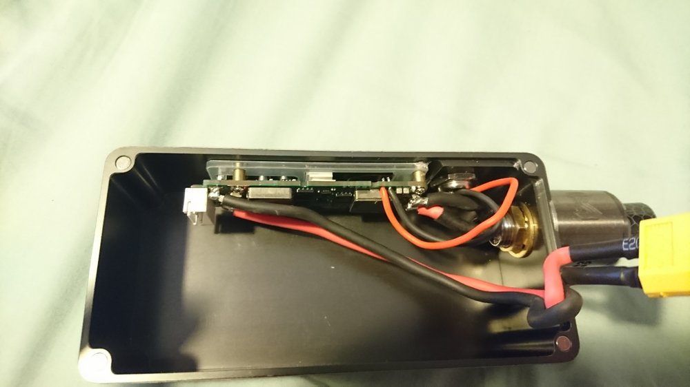

harmis Posted August 23, 2018 Author Report Posted August 23, 2018 Hi again. It was the battery that caused the problem. Got a new one (that was too thick, damn webshop) and all the cells now show correctly 3,8V. Anyone know what could be the problem when trying to fire the board flashes blue light and nothing happens? The mod doesn't even read the atomizer, I cant switch profiles, I can run through the main screen but only once then the mod kind of freezes...
retird Posted August 23, 2018 Report Posted August 23, 2018 Can you post a shot of the wiring inside the device?
harmis Posted August 23, 2018 Author Report Posted August 23, 2018 Here's the picture with the battery removed.

harmis Posted September 27, 2018 Author Report Posted September 27, 2018 Ok, some update and a fix for someone maybe in the future suffering from the same problem. I got a replacement board from Evolv and also got an extra screen just in case. After soldering the new board and seeing that the screen kept freezing still I switched the screen and now it seems to be working as it should. So if someone is suffering from the screen freezing after powering the device the problem may be fixed with replacing the screen. Thanks for everyone who tried to help.
