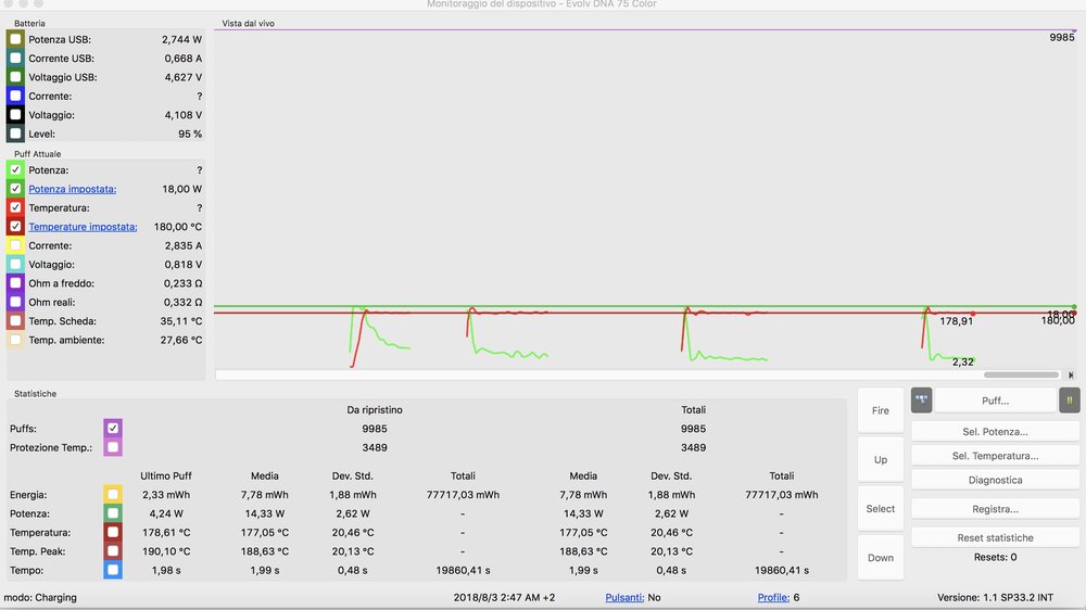

Asfanews Posted August 3, 2018 Report Posted August 3, 2018 Hi folks, I am going crazy. I am using my bf in T.C. but even from the first puffs, when the atomizer is still cold the power drops immediately and it doesn't vaporize, just a little. The first pic is from the DNA75C, the light green line shows a peek at the beginning but then suddenly drops.

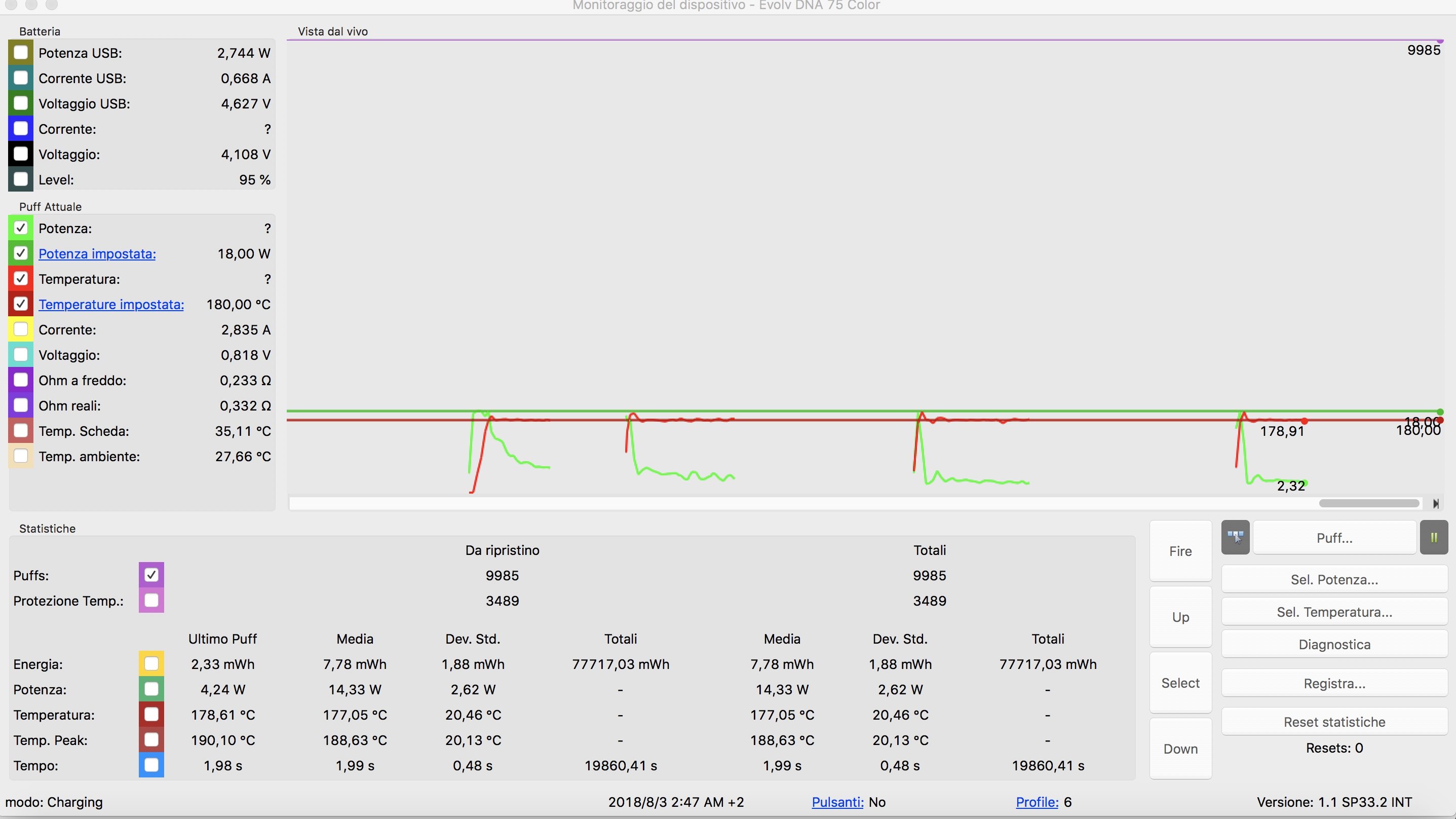

Asfanews Posted August 3, 2018 Author Report Posted August 3, 2018 this pic is from another bf, a simple dna75. Here the power released reaches the right spot and the atom keeps vaping I don't know why, in the first case (DNA75C) the power drops so I can't vape!
retird Posted August 3, 2018 Report Posted August 3, 2018 In the first shot you reach the set temperature ( 180C) quickly (red line) thus the device throttles back. In the second shot your device settings never let you reach your 220C set temperature ( red line) as it peaks at 191+ C.
Asfanews Posted August 3, 2018 Author Report Posted August 3, 2018 5 minutes ago, retird said: In the first shot you reach the set temperature ( 180C) quickly (red line) thus the device throttles back. In the second shot your device settings never let you reach your 220C set temperature ( red line) as it peaks at 191+ C. yes, it's just to explain the lack of power I am having and that I don't understand why. By the way I did the test on the two mods at the same temperature and it was the same.
retird Posted August 3, 2018 Report Posted August 3, 2018 Your first shot reached set temp very quickly... sometimes a coil build (hot spot), using contact coils, or poor connections can result in temp being reached too quickly and the device throttles down....

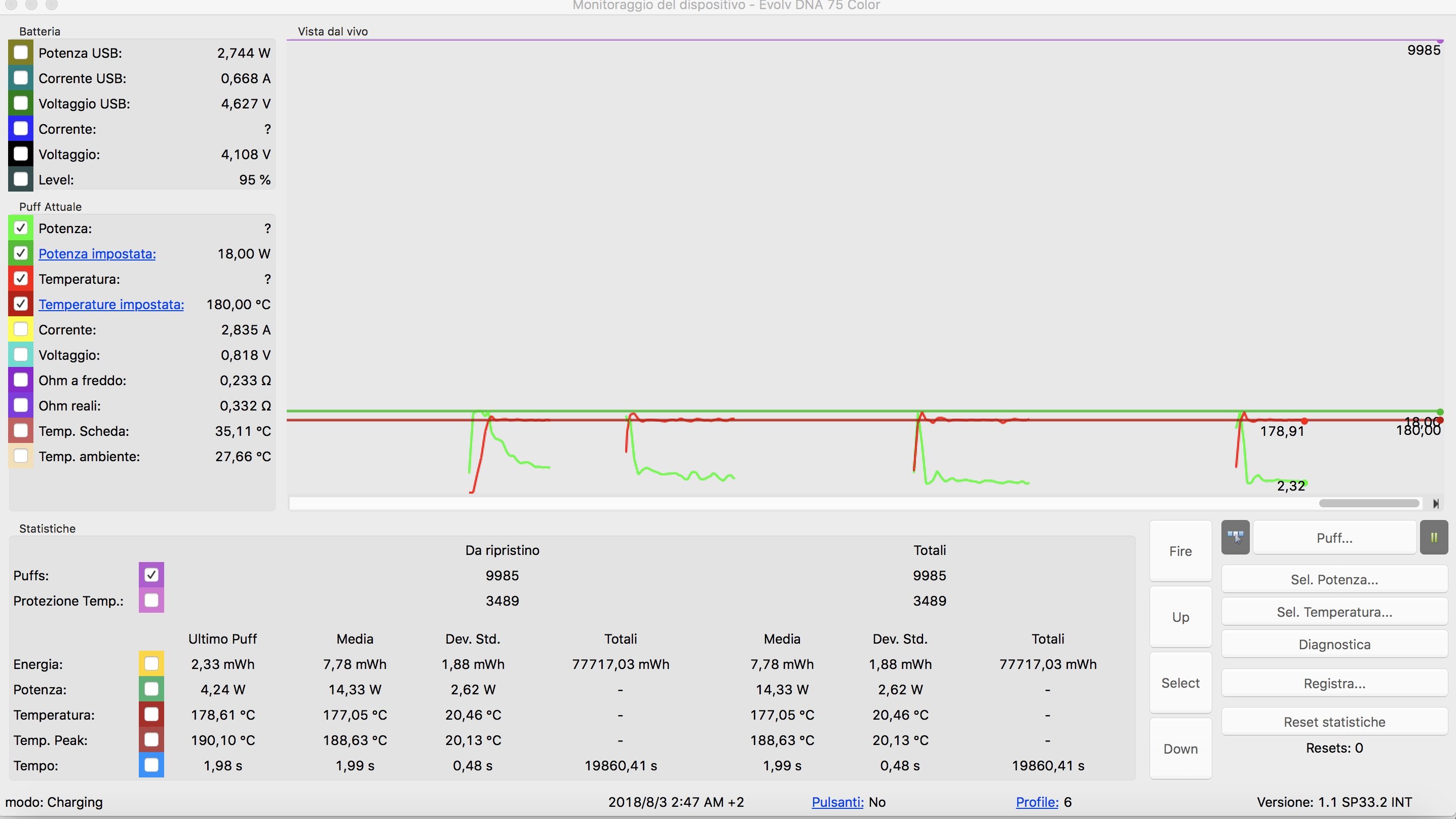

Asfanews Posted August 3, 2018 Author Report Posted August 3, 2018 35 minutes ago, retird said: Your first shot reached set temp very quickly... sometimes a coil build (hot spot), using contact coils, or poor connections can result in temp being reached too quickly and the device throttles down.... First, Thank you for your help. Second, you're saying that the drops of power in the following pic is due to poor connetion? (no hot spot I am sure, it's just a 5 wrap 26AAWG coil). I'll check tomorrow and update the post.
retird Posted August 3, 2018 Report Posted August 3, 2018 Yep I said it could be the cause ... didn't say that was the cause.....many things can be causing it..... and on your second shot where the device doesn't reach your set temperature you could increase the watts,or reduce Temperature ,so you can reach set temperature and you should see the same throttling back of power as set temperature is reached that you see in your shot 1 as it reaches set temperature. 1
