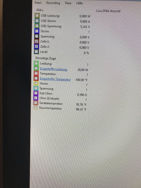

Winner123 Posted July 21, 2018 Report Posted July 21, 2018 Hello, i need help. Since yesterday i cannot use my Mod anymore. the Battery are fully charged but the Mod only shows me 2-4% . Also there is a clock and Date error. i‘ve done escribe software update. I‘m on 1.1 SP33.2 thx

Winner123 Posted August 25, 2018 Author Report Posted August 25, 2018 Hello again, After 4 Weeks (Holiday) without using the Mod now the Mod is been working for two Days! After Two Days now same issue: battery stocks on 2%. Mod dont work !
Winner123 Posted August 25, 2018 Author Report Posted August 25, 2018 Made a ticket at Evolve ! Lets wait.....

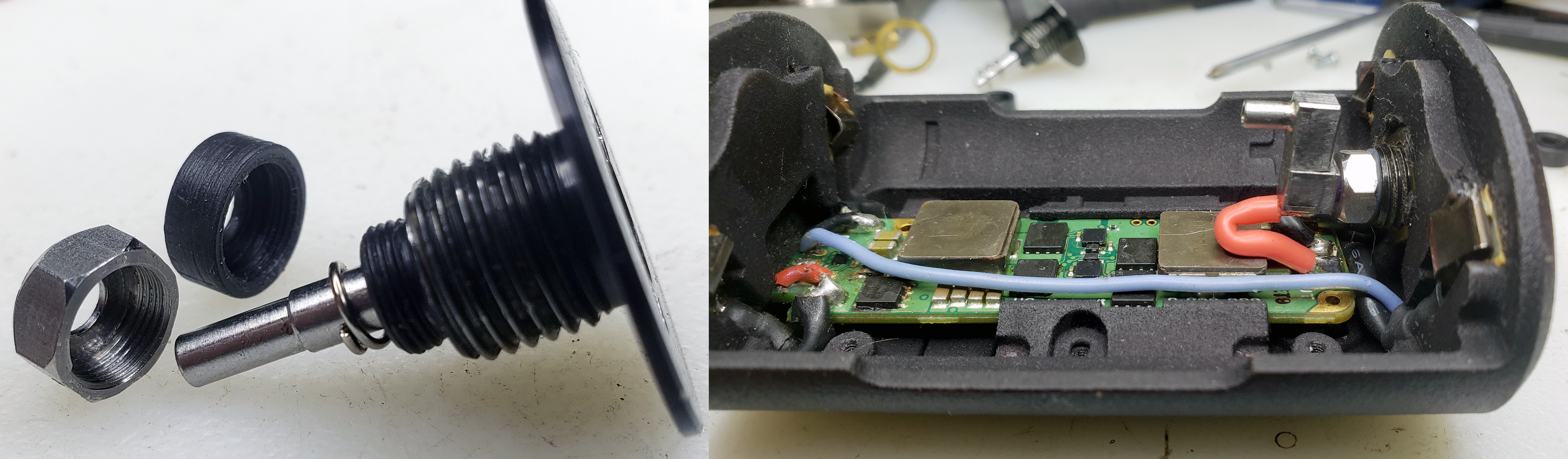

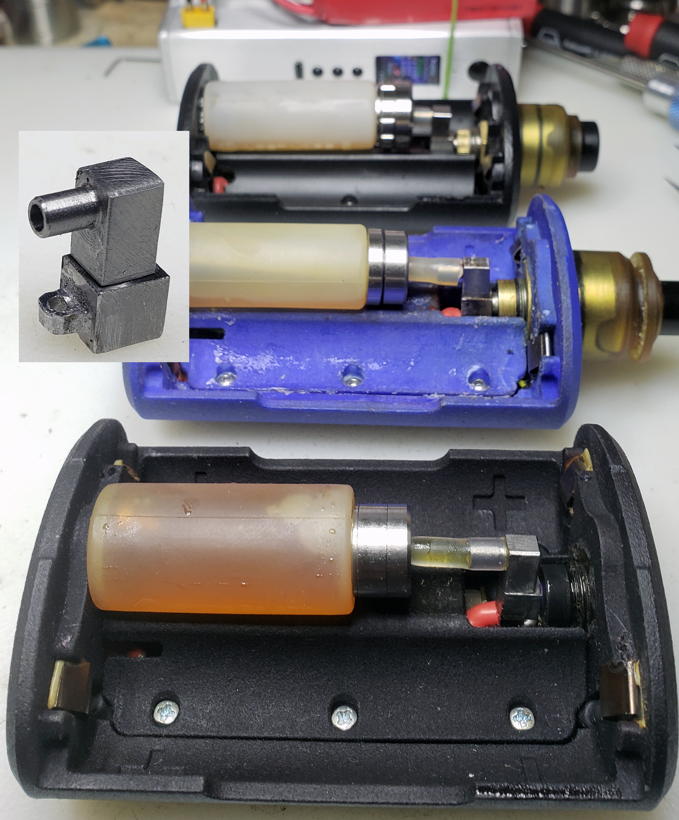

AMDtrucking Posted October 14, 2018 Report Posted October 14, 2018 It's a little off topic, but I was getting tired of the Boxer's leaking issue due to the position of the bottle offset. I made my own Elbow Adopters and converted several mods of my friends. They are now dry as Sahara. 1
AMDtrucking Posted October 14, 2018 Report Posted October 14, 2018 I also made a Stainless Steel back nut and replaced original delrin nut. 1

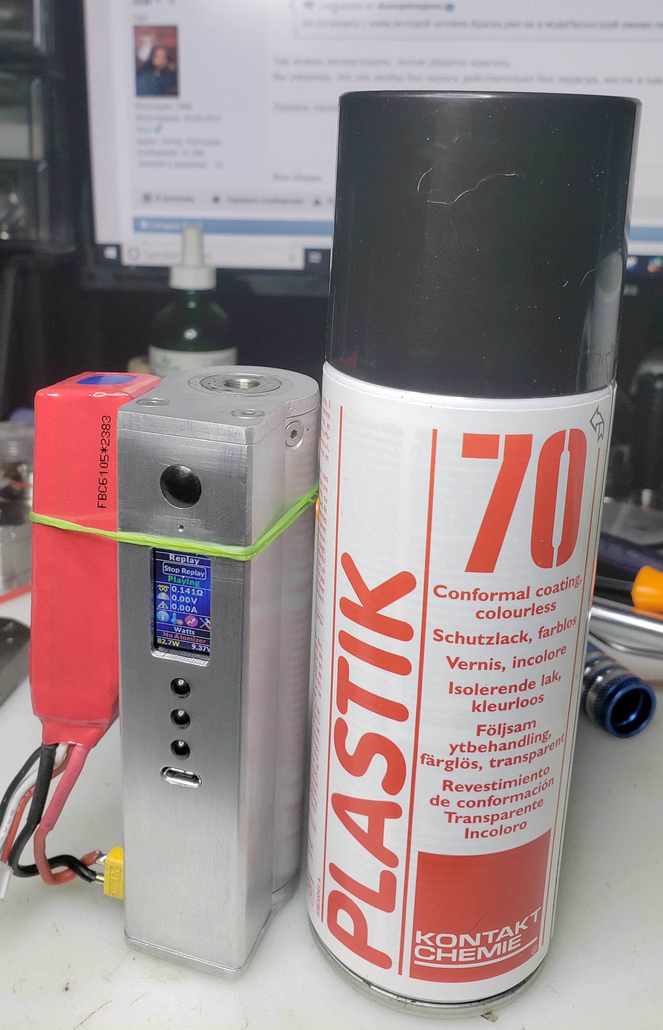

Spector NS5 RD Posted October 15, 2018 Report Posted October 15, 2018 @AMDtrucking Are all three of those Boxer 20700 squonks authentics? (What happened to the blue one? Poor thing looks like a can of PVC glue spilled in it. lol)
AMDtrucking Posted October 15, 2018 Report Posted October 15, 2018 (edited) 54 minutes ago, Spector NS5 RD said: @AMDtrucking Are all three of those Boxer 20700 squonks authentics? (What happened to the blue one? Poor thing looks like a can of PVC glue spilled in it. lol) Yes they are, but only one of them, is mine. It's the blue one. I've had it from the day one of release and in had several modifications to it. Including an RTV Silicon sealing of the board, at one time. What looks to you as a PVC glue, is actually what's left of that silicon. But my leaking issues have gone away, since I installed an offset elbow adapter and I don't use silicon anymore. It's a pain in the A to remove. 😀 What I do now is I spray it with a product out of Germany, it's called Plastik-70, it specifically formulated to protect PCB from moisture. Edited October 15, 2018 by AMDtrucking 1
