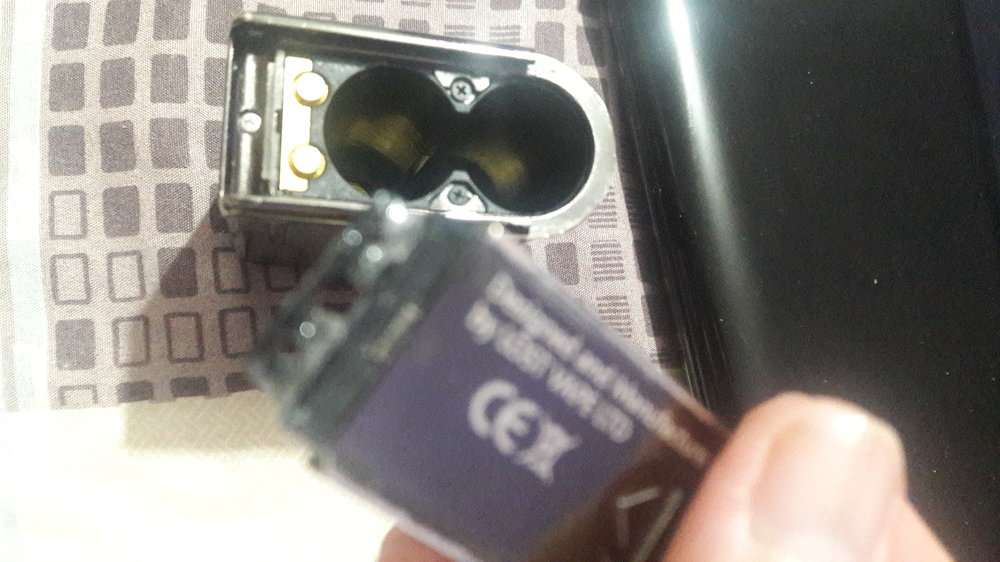

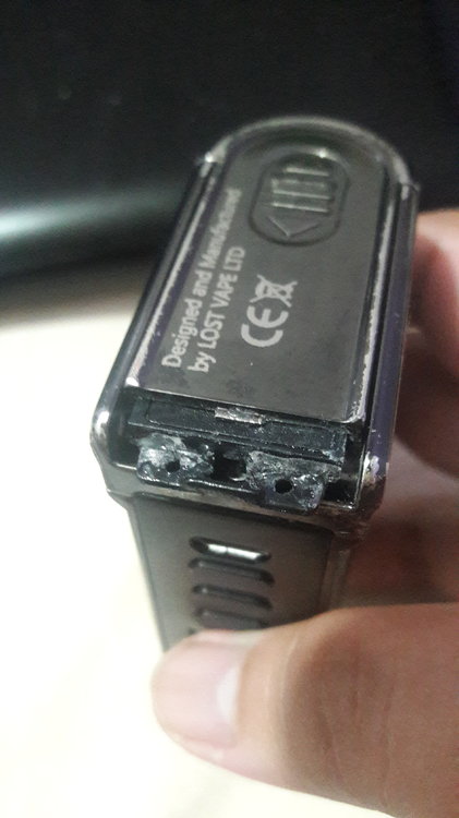

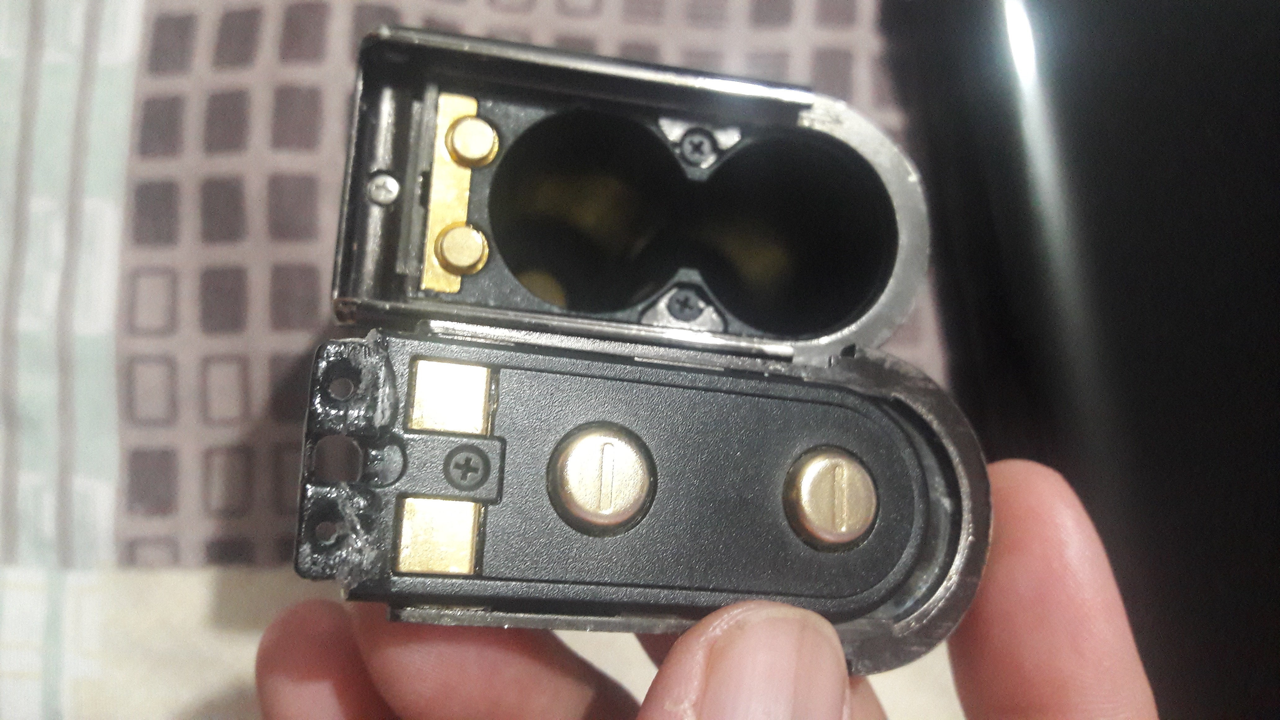

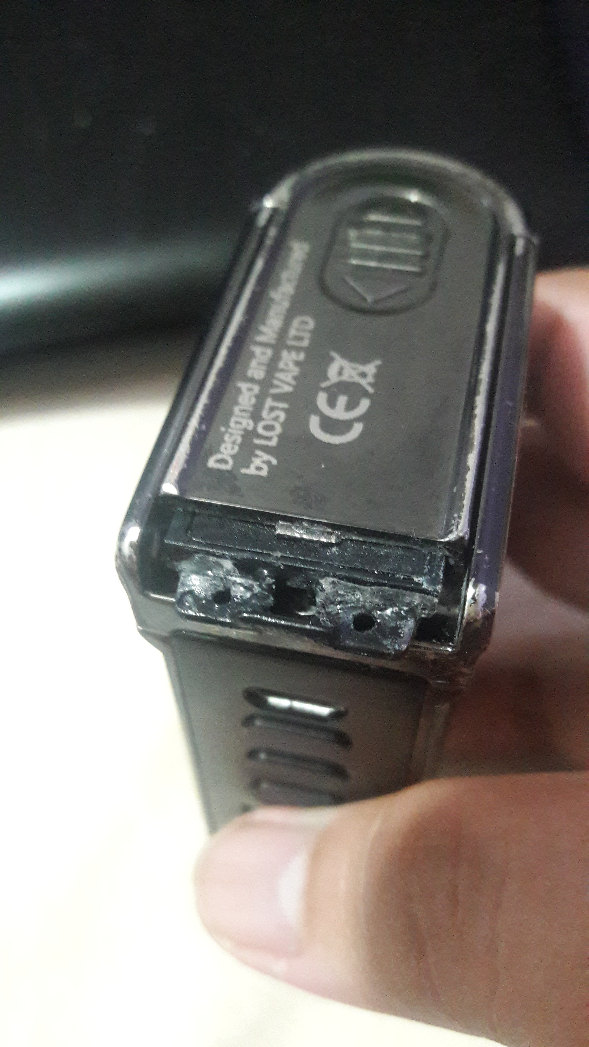

Pjr Posted July 17, 2018 Report Posted July 17, 2018 Hi! My Lost Vape Paranormal 75c's battery door broke off. Had it's very thin hinges loose for the past weeks then it went off totally today. Has anybody experienced this, and found a fix? Thanks!

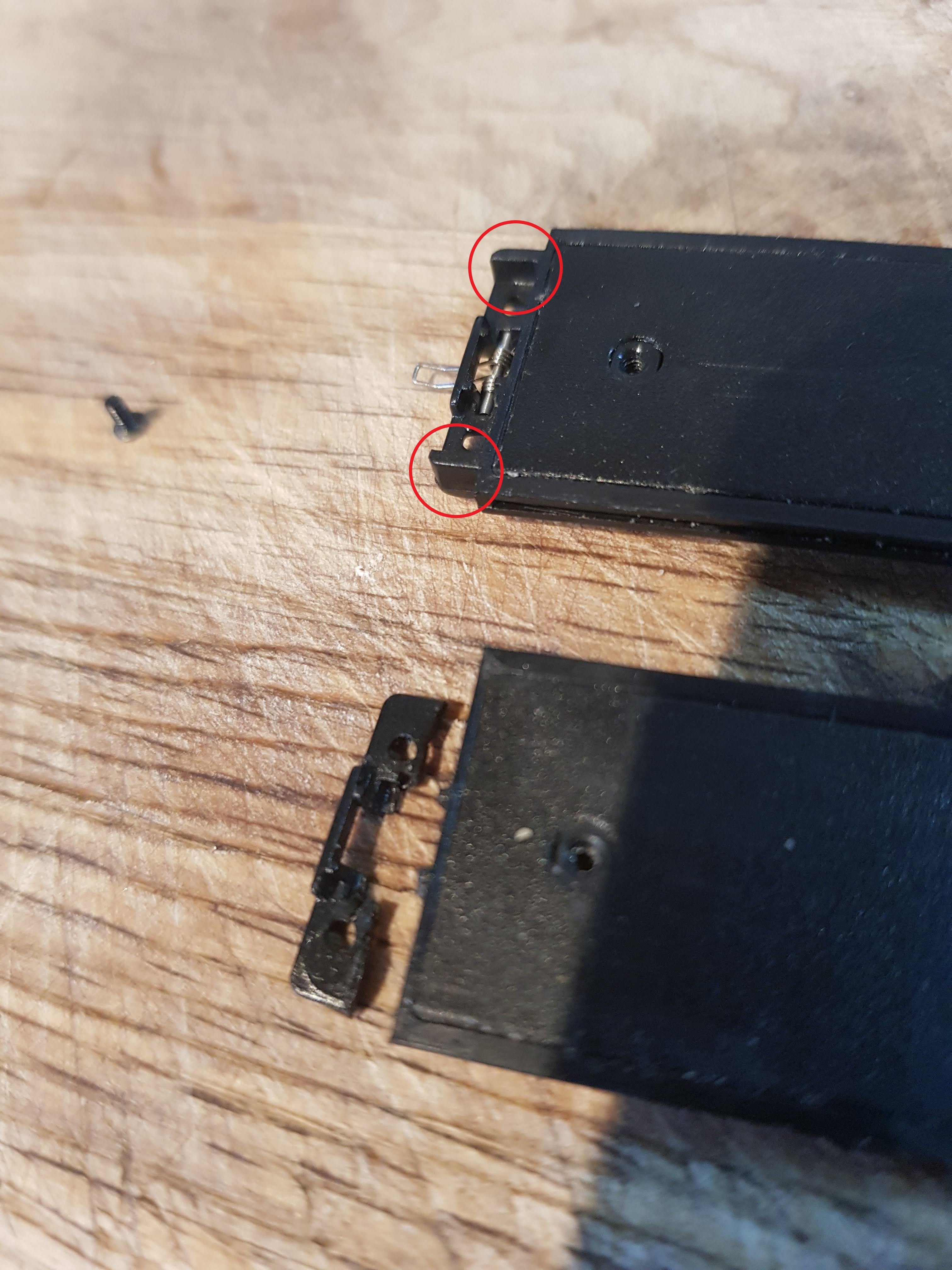

abraxas69 Posted August 30, 2018 Report Posted August 30, 2018 On 8/23/2018 at 12:20 AM, TNT0305 said: Where it connects at the hinge was *slightly* different than the one my particular Paranormal had. It had some little tabs on 2 sides. On the 3rd side (on the the end of the thing), the original had the tab, also. I was able to just take some snips and remove the "extra" tabs. After that, wham, bam and done. Thanks Evolv! Just came on herre to say thanks to the OP and dwcraig1 for this thread and link to evolv helpdesk, and evolv for their fantastic support! Raised a ticket 2 weeks ago and replacement part promised straight away. Arrived yesterday (shipped to UK). For anyone finding this thread, had the same issue as TNT0305 with the tabs on the side, but easy enough to resolve as stated (see pic). I found getting the (very tiny) screws back in the hardest bit, but that's as much about my eyesight as anything else. Thanks again evolv - fantastic customer service!

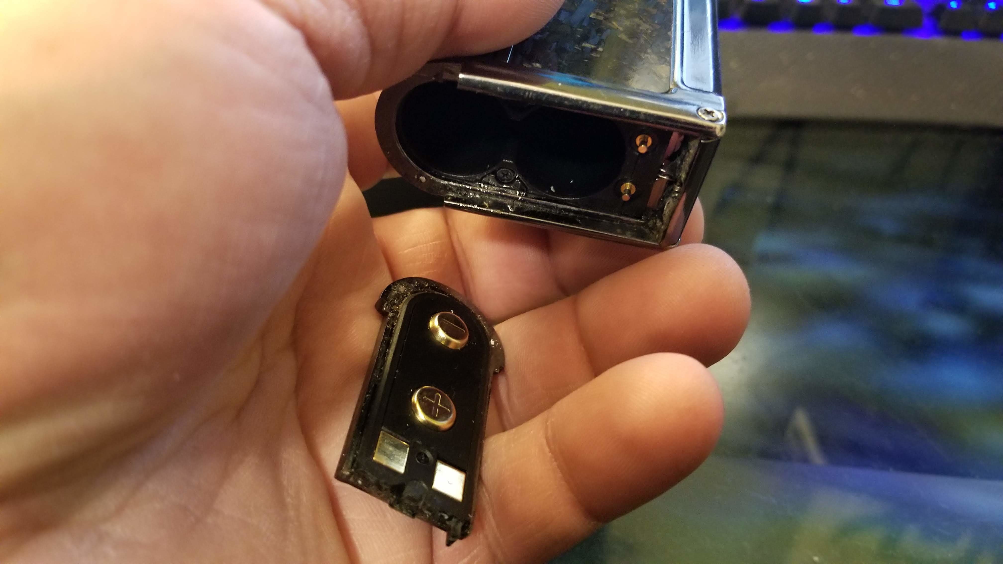

wogfun Posted December 7, 2019 Report Posted December 7, 2019 The battery door broke off my Paranormal DNA 250C yesterday. I was hopeful to see others getting parts support here. When I contacted Evolv through the above link as others have, they basically told me I'm out of luck, no parts available. Try the reseller or something. Yeah ok... Just venting
