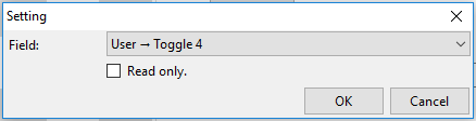

RickdeM Posted July 9, 2018 Report Posted July 9, 2018 Can someone please help me out on the 'toggle -> user#' thing. What can i do with it?
Wayneo Posted July 10, 2018 Report Posted July 10, 2018 @RickdeM You can see an example of using this on the Lock screen of the latest Gauges theme
RickdeM Posted July 10, 2018 Report Posted July 10, 2018 On 7/10/2018 at 2:42 PM, Wayneo said: @RickdeM You can see an example of using this on the Lock screen of the latest Gauges theme Expand Thanks i will check this one out
