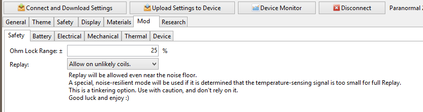

Jetro Posted May 25, 2018 Report Share Posted May 25, 2018 (edited) 20 hours ago, conradisrugged said: Hold on Jetro! I'm using N80 framed staple twisted wire on my one tank I use most of the day, is it compatible with Replay or do I have to change some settings in Escribe? Conrad, It might or might not work with your complex coil. If you want to try it, here is how to activate the new option. Open EScibe and connect your mod. At the top of the window click Help , About EScribe. Look at the picture below. Then in EScribe click the mod tab and open the safety tab. Next to Replay you will find the option to Allow on unlikely coils. It will look like the second picture. I have had no problem with the dual N80 claptons in my Velocity and the .5 ohm N80 coil in my Subtank+. I have vaped them dry with just a hint of cotton taste, which where I stopped and redripped or refilled the Subtank+. When I say dry I mean no visible juice on the wick or in the tank. I think its worth a try to see. JT Edited May 25, 2018 by Jetro brain fade Link to comment Share on other sites More sharing options...
Jetro Posted May 25, 2018 Report Share Posted May 25, 2018 (edited) On Wednesday, May 23, 2018 at 5:34 PM, Nyudeluxe said: Dual Coils on Kan/A1. My Reload RTA / Corona V8 didnt get Replay after 100 puffs Did replay work with PK mode work with kanthal? I just tried a kanthal build in both PK mode and the new Allow on unlikely coils. It did not work. I am pretty sure there is no replay with kanthal at all. For replay to work the board needs to see a rise in resistance which does not happen with kanthal. With N80 I can see a very small resistance rise with device monitor and replay works for me . Believe or not. JT Edited May 25, 2018 by Jetro clairify Link to comment Share on other sites More sharing options...

ShowerHead Posted June 17, 2018 Report Share Posted June 17, 2018 It isn't meant to support straight Kanthal. If it does, consider it blind luck. Evolv does not advertise it as doing Kanthal in Replay mode. I'd think the very name of the hidden option would be a big hint. Unlikely. Link to comment Share on other sites More sharing options...
