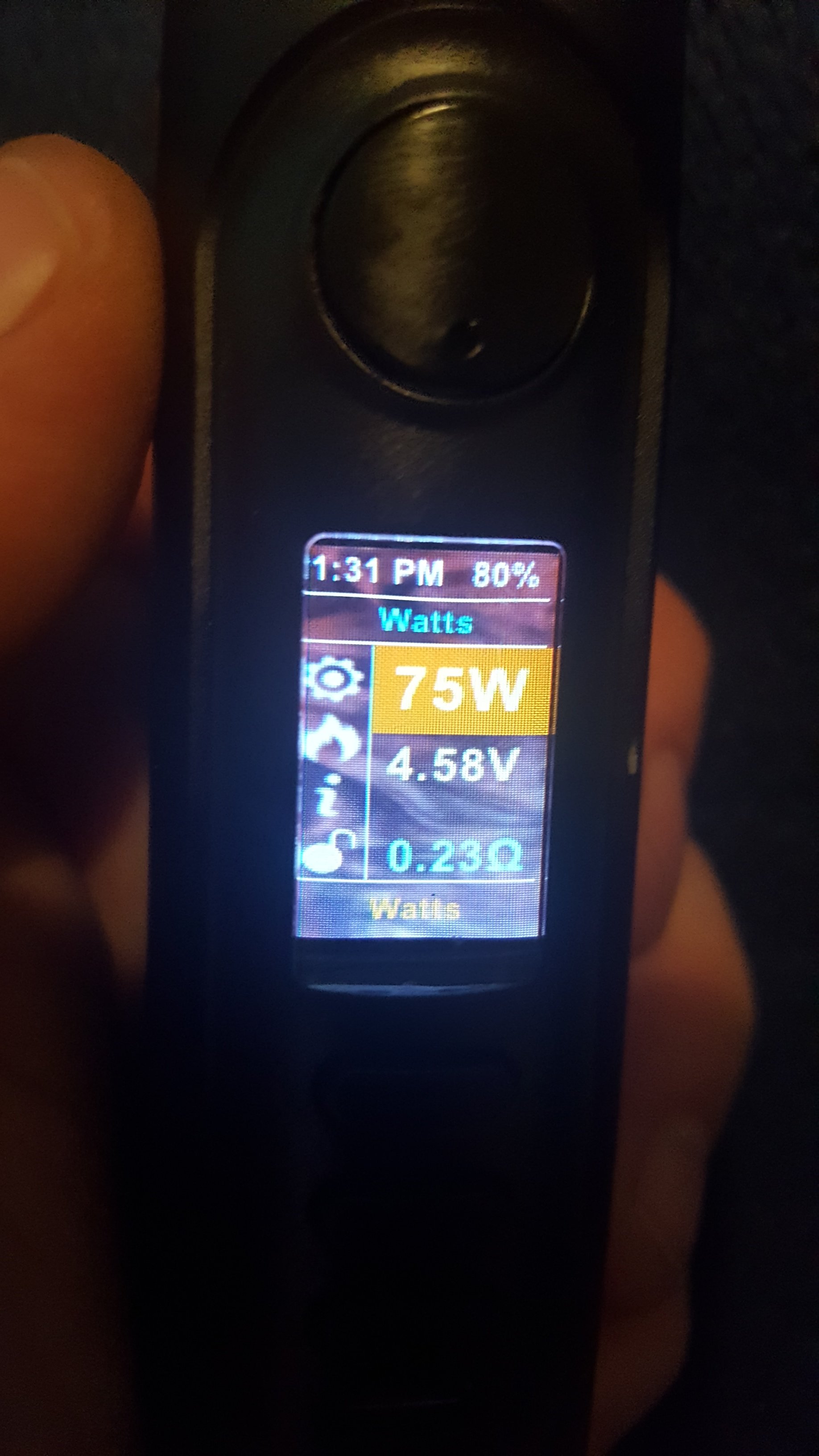

CBR954DMC Posted May 15, 2018 Report Posted May 15, 2018 I have Escribe and cant tell you how many times ive tried to get this vape to have an output of 100watts and Still i can ONLY get it to go to 75watts!!!! What am i doing wrong?!

Spector NS5 RD Posted June 5, 2018 Report Posted June 5, 2018 The 100w applies only as a 1 second pre-heat boost feature. 75w is max continuous output of the board. 1 1
Kovacs Posted June 15, 2018 Report Posted June 15, 2018 Whoever told you that the DNA 75C chip can handle 100w.. I wouldn't take any further advice from this person. Please try to apply logic and common sense on that matter. It is like you're trying to drive a vehicle that absolutely can't go faster than 75, to go 100.
