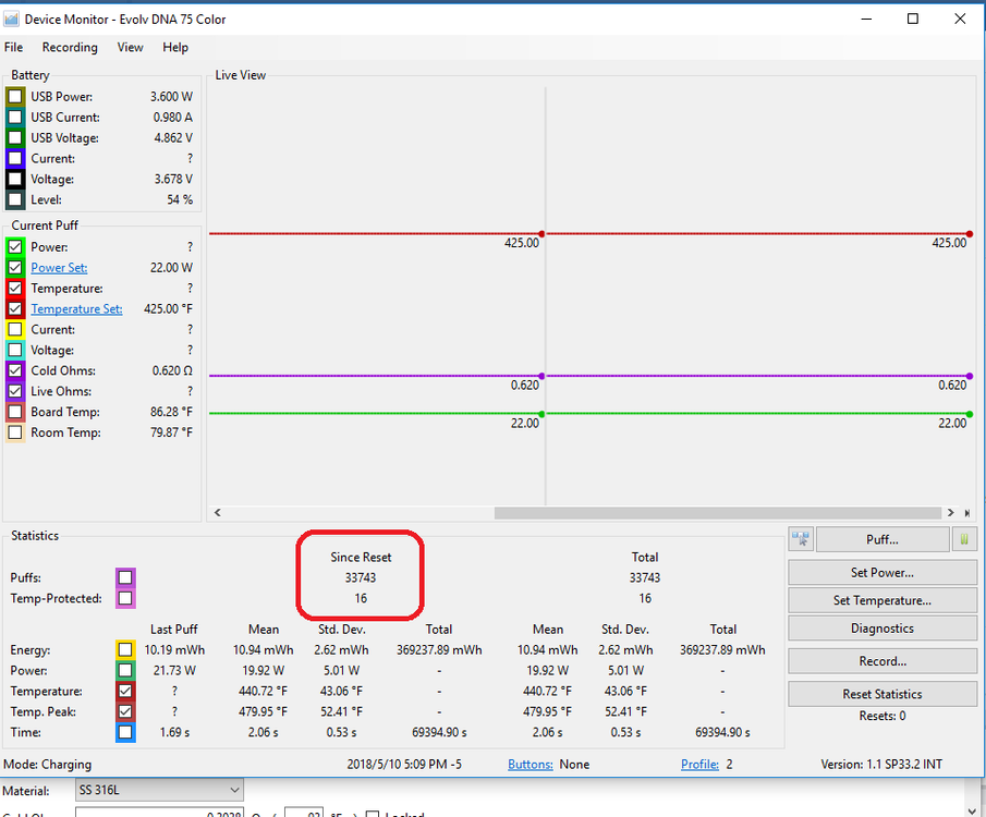

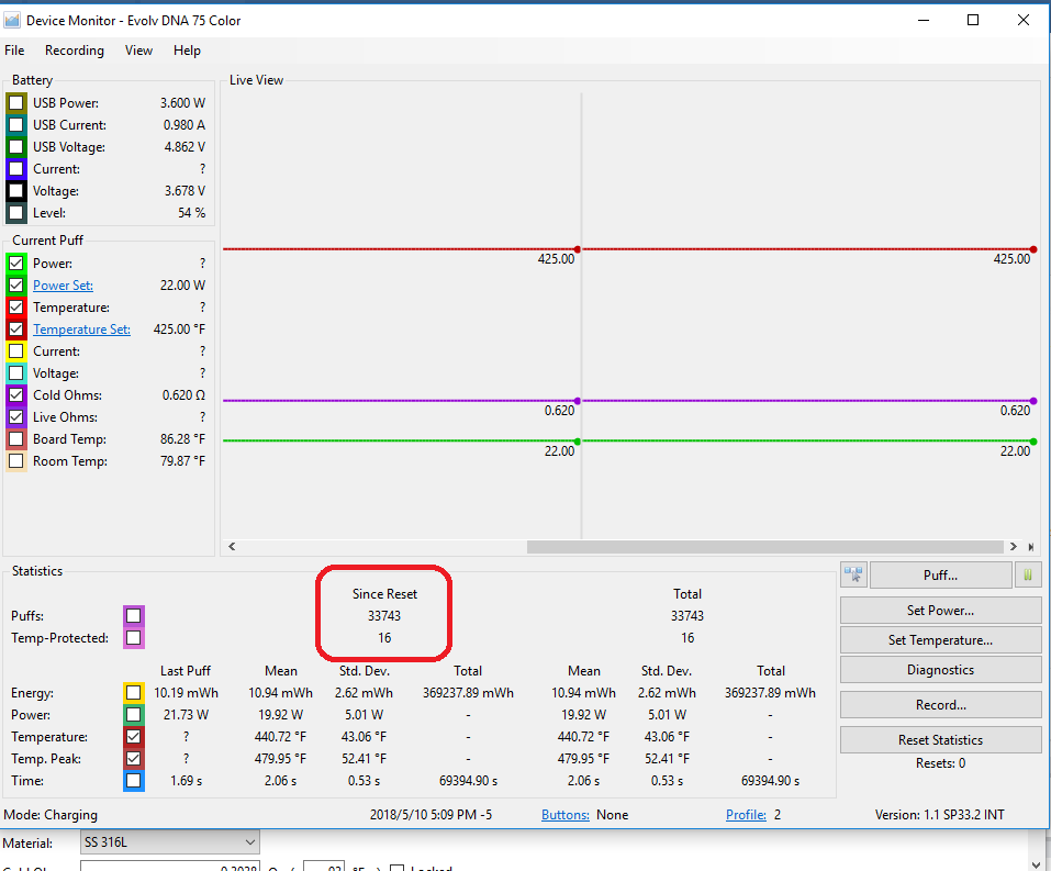

retird Posted May 10, 2018 Report Posted May 10, 2018 "If I recall when you reset Puffs it resets Puffs "Since Reset" and the "Total" Puffs doesn't ever reset but give a total since vaping started.... In Device Monitor..........
niandra3 Posted May 10, 2018 Author Report Posted May 10, 2018 (edited) @retird oh man I am a total idiot. Copied the skeleton from another theme so I didn't build this part myself. Anyway thanks!!!! Edited May 10, 2018 by niandra3
