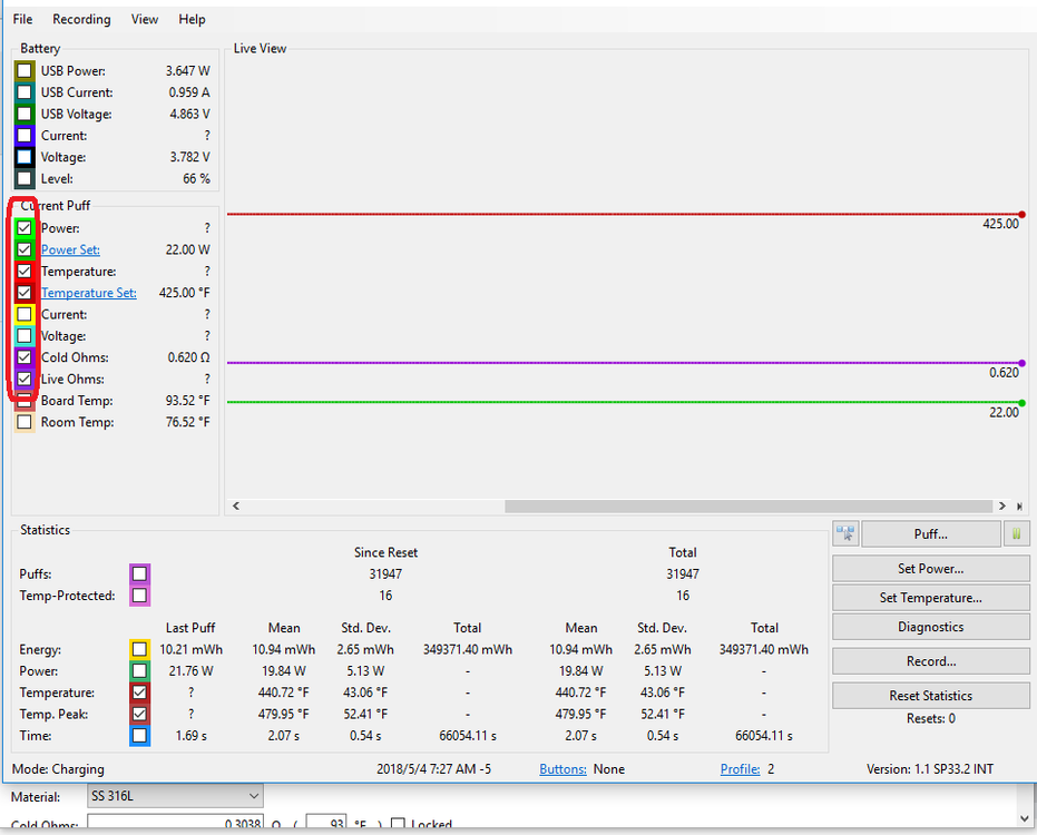

retird Posted May 4, 2018 Report Posted May 4, 2018 Can you post a screenshot of Device Monitor while firing the cold coil which gives you the "throttled" message? Tick the following on the left side so it will show on the graph....

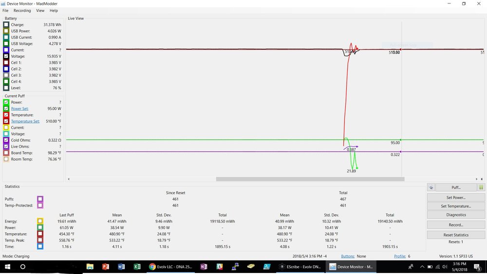

Pete1burn Posted May 4, 2018 Author Report Posted May 4, 2018 Here you go. The coil was warm this time, but it still happened. The vape about 30 seconds earlier was totally normal.
retird Posted May 4, 2018 Report Posted May 4, 2018 Unless I'm missing something it looks like you are reaching the set temp quickly and the power throttles down to maintain the set temp.... What happens when you set the power down to 60 watts?
Pete1burn Posted May 4, 2018 Author Report Posted May 4, 2018 I think we're both missing something. 75% of the time, everything is perfectly fine. Mod fires, gives me a full vape, no issues at all. About 25% of the time, I'll get a hit for about half a second, and then nothing at all. This is when the "throttling" message shows up on the screen. A normal hit also shows the power varying to keep the temperature, but it's working. When the throttling happens, it goes dead.

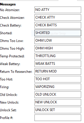

retird Posted May 4, 2018 Report Posted May 4, 2018 OK no powder coating or anodizing.... I had to consult others about this "throttling" message you are getting as I never saw or heard of that message. I am told that that message was probably changed in the language of the theme (whoever designed the theme) so what does that message mean? Throttling is not a default error message that Evolv uses.... we now need to know what message this "throttling" replaced? Does it mean weak battery? Temperature Protected? Check Atty? You can look at your theme in Designer/ Language tab and see....
GHammer Posted May 4, 2018 Report Posted May 4, 2018 (edited) 3 minutes ago, retird said: OK no powder coating or anodizing.... I had to consult others about this "throttling" message you are getting as I never saw or heard of that message. I am told that that message was probably changed in the language of the theme (whoever designed the theme) so what does that message mean? Throttling is not a default error message that Evolv uses.... we now need to know what message this "throttling" replaced? Does it mean weak battery? Temperature Protected? Check Atty? You can look at your theme in Designer/ Language tab and see.... It means Temp Protect. Edited May 4, 2018 by ShowerHead Media
retird Posted May 4, 2018 Report Posted May 4, 2018 OK.... that just means you have reached temp setting .... that's all.....
Pete1burn Posted May 4, 2018 Author Report Posted May 4, 2018 4 minutes ago, retird said: OK.... that just means you have reached temp setting .... that's all..... Well yes, I figured that's what it meant, but it's not accurate. Like I said, it works most of the time perfectly fine, and occasionally will get that message with a completely cold vape.
retird Posted May 4, 2018 Report Posted May 4, 2018 Temp Protect message should only display when the temp is reached..... you can check using Device Monitor to see when the message shows up.....it should not display if you are not at temp....
retird Posted May 4, 2018 Report Posted May 4, 2018 Also, a hot spot in the coil can give false Temp Protect.......
mactavish Posted May 5, 2018 Report Posted May 5, 2018 Some of you may have seen some of my posts about the “temp protect” message which was standard on most DNA boards before the COLOR versions. Since I liked it, and have been unable to ever see it on my DNA75C, I wrote James (Evolv), he is what he said: “Interesting, looking at the code you're right. Temp Protected only throws on Color as an error for overshoot/out-of-control and Ohms out-of-range. I don't have it operating as a warning. I've added that option to my To-Do list.” So perhaps the posters problem is related to one of those other errors. I vape TC all the time, I’m sure I’ve hit my temperature, but have NEVER seen a TP message on my color mod.
retird Posted May 5, 2018 Report Posted May 5, 2018 He does show an overshoot in the screenshot..... good catch..... good info you got from James.....
