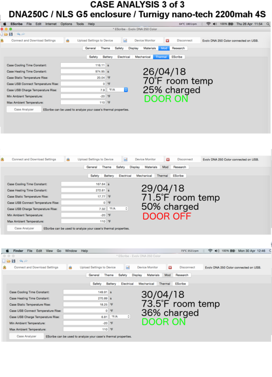

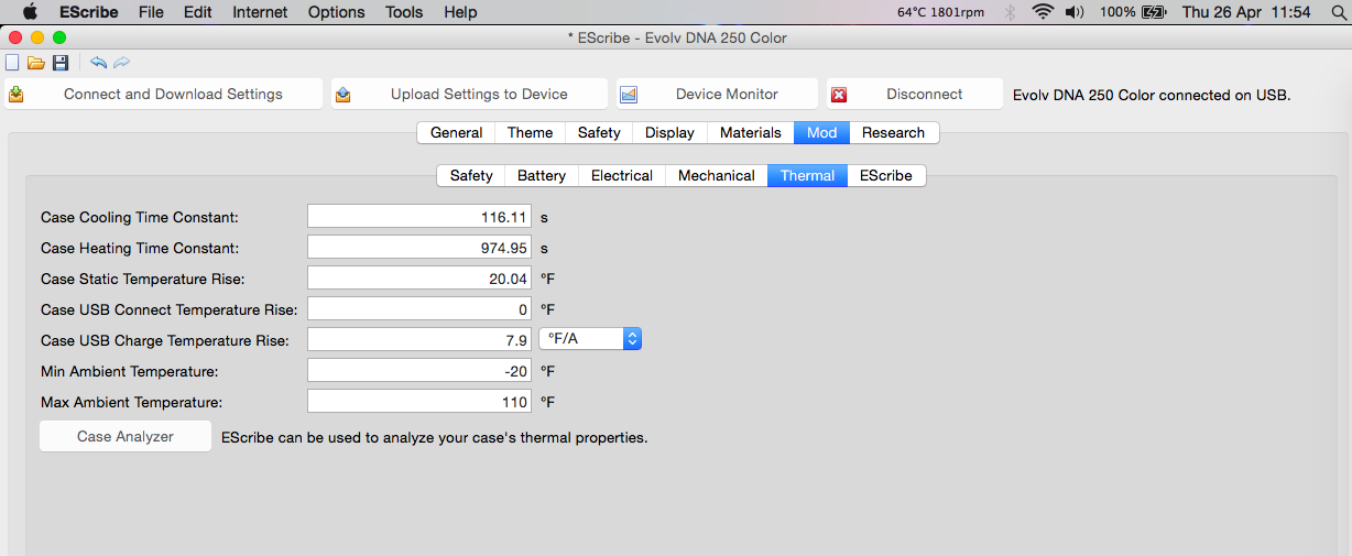

Was the battery only half  charged before running Case Analyzer?  And you entered the real room temp before starting Analyzer?
Wonder if you could run Analyzer again with the case door off of the device and see what it returns.........

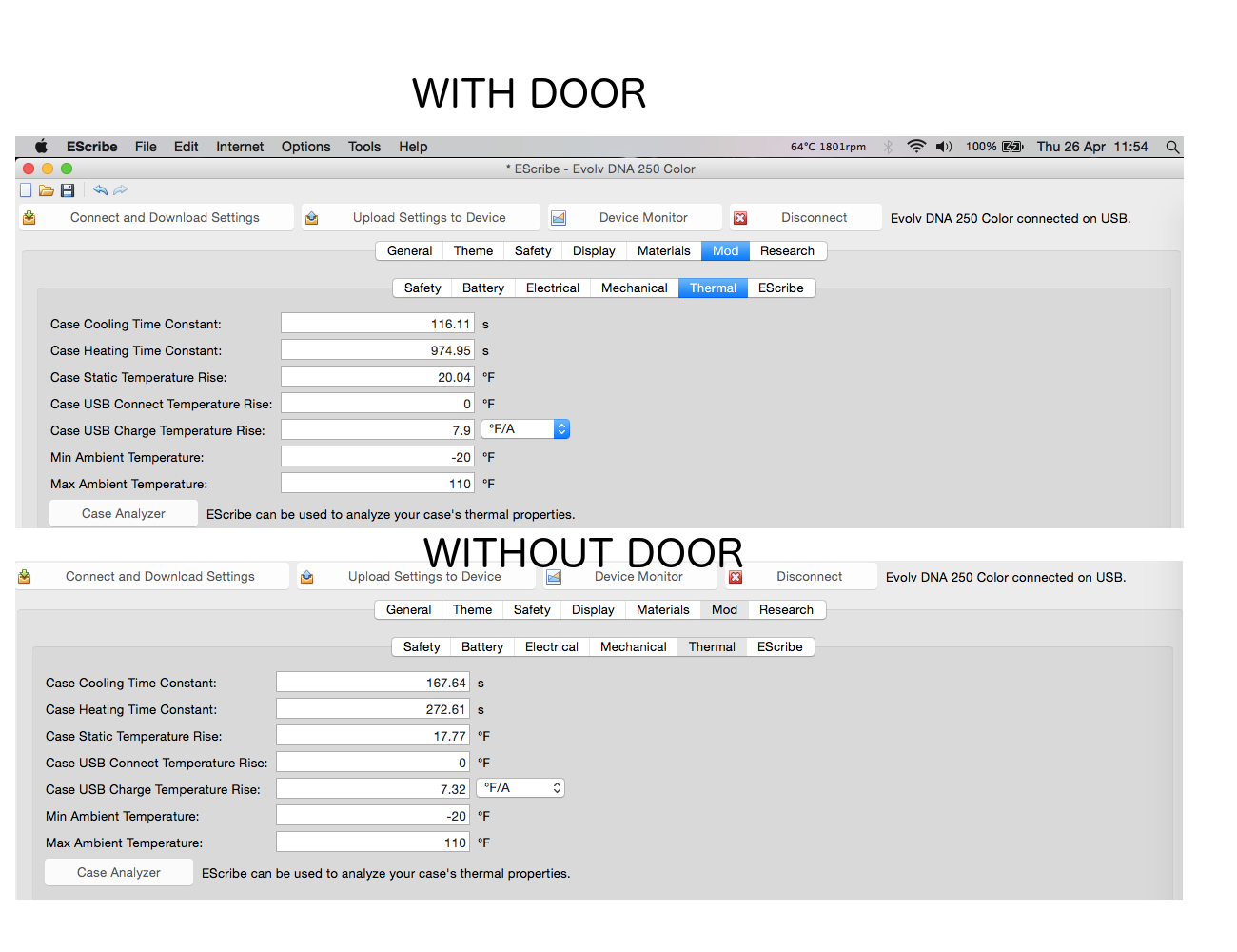

Case thermals run again no door
50% charge 71.5℉
Turnigy nano-tech 2200mah 4S 25~50C Lipo Pack

Yep, Evolv folks drop in and read..... at least two were here Saturday and/or Sunday........  and at least two this morning.... they are busy guys with many hats....
So you have questions about the Case Static Temperature Rise right?  Both devices seem pretty consistent from your last run @ 18.4F and 18.25F
And does the device not turn on after the Case Analyzer finishes on both of you guys devices or only on @Zaptear device?
Anything else?

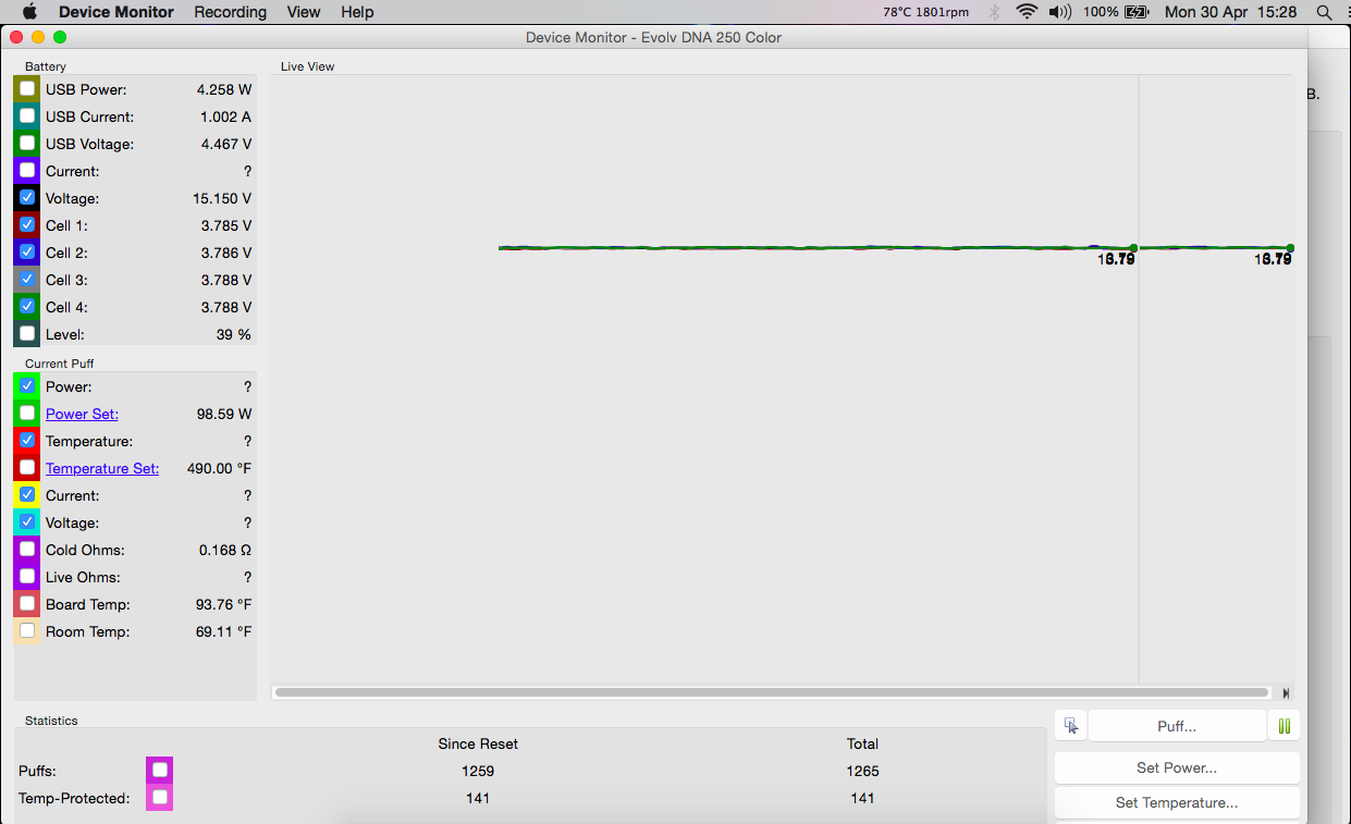

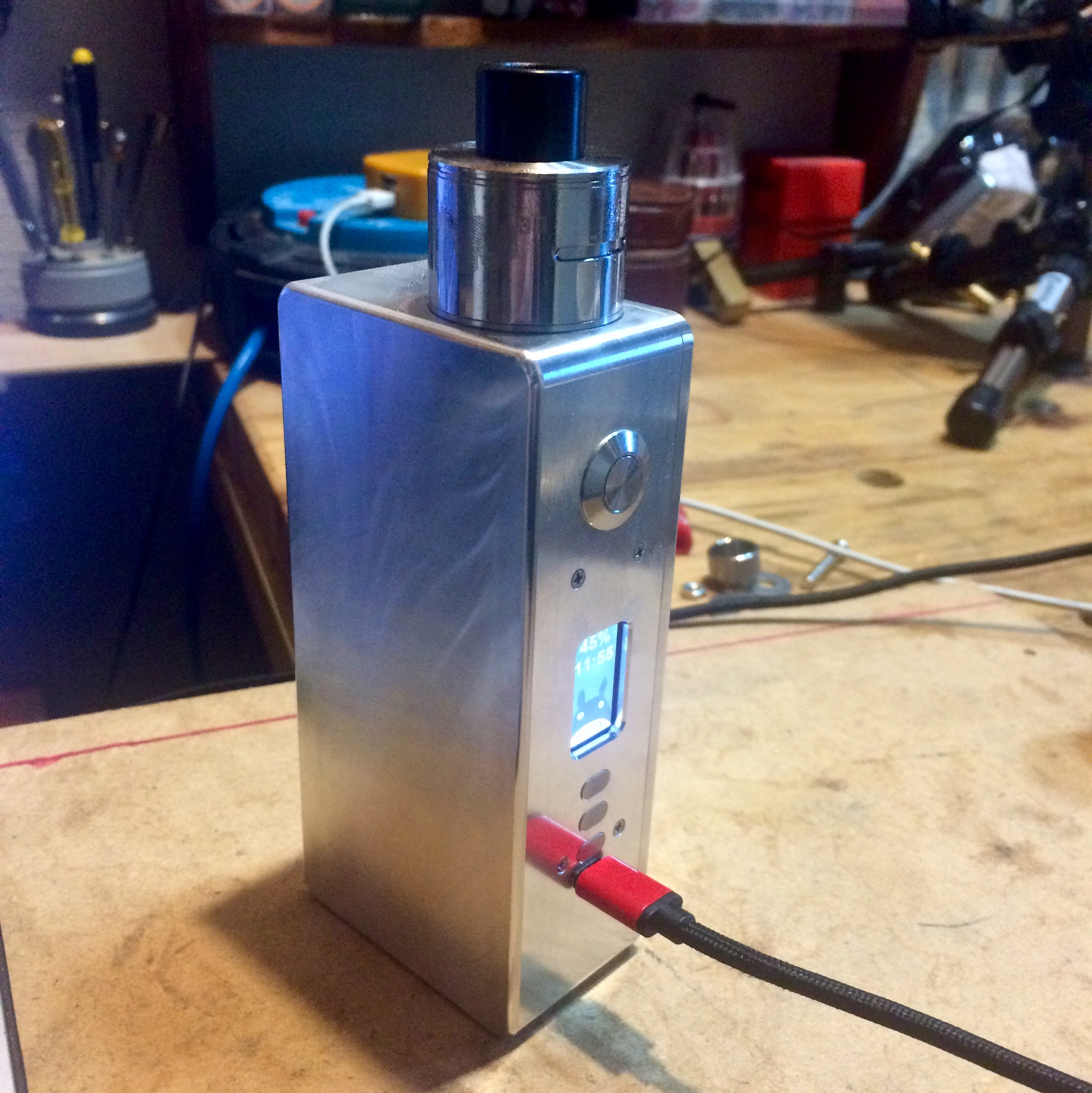

Question:    At what rate (current) does the device charge at when hooked up to your computers?

My device turns on after Case Analysis
I still do not know why the first Analysis gave those numbers, maybe the new lipo reaching proper balanced state as cell 3 was not in line with 1,2 and 4 at first, It was balance when I ran the first analysis though
1 amp from my Macbook
Nothing else thank you
