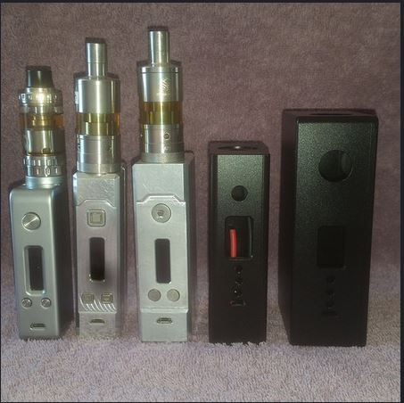

awsum140 Posted April 15, 2018 Report Posted April 15, 2018 (edited) I'm building two Alpine Tech GL2s and they hold dual 20700s, if that helps. The GL2 isn't too big and all the long sides have rounded edges so it's pretty comfortable in the hand. Left to right - Kanger K1(DNA75), Mod Crate ERM(DNA75), ERM+(1300mah DNA200), GL2(dual 20700 DNA75C), Alpine Tech N1(2200mah, 4S, DNA250C). The 75C and 250C are awaiting 510 connectors. . Edited April 15, 2018 by awsum140 2
Wayneo Posted April 15, 2018 Report Posted April 15, 2018 2 hours ago, awsum140 said: The 75C and 250C are awaiting 510 connectors. Which one's? 1
awsum140 Posted April 15, 2018 Report Posted April 15, 2018 The 510s are StealthVape Source Flats, 22mm. I would have used Evolv 510s but the case top is too thin for them without major work to get them to sit flush. 1
Wayneo Posted April 15, 2018 Report Posted April 15, 2018 Atty swirls just destroy me, so I debated between the Source and the modmaker. I'm using 3 of the modmaker and happy they're proud of the body. Solid 510. My poor Modcrate 510 sits .... and my Varitubes are just atty holders. 1
steamer861 Posted April 15, 2018 Report Posted April 15, 2018 Nice to see better quality 510's than the old FD & VT. I'm partial to the Source, I know it's a cheaper knock off of the Evolv 510 But for the $ it's pretty nice To the OP, If your looking for a single 2x700 "C Chip" enclosure thats not as big as a house! Check out this one! http://analogboxmods.ca/ABM-1-CNC-Aluminium-Enclosure I know battery life is not that great with a single cell on the 75c. But If 16 amps is good for you the 20700 Sanyo "B" is over 4000 mah 3
awsum140 Posted April 15, 2018 Report Posted April 15, 2018 I don't mind a little "proud", keeps marks off the mod, but the Evolv would stick out about 1.8mm. Way too much. 1
