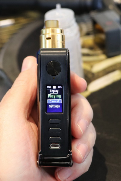

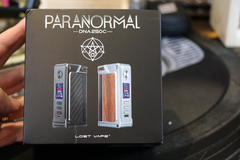

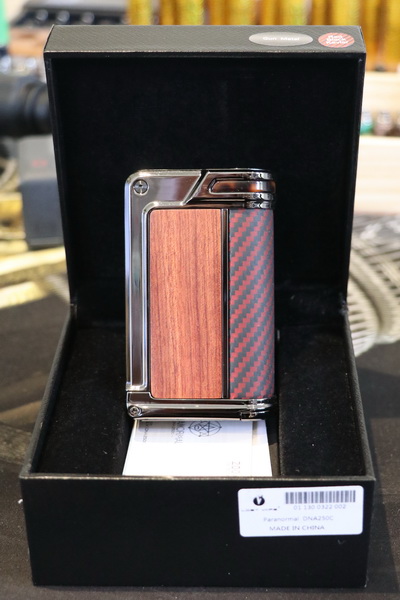

The first DNA250C landed in South Africa today! I have to say after using the Paranormal in Replay mode for the day the hype is very real and this is most certainly a game changer for the industry. The Paranormal is really well made and the DNA250C appears to be working perfectly! I can wait to upgrade all my DNA75C mods!

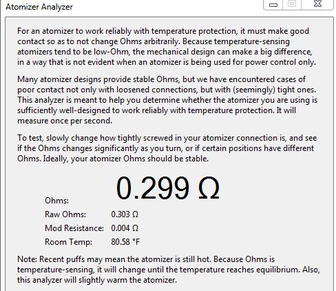

0.04 is standard i think.
DIY it, short the 510 out (google search how) set the internal res to 0.00, then use atty analyser, then input that data.

Where do I find that out @sykesy13? My coil is a SS Framed Staple Akien at 0.195Ω
You have to hook it up to escribe. My paranormal was .004

The default internal resistance set in the Paranormal 250C is 0.004.  I zeroed my Paranormal 250C out and checked with a copper plug and it is actually 0.005; not a big difference but worth mentioning.
