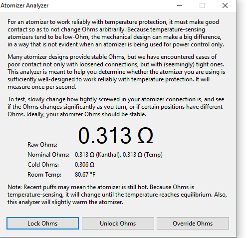

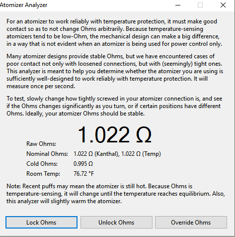

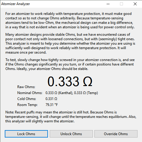

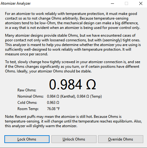

DMcC Posted March 15, 2018 Author Report Posted March 15, 2018 Indeed, thanks for the input. It will be a day or two before I have an atomizer free to do this specific test; however, I do have Kanthol coils in a Pulse 24 RDA at the moment (although the resistance is lower, so the misreading is scaled down), and just tossing them on readers I get: Tab: 0.23 Therion: 0.23 JAC: 0.25 Note that's a squonking RDA in mid-use so I'm not leaving it on there for too long to minimize the juice I have to clean from the connector when I remove it :). So although I don't have the atomizer analysis numbers yet (and will do that with a higher resistance kanthal build just to make any discrepancies more apparent), the essential numbers match my experience thus far. The DNA in the JAC just reads it a bit high (my Ni200 coil: Actual: 0.14, JAC: 0.15; the SS316L: Actual: 0.71, JAC: 0.76,; Kanthal: Actual: 0.23, JAC: 0.25, etc.). Everything I've tried just with the simple "read the ohms" produces exactly the same general effect. The JAC reads them high, by some percentage I'm guessing as the higher the actual resistance, the more pronounced the misreading of the resistance. As I said though, this is not exactly what you asked for, just confirming the trend of high resistance reading on a kanthal build rather than SS316L. I'll be due to recoil one atomizer within a day or two and will do a build with 24 gauge kanthal and record the data you've mentioned and update. ~DMcC

JAC Posted March 16, 2018 Report Posted March 16, 2018 It will be interesting to see how the rounding is effecting things, if the therion is reading 0.234, and our one is reading 0.245 that's a 0.011 variation showing as 0.2 between the mods. The higher coil is above these sort of rounding issues though, so if you could build something in the 0.8-0.9 range we can see if this is consistently off and with the greater margin. The mods I have here are all within Waynes range and explained by decimal rounding. It seems odd it would increase with the higher coils, if it was consistently off by a fixed amount, you could just adjust your internal resistance and it would read fine, but a percentage adjustment isn't possible. 1
DMcC Posted March 17, 2018 Author Report Posted March 17, 2018 (edited) Ok, let's see what I've managed to do (or do wrong as the case may be)... I made a coil from 24gu kanthal which my tab was reading as 0.98ohm on a freshly cleaned Siren 2 deck. I changed the mod resistances to 0 for reference (previously the Therion 166 was factory set at 0.004ohm, the JAC was set to 0.003 by me based on the feedback provided). Therion 166: mod display: 0.96; Analyzer showing: 0.960 cold, 0.984 reading (varying 0.979-0.987 over time while analyzer running) - 1st screenshot below JAC DN75: mod display: 0.99; Analyzer showing: 0.995cold, 1.022 reading (varying 1.017-1.027 over time while analyzer running) - 2nd screenshot below --- Also did the same test setup using the small wire suggestion--a small arch of the same 24 guage kanthal---in the link (which I assume is to actually better calculate mod resistance). The tab was reading it as 0.31ohm with the following results: Therion 166: mod display 0.31; Analyzer showing 0.306cold, 0.313 reading (varying 0.308-0.315 over time while analyzer running) - 3rd screenshot below JAC DNA75: mod display: .33; Analyzer showing 0.331cold, 0.333 reading (varying 0.330-0.335 over time while analyzer running) - 4th screenshot below If I'm interpreting this correctly, the 0.003 case resistance on the JAC seems about right. The 0.004 the Therion was set to looks about right as well (might be 0.001 or 0.002 low, but it's close in any case). --- As for the original query, you can see again why I get confused by that as the JAC is showing a 0.02-0.03+ difference in the base reading of the coil (and short wire). The Therion is a 166 as I mentioned, not a BF (and I realize that means it's a DNA250-based board in that one...just trying to get my head around the difference in readings on the two devices as I do move the tanks around). Not sure if this is revealing or not, but tried to gather the data ~DMcC (edited to label the screenshots) Therion 166 - 0.98 kanthal: JAC DNA75 - 0.98 kanthal: -- Therion 166 - short wire kanthal JAC DNA75 - short wire kanthal: Edited March 17, 2018 by DMcC
