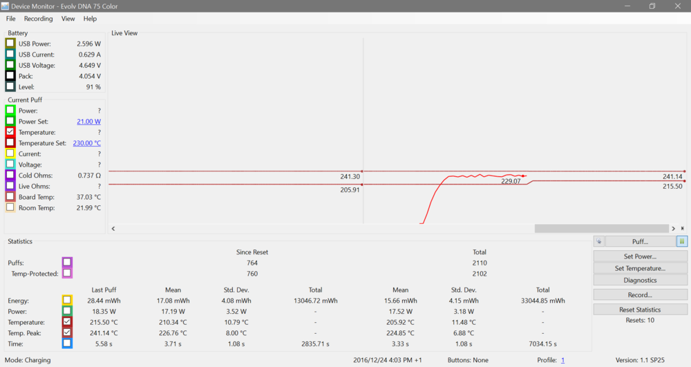

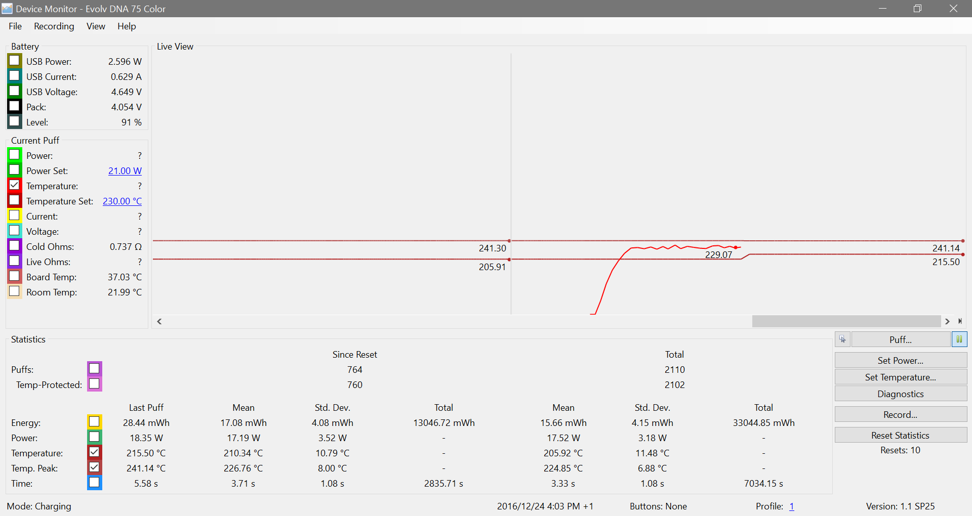

denniz Posted December 24, 2017 Report Posted December 24, 2017 (edited) I recently got my HCigar VT75D and was curious about something. When I look at the device monitor I see a peak temperature of 241C (466F) and an average temperature of 215C (419F). The temperature on the mod is set at 230C (446F). When looking at the real-time temperature graph I never see it hitting that peak temperature, it's mostly somewhere between 227C (441F) and 233C (451F). So how and where does that peak temperature come from and how long does it last? I can reproduce this effect consistently where the temperature off-course varies a bit every time. See the screenshot below. For my example I'm using a simple 3,5mm diameter SS304 coil (0.33mm thick wire), measuring 0.737 ohm in a Merlin mini RTA wicked with Cotton Bacon v2.0, set at a temperature of 230C (446F) with the wattage at 21W, pre-heat is off. The juice is a 70 VG / 30 PG ratio. The coil resistance is not locked. The SS304 profile comes from the Steam-Engine. The mod internal resistance is set at 0.003 ohm measured with a copper plug I bought specifically for this. I haven't run the case thermal analyzer yet. The about box in Escribe says version 2.0 SP5.2. The about box on my mod says firmware 1.1 SP25. Edited December 24, 2017 by denniz

denniz Posted December 24, 2017 Author Report Posted December 24, 2017 (edited) 4 minutes ago, Wayneo said: Usually as it ramps up, and then drops to your set temp. Usually due to a high punch ... say 11, and on a subsequent vape, will get lower. Also known as the Karloz bump. That 215.5C for temp is the average of your vape which would include the ramp UP to your set temp. The average temp I figured out, which indeed includes the ramp up time, but I have pre-heat disabled and the wattage setting at 21W isn't that high for this type of coil. Also why doesn't the real-time temp graph show it hitting that peak temp? See the middle red line. Edited December 24, 2017 by denniz

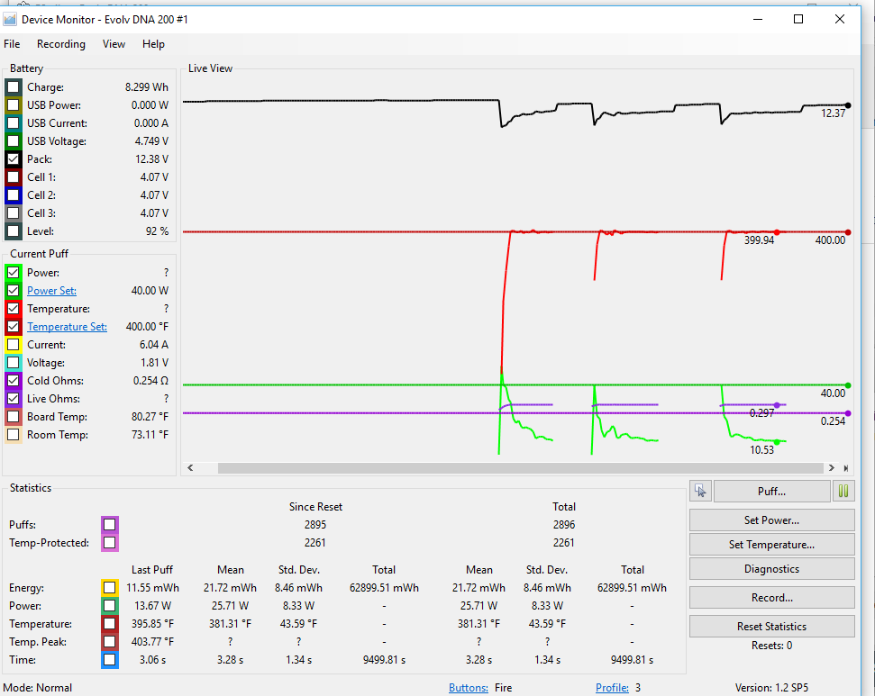

Wayneo Posted December 24, 2017 Report Posted December 24, 2017 (edited) 12 minutes ago, denniz said: ... why doesn't the real-time temp graph show it hitting that peak temp Dunno, but it's very quick, and that's a pretty tiny screen. You should trust the hard numbers. Here's an alternate printscreen with the bump shown. Mod set for 440F, hit 444F. Edited December 24, 2017 by Wayneo
retird Posted December 24, 2017 Report Posted December 24, 2017 .The DNA regulates the temperature to a set temperature. (230C in your example). As the temp is met (at 230C) it may overshoot that temp a bit at which time it is regulated down to 230C. Depending on the coil build and other things it may regulate down (under 230F) at which time it will again try to reach 230C. So it is constantly monitoring and regulating. Case Analyzer helps by giving the most accurate calibration for temp readings. Your device is operating as it should.. To get a better look at what your device is doing you might check the following boxes in Device Monitor (see screenshot below I'm using a DNA200 device)). I use these to fine-tune the settings (such as pre-heat, punch, wattage and temp and to do things like monitoring the resistance change of the coil while heating and battery sag, and etc..)
denniz Posted December 24, 2017 Author Report Posted December 24, 2017 (edited) 2 hours ago, Wayneo said: Dunno, but it's very quick, and that's a pretty tiny screen. You should trust the hard numbers. Here's an alternate printscreen with the bump shown. Mod set for 440F, hit 444F. But the thing is the screenshot I posted is taken from Escribe, not from the mod itself. I also noticed another thing just now, I switched juice from 70VG/30PG to a 50VG/50PG juice and now the peak temp is less pronounced, it maxed out at 3C (37F) to 5C (41F) above the set temp at the same settings. That's far more to my liking then overshooting it by more then 10C (50F) like it did with the higher VG juice. Could it be a wicking problem? I find wicking for higher VG juices somewhat annoying, I also find that I have to set the temp higher for high VG juices, more higher then I would like. I would like at most 220C (428F) as the set temp, but for example for 80VG/20PG I often have to set it around 235C (455F) to 240C (464F) to get a satisfying vape. Edited December 24, 2017 by denniz

Wayneo Posted December 24, 2017 Report Posted December 24, 2017 Device Monitor -> View -> Set Time to like 5 seconds, the screen will be screaming fast. Take Vape. Pause screen and scroll backwards. Move your pointer around the vaping characteristics and it will show values.
retird Posted December 24, 2017 Report Posted December 24, 2017 2 hours ago, denniz said: I understand that the mod is constantly regulating, but overshooting the temp by more then 10C (50F), sometimes by 15C (59F), I find that a bit to much for my liking. The examples posted by you and Wayneo show much less pronounced peak temp spikes, like a couple of degrees Fahrenheit. While when using a higher VG juice (see my previous post) my mod is overshooting it far more then in your examples! I will run the case analyzer and then try again. I've not used any SS304 wire...... what difference in the temp control do you notice when you reduce the wattage to say 20 or 18 watts. Do you still get the same results as you first posted? The regulation I get is a result of tweaking the various settings to achieve the best results.... As the device regulates it has to react to reaching temp setting thus the device will always, for mili-seconds, overshoot temp setting as it reacts and starts to regulate... at least that's my experience... I have seen over-temp readings alot higher than yours and tweaking many things, such as the many settings available, the wire material, the CSV file configuration, the coil design, the wicking, and etc. .... all allow me to get it down to the lowest variance from set point.... If you want to check the boxes in Device Monitor as seen in my example and post a screenshot while you are vaping it may help us understand what your vape is doing....I'm thinkin' that a bit of tweaking will give you better results...
Wayneo Posted December 24, 2017 Report Posted December 24, 2017 3 hours ago, denniz said: it maxed out at 3C (37F) to 5C (41F) above the set temp at the same settings. That's far more to my liking then overshooting it by more then 10C (50F) like it did with the higher VG juice Sorry, but your numbers don't make sense, at all. Here's a much easier way, using your initial 230C printscreen, with your values quoted. 230C=446F 230+3=233C=451F 230+5=235C=455F 230+10=240C=464F Things are not as dismal as you may have thought. Your 3c was only 5f difference (similar to ours), and the worst case was 18F difference 5 hours ago, Wayneo said: .... on a subsequent vape, will get lower You probably saw the 3C difference after a vape or two.
