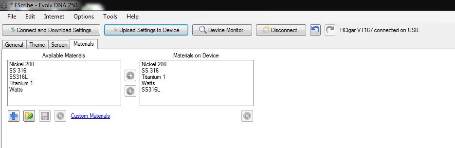

Hello guys, I need some help with my HCigar VT 167, I have just notice while vaping the temperature message reads just "OFF", the resistance stays at 0.24 ohms I'm using SS316L Fused claptons 26*3+38 4 wraps 2.5mm diameter inner core. I used the SS316L material profile from here. Thank you.

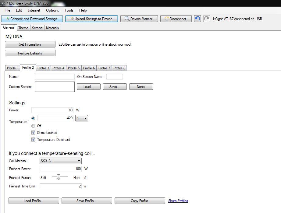

It's gotta be a connection issue ........... somewhere. Either in a dirty 510 or connector, or a loose 510 pin, or hotspots in your coil. Can you space (if it's a contact coil) slightly and retry? Even with just a single coil to prove to yourself it works.
And don't lock the ohms
And welcome :hand_splayed:
Edited by Wayneo
Don't lock the ohms in Profile 2

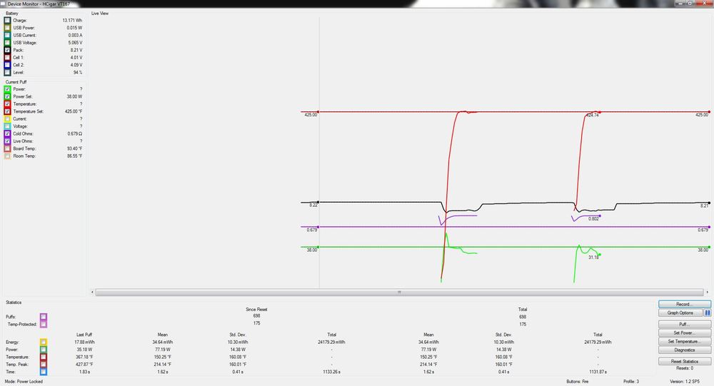

yes sir I just tried a .5 ohm ss316l 26awg tank and it works fine.
Edited by rONin
attached screenshot

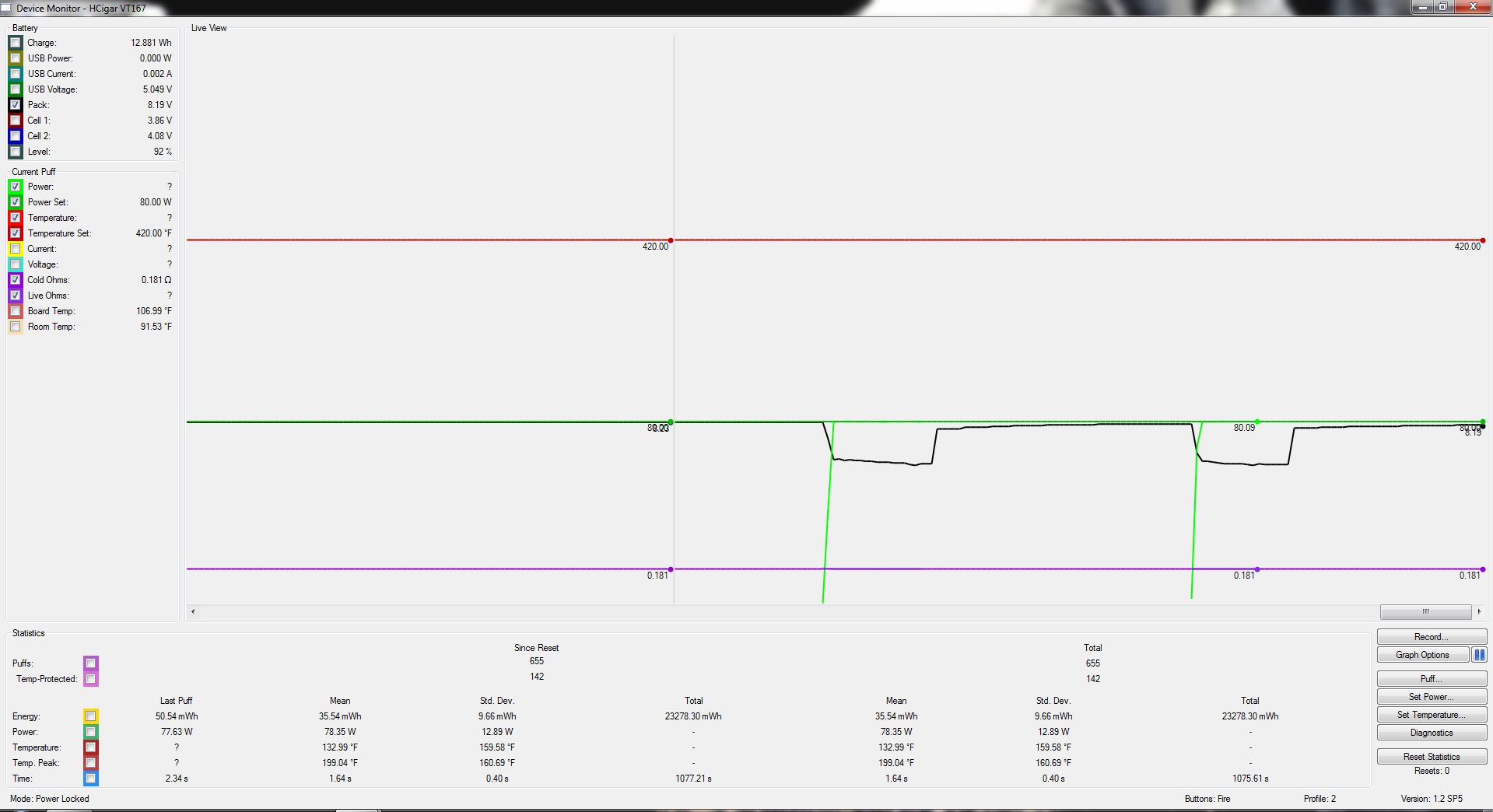

I use spaced coils sir, I lowered the power and used the default profile and this is what I have. Is this working right? I also don't dry burn SS316L as I have heard that it could be dangerous.
Edited by rONin
additional info
1 minute ago, rONin said:
.......... Is this working right?
Unfortunately, no it's not working right. If you look at this graph, that pinkish line, your cold ohms is a solid line (good), but you don't see the live ohms line raising (like you do in the prior .5 printscreen) well a rise of .003 is not enough. Is it at ambient/room temperature? Go use that .5 coil for a bit, and come back to this one. The initial settings looked fine, don't change anything during troubleshooting as it changes your known state.

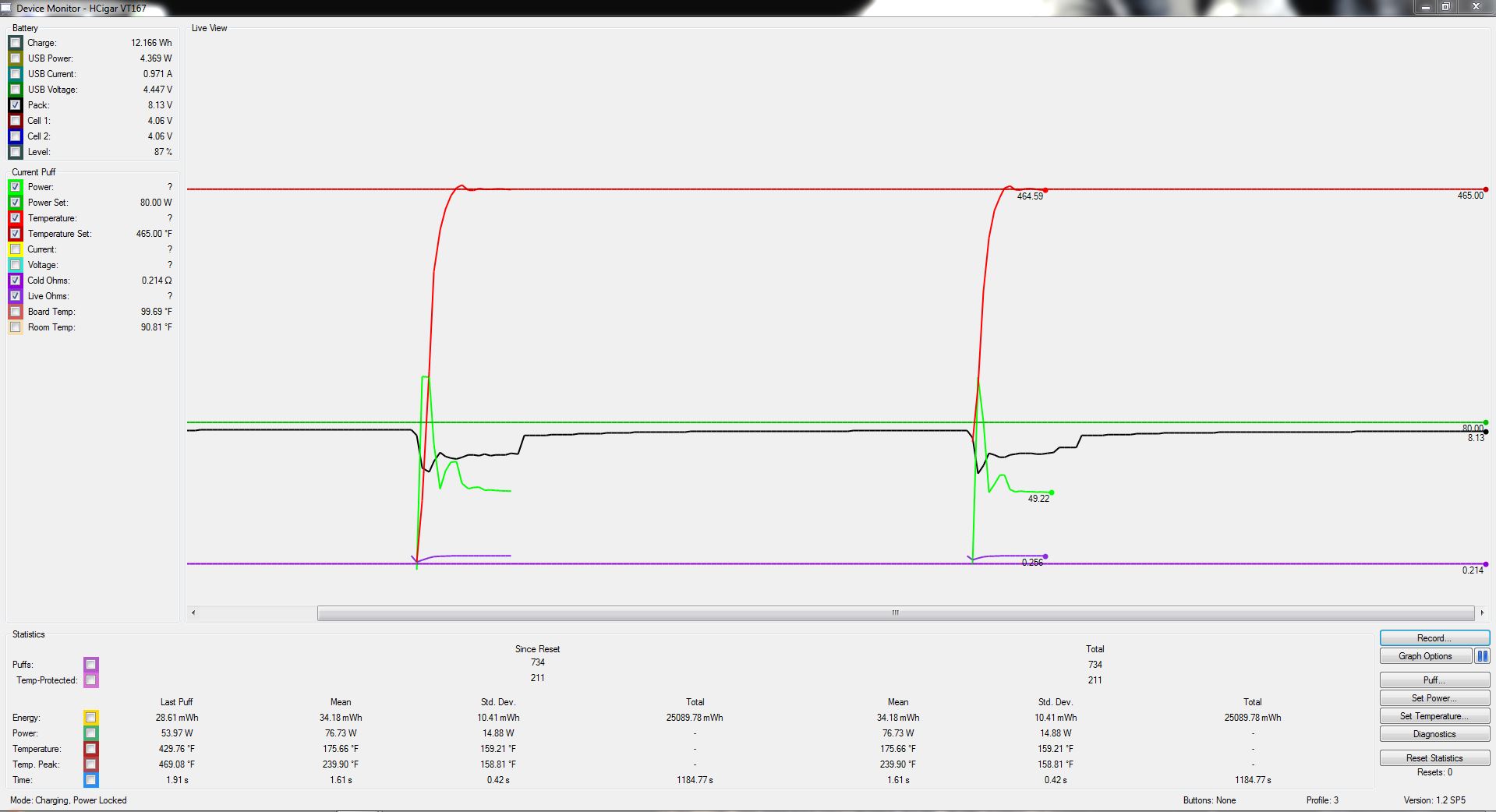

Here sir I used a coil master ss316L 26 awg round wire on the RDA.
Edited by rONin

I can understand that. At this point we're down to your wire in the fused clapton, or your build that's the issue. IF YOU built that clapton with the same wire in your latest Printscreen, it should work as well as the Printscreen with simple wire.
I notice you also went and increased the watts in this Printscreen, without telling us of any other changes.
I'm sorry Sir about not telling you about the change in power, I assumed that I had to change the wattage from using a round wire to a fused clapton. I didn't make the wire, I bought it from here.

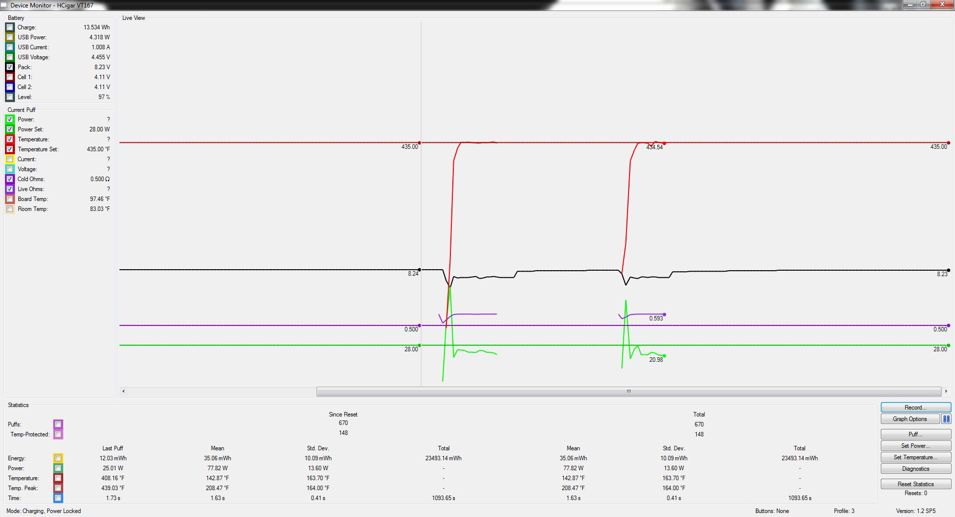

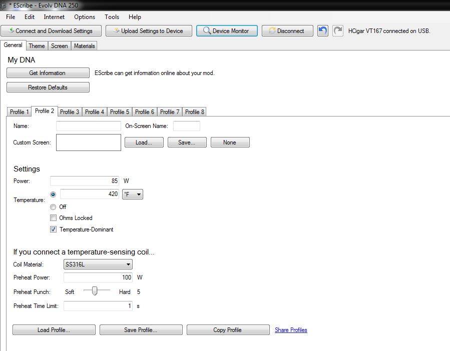

I have this screenshot after I had rested the coil for a few minutes and locked the resistance, I also changed the Temperature and the wattage.
Hey Ronin, we were all new once, no worries :relaxed:
"I assumed that I had to change the wattage from using a round wire to a fused clapton" <- Typically yes.
I have used that "Demon Killer" and had to fudge my TCR in order for it to work for their "316 Notch" coils.
"I tried another wire with 2 cores, at first the vape was hot yet the temperature doesn't reach the set temperature. I removed the wick and I pulsed it red to check. Then rewicked it." <- We'd need more details on that 2 core wire. With SS you only need a dull glow to Red. I glow all my SS to Red from 10-25watts, spaced, contact, plain, or fused.
"I should maybe dry fire the fused claptons?" <- If you mean pulse, I do with every coil, every wire type.
"after I had rested the coil for a few minutes and locked the resistance, I also changed the Temperature and the wattage." <- Great Printscreen showing it working again. :thumb:What wire was that? Single, dual or triple core.
For the 2nd time, You only need to lock the resistance if you have a wonky atomizer, or build. By locking the resistance, you defeat/disable 'refinement' which is the Evolv magic sauce. Page 7 of the Datasheet. This is one of the best Temperature guessing boards on the market.
I've read from somewhere or heard from here @ 23:44 to lock the resistance so I assumed it is the proper way. Anyway, I'll leave it unlocked from now on.

If you go watch that video again, you only took away what you wanted to hear. He said for accuracy don't lock. If you want consistency because you're getting blown out ... lock. I'd say fix your build. He also mentioned 'refinement'. I only needed to lock for 1 atty ever.
