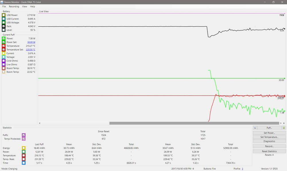

Hello, first time poster here. As the title states, I'm experiencing a weak vape with my ISub SS 0.5 ohm coils. I tried setting the resistance when the coil was at room temp and it read under 0.5. Then I dialed in my wattage. Net result is almost no vapor even when I set the temperature or wattage very high. I tried to manually dial in the resistance to 5.3 and got a better vape but still weak. What's going on here? Thanks in advance.
I'm almost tempted to spend fifty bucks and  buy an Innokin tc device to see if their mod can drive the coil properly. It's a nice coil in wattage mode, very similar to the Clapton. I can singe the coil if I chain hard for three or more hard pulls in a row and I was hoping the evolv could save me a coil here or there while giving a nice vape. Maybe I'm saving the cotton but I'm not getting near the quality of vape I was expecting. Way too cool and thin in TC even at high temperatures and wattages and I'm someone who happily vapes at a modest 30 watts and likes a coolish vapor. I think the resistance is not correlating accurately to the temperature of the coil. There, I said it. Any suggestions would be appreciated and thanks to those who have already posted.

I've not used the coil you are vaping.....  I ponder why your wattage in temp mode levels out at about 7.5 watts when it reaches 220C temp..... it shows reaching the set temp and holding the temp.  I'm wondering if that coil is a vertical coil with one leg longer than the other.  I ran across a vertical coil a while back that was supposed to work in temp mode but it was a weak vape and never vaped like all my other temp sensing coils but it worked good in wattage (power) mode......
From your posts I gather you have no other temp device to try this coil on and it is your first temp coil.

It's reaching temp according to Device Monitor... OEM coils can cause these issues
