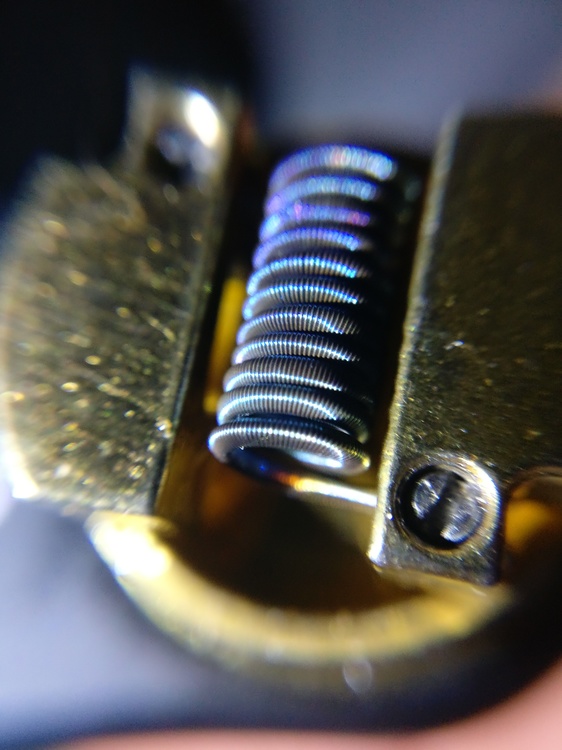

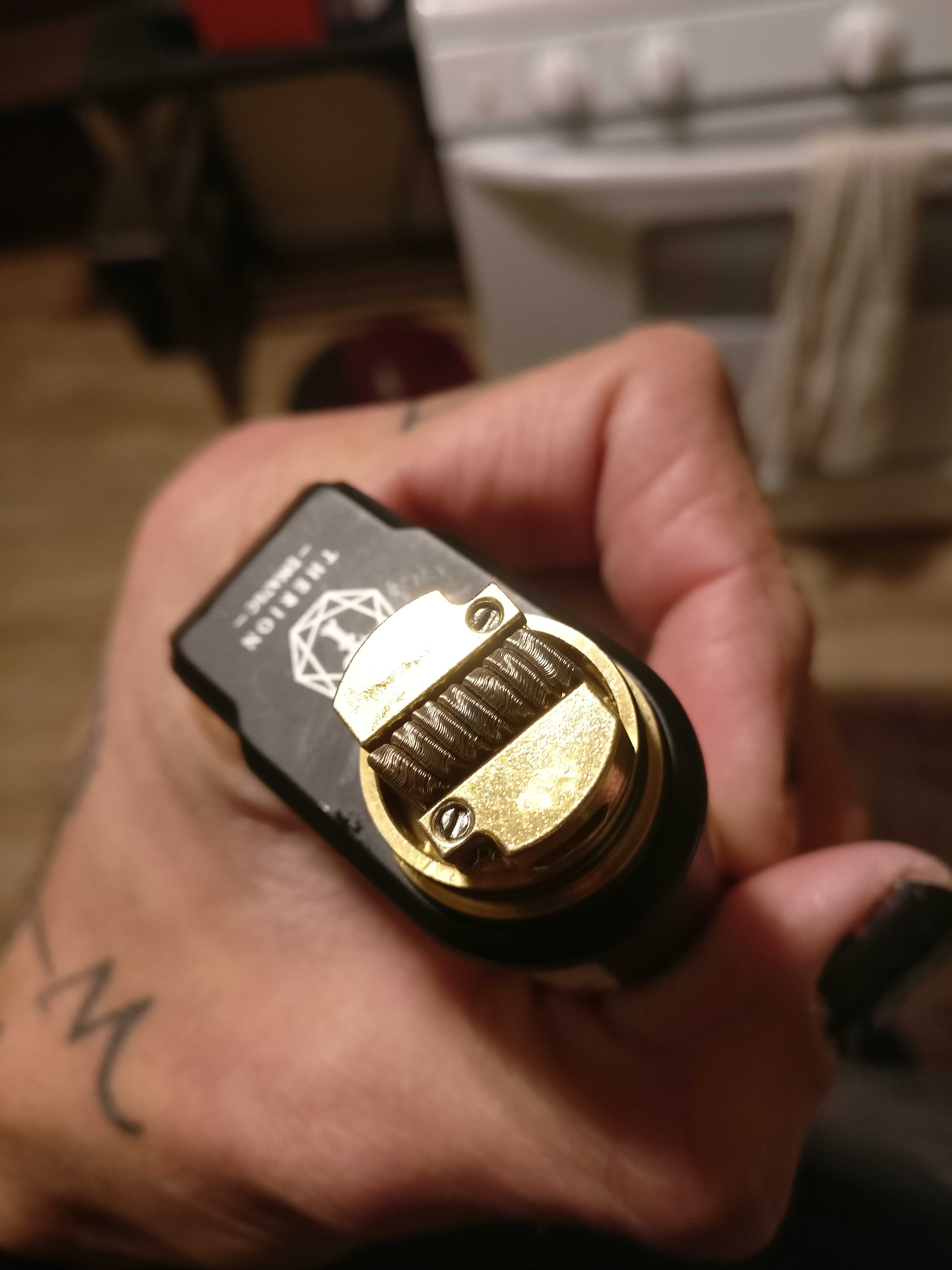

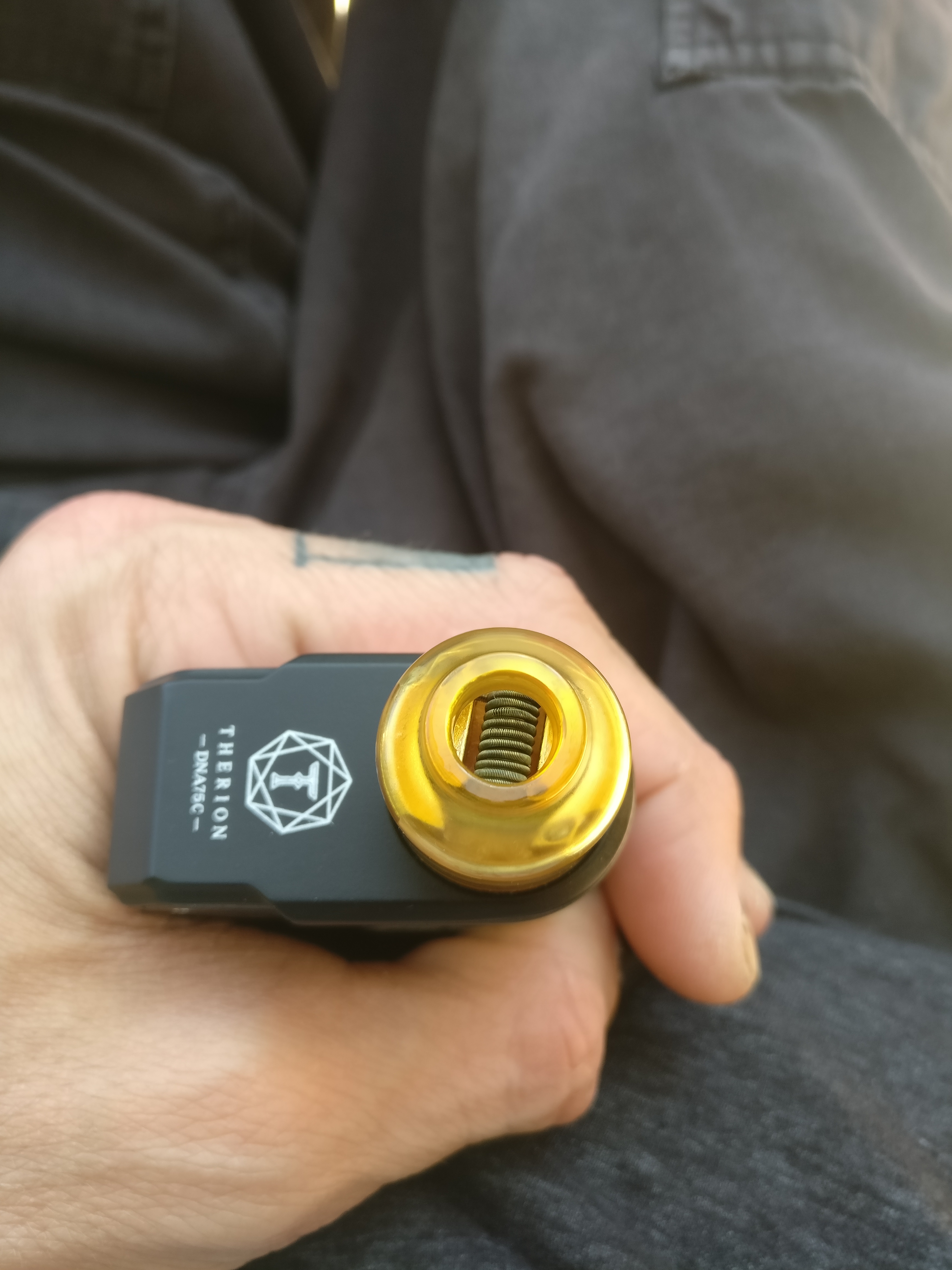

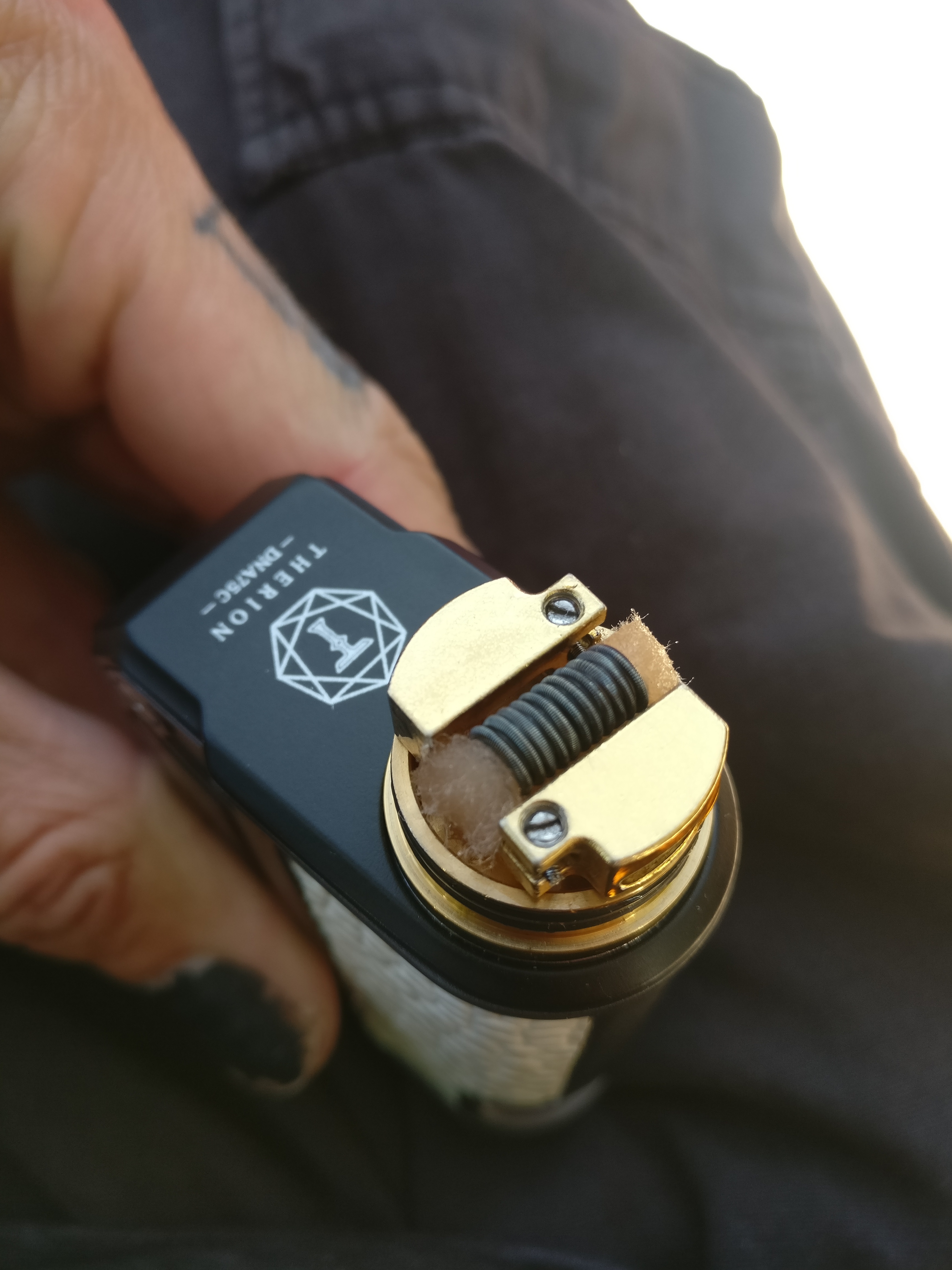

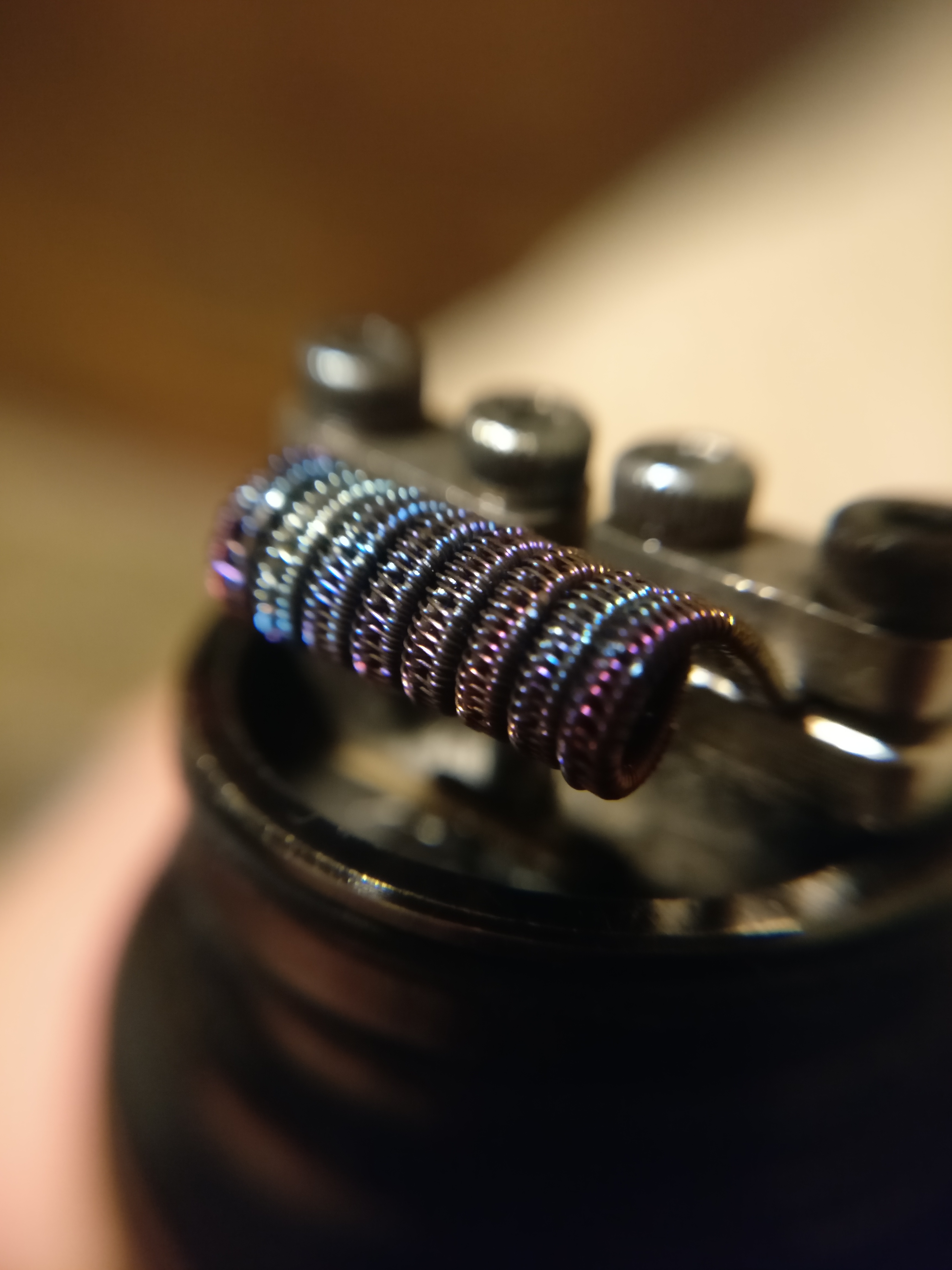

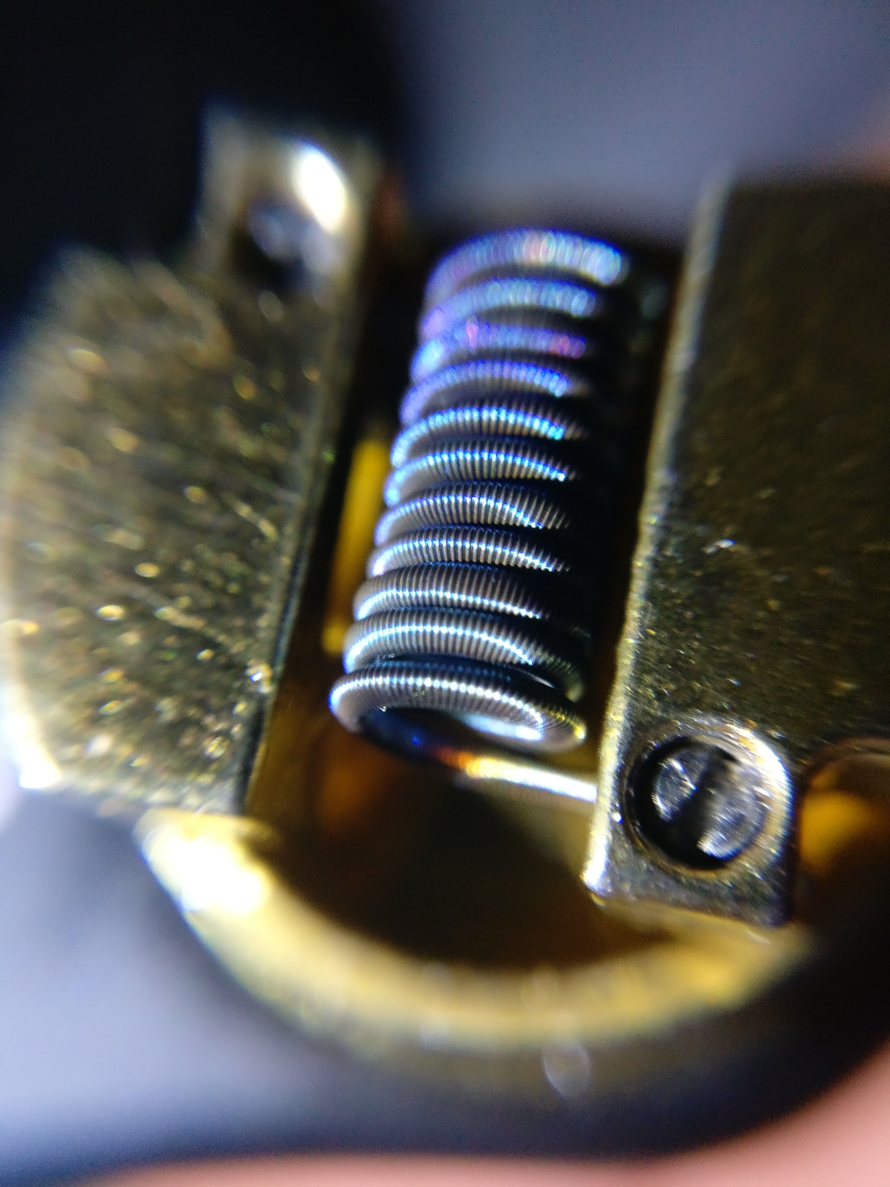

Sure. The atomizer is a single coil 22mm called the Oumier Wasp Nano. Excellent atty btw. Build is all 316l. 3x25g cores, 36g alien wrap. 3mm, 7 wrap. 0.14ohms
Second atty is a goon v1.5 clone.
The build is a Staggered Fused Clapton. Two cores, spaced clapton wrap, parallel and fused together with the same wire used to clapton the cores. All wire is 316l. 2x24g cores, clapton'd with 36g. Fused with 36g. 3mm, 8 wrap, 0.14ohms
Both exhibit the same problem. Is it possible that I'm building too low? I haven't looked at the restrictions on the mod but I would be surprised to hear that it can't properly fire these builds.

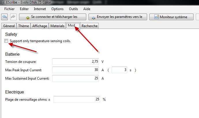

17 minutes ago, EGO 13 said:
Hi this arrived to one of my vt75  ...I had rhe same problème with ss316, titanium ,ect .
I just desactived the Control TC via Escribe ... And now evrything is ok . lol. :)
That's a bit extreme for me! Nah I'll continue to monkey with it until I figure it out. :)
