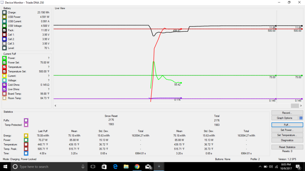

Wayneo Posted October 10, 2017 Report Posted October 10, 2017 (edited) Sweet, so now if your're in TC, fire up Device Monitor, and with the following clicked on the left hand side (while firing). You should notice your initial preheat spike, then the wattage required to maintain your 500F. If you post a printscreen of the entire screen while firing, I'll see what it'll take to get your watts up. Edited October 10, 2017 by Wayneo Added "while firing"
Req21 Posted October 10, 2017 Author Report Posted October 10, 2017 I had missed typed, its actually currently at 75w... this is a 4sec puff, is that enough?
Wayneo Posted October 10, 2017 Report Posted October 10, 2017 Yeah, perfect. Notice that green line shows it's about 55 watts to maintain that beautiful solid 500F. That number (55 watts) will change if you do a real not simulated puff. Can you do a real one, this time increase the temp to 550F, upload to mod. Another printscreen, just like this. OR, if you just like that 85 watts but with the benefit of TC (dry hit protection) and really want that 85 watts, there's 1 last/more thing.
Wayneo Posted October 10, 2017 Report Posted October 10, 2017 Now I'll just ramble for a bit. I don't know if you're concerned you're getting close to the 600F mark. IMHO it's just an artificial safety constraint set by Evolv. I mainly vape in the 390-440F range. Just the heat in my lungs. Is that a single 24/36 or more for your 2 coils? I was gonna run your build in steam-engine for an idea of your heat flux. TC is core wire/material dependant only. Not gauge, wraps, or diameter. It's all about the TCR/TFR. Simplest explanation for TC .... You're now vaping at a set resistance.
