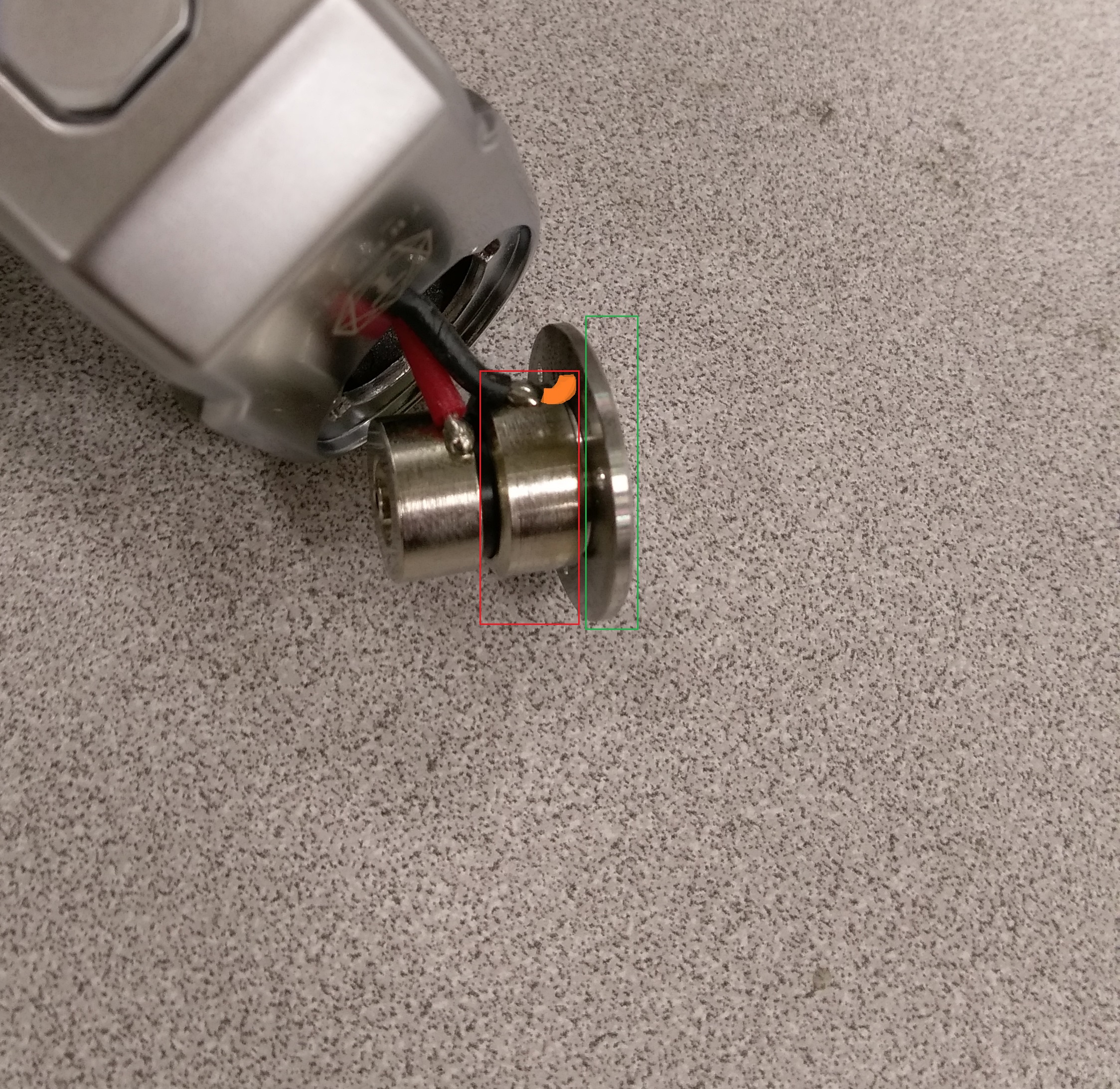

yes, if you remove the 3 T5 torx screw that hold the 510 onto the frame, you should have enough room to tighten the 510 or solder the ground solid.
I have attached a picture to help show what to do.
in the picture, either tighten the piece outlined in red to the piece outlined in green. OR make a solder bridge like the orange (some good flux will be needed to be able to get the solder to stick to the stainless.
thanks for the help will need to get a t5 bit and will do as you have sown in pic

You're very welcome. It should fix your issue, every one of these mods I see reading too high, this fixes it. I for some reason it doesn't open a ticket with Evolv
