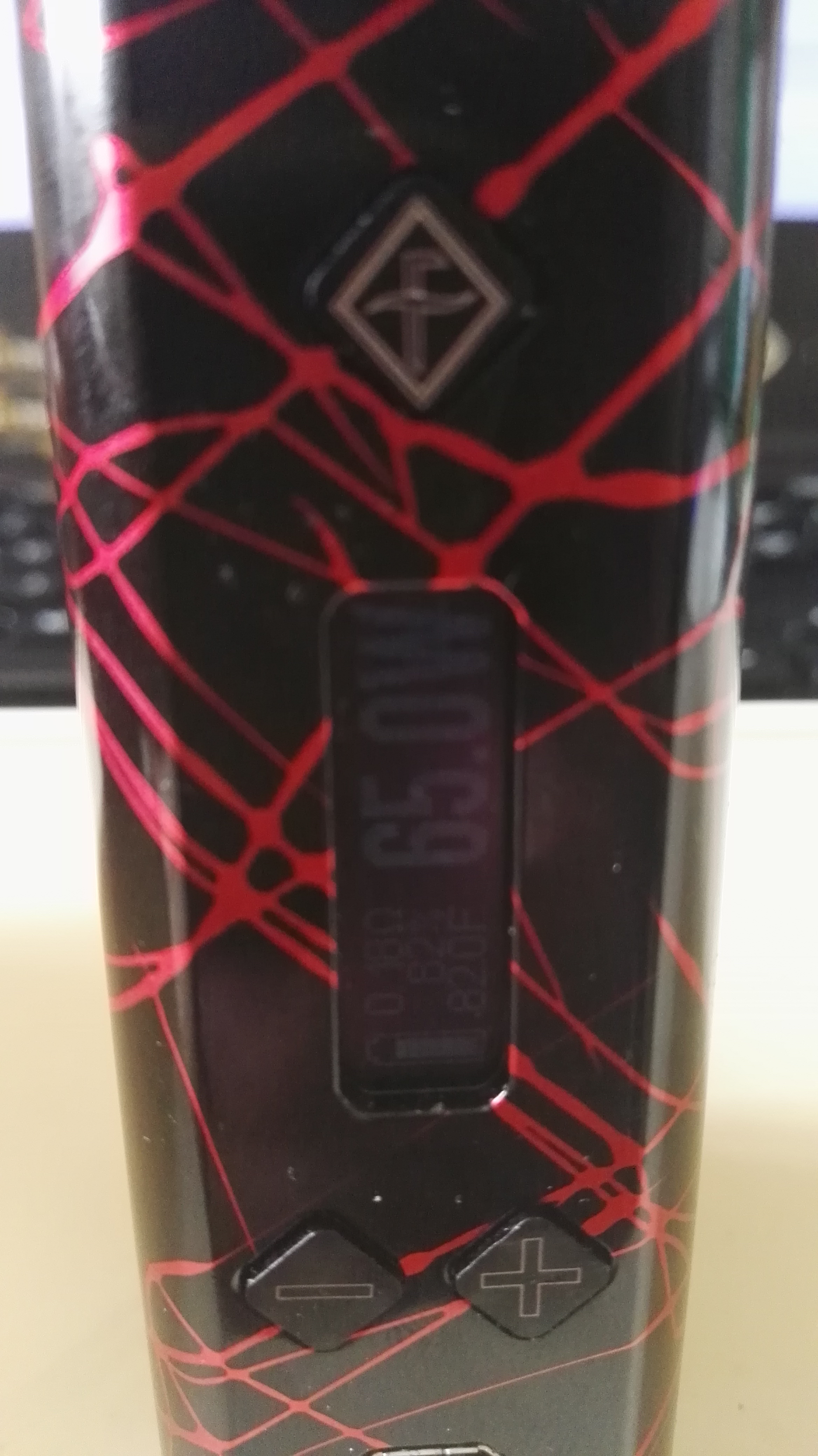

Tugnick Posted September 6, 2017 Report Share Posted September 6, 2017 Hello, even configured 100% all brightness settings, the screen light seems very darkly no matter what i do, only way to see 100% like i set it is random when press fire. Every suggestion will appreciate, Ty. Link to comment Share on other sites More sharing options...

dwcraig1 Posted September 6, 2017 Report Share Posted September 6, 2017 Very possible a case where the screens ribbon got pinched between the fire button and switch. Just a guess. Link to comment Share on other sites More sharing options...
Lowbytes Posted September 6, 2017 Report Share Posted September 6, 2017 On 9/6/2017 at 5:12 PM, dwcraig1 said: Very possible a case where the screens ribbon got pinched between the fire button and switch. Just a guess. Expand Broken ribbon cable - my guess too! Link to comment Share on other sites More sharing options...

VapingBad Posted September 6, 2017 Report Share Posted September 6, 2017 If you can get to the board you can probably change the screen yourself, just bend the screen cable to keep clear of the fire button (not hard fold and not right next to the glass, fold on a credit card or thin wire). Link to comment Share on other sites More sharing options...

Tugnick Posted September 12, 2017 Author Report Share Posted September 12, 2017 Fast update, From last warranty check, my dealer specialist found the screen broke and they refund me with a new one, so thanks a lot for your support and for now i think for seniors you can close, Thanks Folks 1 Link to comment Share on other sites More sharing options...
