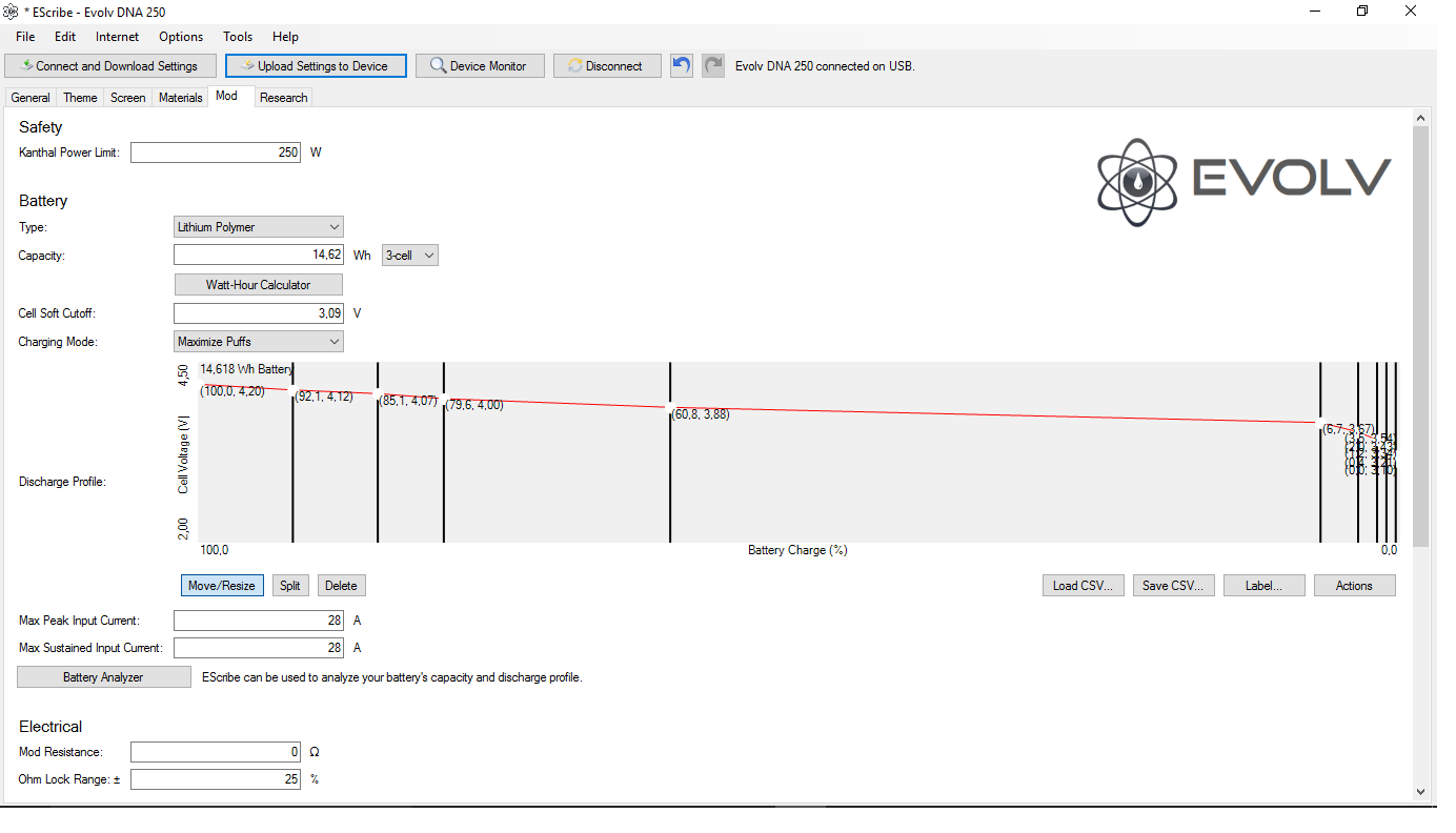

Dynamic Knight Posted September 3, 2017 Report Posted September 3, 2017 Hello everyone, I got this issue with my vtbox250 by VapeCige: when the box is fully charged the battery percentage on the screen drops dramatically after every puff. I don't believe the percentage shown reflects the true battery level, still it is quite annoying as it represents the only minor issue of an otherwise exquisite box. I believe it might have something to do with the wh parameter, so I attached what I see in eScribe. Thank you all for your help
VapingBad Posted September 3, 2017 Report Posted September 3, 2017 The settings look OK, it's the default battery curve from Evolv. I suspect there is a connection issue causing it to see a large voltage sag under load, you should be able to see that in device monitor. I don't know the internals of that mod so can't give specific advice on where to look.
Dynamic Knight Posted September 3, 2017 Author Report Posted September 3, 2017 45 minuti fa, VapingBad ha scritto: The settings look OK, it's the default battery curve from Evolv. I suspect there is a connection issue causing it to see a large voltage sag under load, you should be able to see that in device monitor. I don't know the internals of that mod so can't give specific advice on where to look. Thank you, do you think I should run a battery analyzer?
Lowbytes Posted September 3, 2017 Report Posted September 3, 2017 Only 9 Wh ? Mod Resistance 0 Ohm ? Can you send a screenshot of device monitor? 1

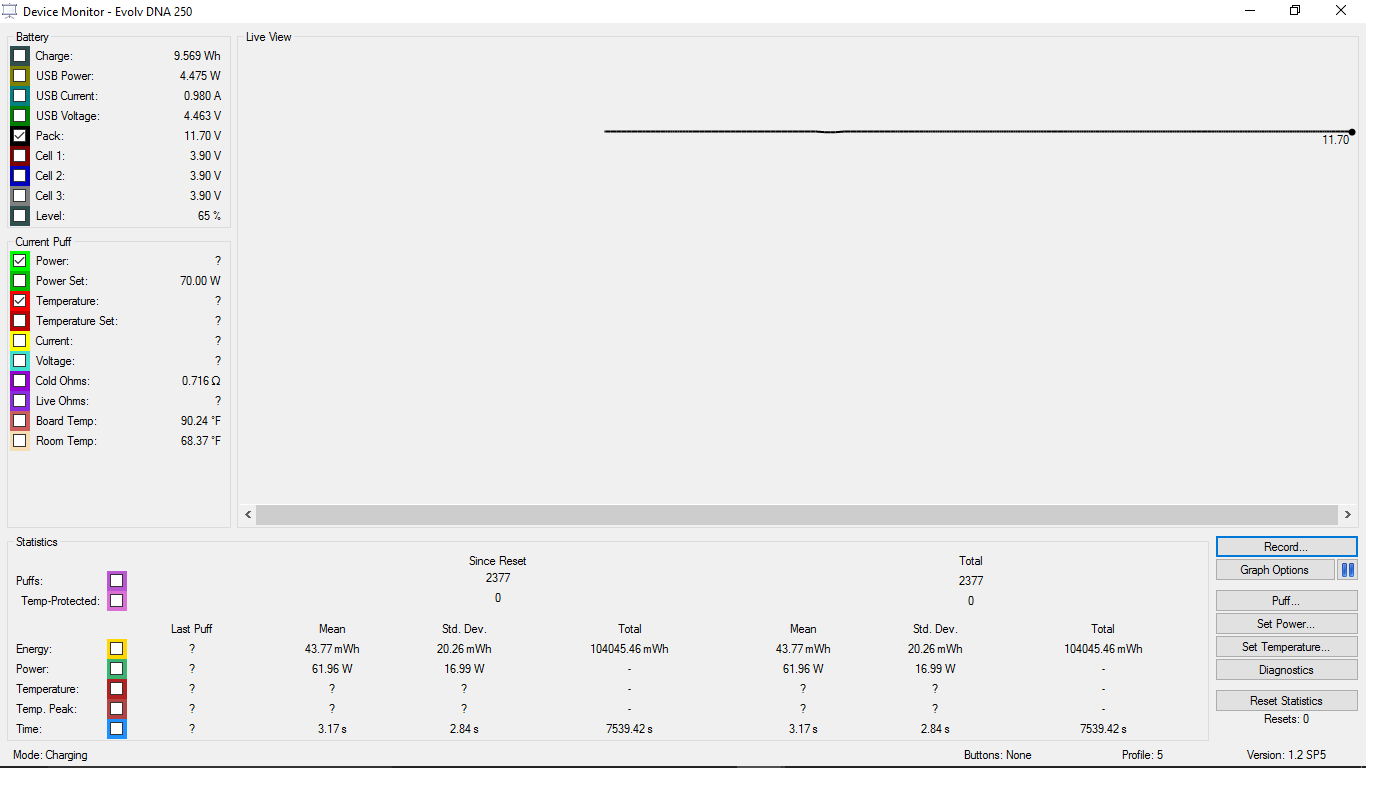

Dynamic Knight Posted September 3, 2017 Author Report Posted September 3, 2017 (edited) Good morning Lowbytes, I've just run a battery analyzer and this is the screenshot. Now the wh is around 14. I'm attaching a screenshot of the device monitor too, the box is now charging. Thank you Edited September 3, 2017 by Dynamic Knight
dwcraig1 Posted September 3, 2017 Report Posted September 3, 2017 A screen showing sag while firing would be most helpful. (pack)

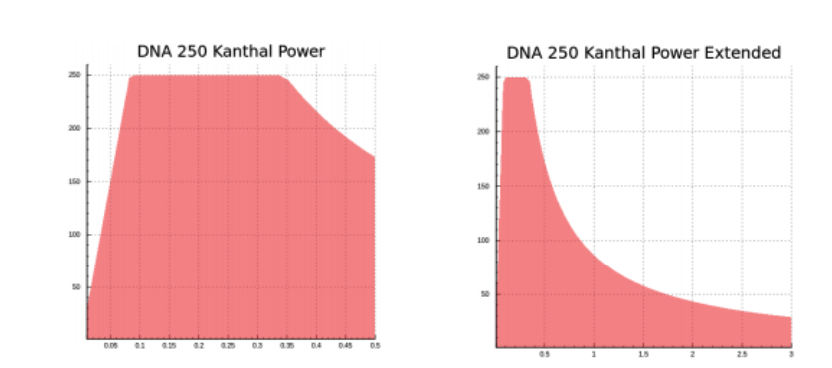

Lowbytes Posted September 3, 2017 Report Posted September 3, 2017 First of all - you are a bit high in impedance of your coil - YES the DNA is capable to drive 0,716 Ohms - but of course the chip is mainly designed for Temperatur Controlled vaping You´ll have best results in between 0,1 to 0,5 Ohms - see attaches graph of the output in function of resistance ......... Your setup will consume abt. 10 amps 0,716 Ohms 70 Watts 7,08 Volts 10 Amps 1
Dynamic Knight Posted September 3, 2017 Author Report Posted September 3, 2017 1 ora fa, Lowbytes ha scritto: First of all - you are a bit high in impedance of your coil - YES the DNA is capable to drive 0,716 Ohms - but of course the chip is mainly designed for Temperatur Controlled vaping You´ll have best results in between 0,1 to 0,5 Ohms - see attaches graph of the output in function of resistance ......... Your setup will consume abt. 10 amps 0,716 Ohms 70 Watts 7,08 Volts 10 Amps Thank you. Yeah, I usually stay around 0.3, you are right. Well, now the battery is fully charged and the wh went from 9 to 14.7 after the battery analyzer so I hope I've managed to fix it. I will let you know if anything doesn't work propertly. Thank you very much, you've been clear and helpful.
