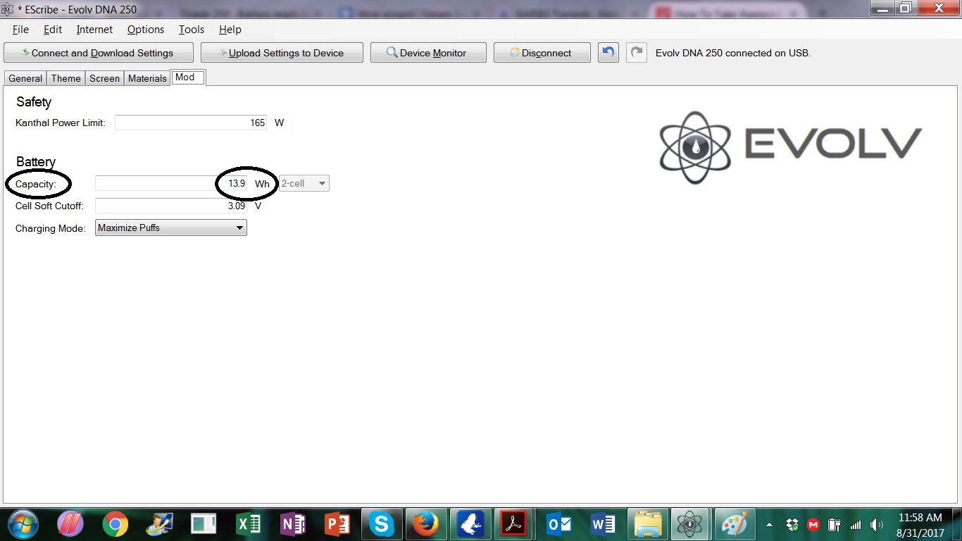

dwcraig1 Posted August 28, 2017 Report Posted August 28, 2017 Try dropping the watt hours shown in the Mod section of Escribe by 15% and wait awhile. 1

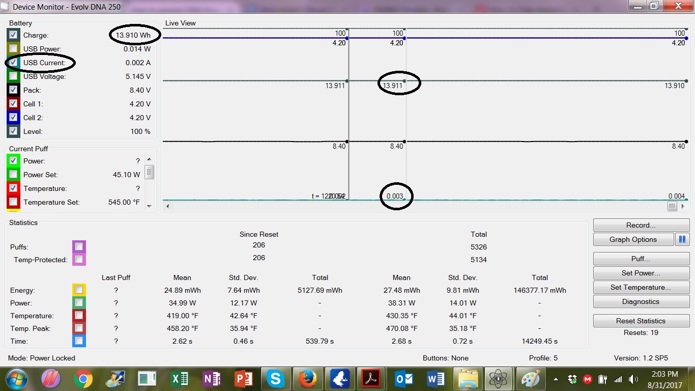

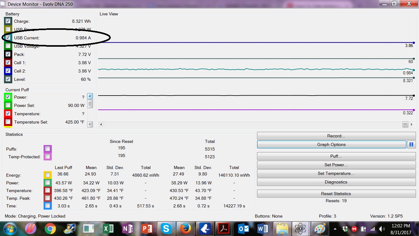

Geoff Posted August 30, 2017 Report Posted August 30, 2017 Yes- you must Monitor your batteries with Device Monitor and note the Wh rating is when the charge current drops to just about 0 mA. For my old but still good 25R's the WH reading is ~13.9. 1

Geoff Posted August 30, 2017 Report Posted August 30, 2017 Hi Again dleone32. I have a Drone- so only two batteries to deal with- your Mod has three- still use escribe to monitor the charge current in the Device Monitor Tab of escribe.

Geoff Posted August 31, 2017 Report Posted August 31, 2017 Her are a couple Screenshots of what to look for.
