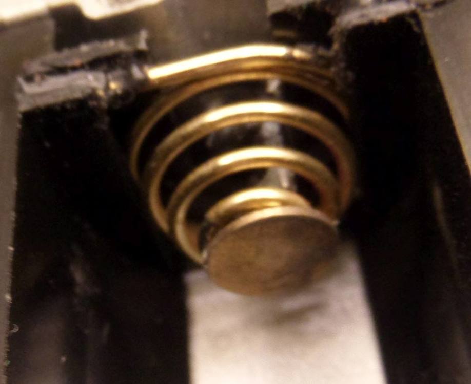

Lowbytes Posted August 21, 2017 Report Share Posted August 21, 2017 vor 2 Minuten schrieb dwcraig1: That style of contacts is fine for toys and low amp draw flashlights and such but not a high amp device like a DNA200 Well said sir ! 2 Link to comment Share on other sites More sharing options...
dwcraig1 Posted August 21, 2017 Report Share Posted August 21, 2017 This modification works well when using a coil spring (they in earlier times worked good enough at lower amps) Factory done below. The wire is soldered to the disc.(braided wire) Link to comment Share on other sites More sharing options...
EDMKEV Posted August 21, 2017 Author Report Share Posted August 21, 2017 I bent the conact up a decent amount, couldnt quite fit anything in underneath yet but i wanna test it out first a few times and see if it is indeed just a battery contact issue, everything else doesnt make much sense besides not having a good connection, ill try and see maybe i might get a buddy to find something better to solder to it but for the price i cant believe what shitty contacts they use..that spring contact seems much better! What mod did you do that in? Ill have to see if a friend can solder something like that together and make it fit, but for now ill see if i get better battery life with the better bent contacts and update. Link to comment Share on other sites More sharing options...
dwcraig1 Posted August 21, 2017 Report Share Posted August 21, 2017 IPV2, but can be found in many others. Escribe will show your battery sag....for better or... Oh, I didn't do that, it was factory. I did solder the wire on the end of the spring where it contacts the batter on the last one I built (it came with the springs) Link to comment Share on other sites More sharing options...
Lowbytes Posted August 21, 2017 Report Share Posted August 21, 2017 vor 2 Stunden schrieb EDMKEV: I bent the conact up a decent amount, couldnt quite fit anything in underneath yet but i wanna test it out first a few times and see if it is indeed just a battery contact issue, everything else doesnt make much sense besides not having a good connection, ill try and see maybe i might get a buddy to find something better to solder to it but for the price i cant believe what shitty contacts they use..that spring contact seems much better! What mod did you do that in? Ill have to see if a friend can solder something like that together and make it fit, but for now ill see if i get better battery life with the better bent contacts and update. We already did the same (german community) - bend the contacts and filled up the gaps in between the contacts with foam rubber - with great results - But to say it clear - best way would be to exchange the shitty contacts! Mine (boxer DNA133 - self made kit) working pretty fine in TC Mode - down to 3 Percent of batt power! 2 Link to comment Share on other sites More sharing options...
