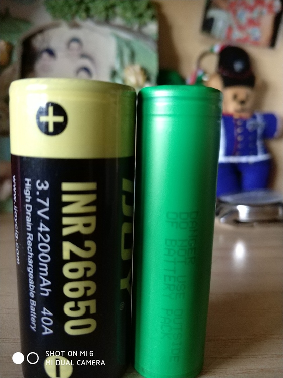

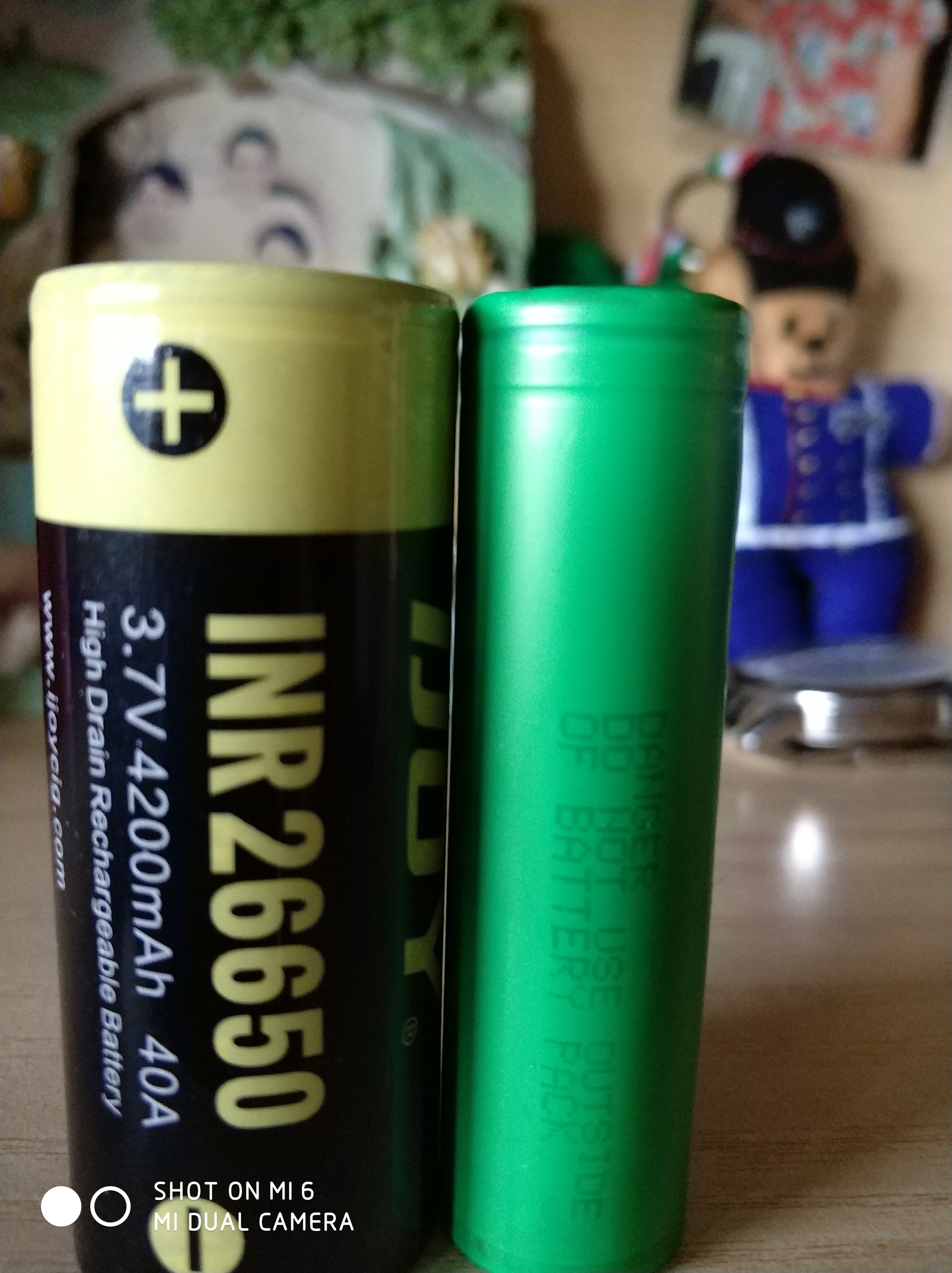

Fresh84 Posted October 28, 2017 Report Share Posted October 28, 2017 Hi, guys i have ijoy 26650 lenght 65.11 i have a problem with box or is all ok?? Sorry my english.... Link to comment Share on other sites More sharing options...

Tubbyengineer Posted October 28, 2017 Report Share Posted October 28, 2017 On 04/10/2017 at 4:54 AM, Opanos said: I am sure that you missed the point that the battery cup it was not all the way screwed. So, for what over-tightening are you talking about? Take a look at the first page photos, especially the one that has a close up to the bottom cup, before your conclusion is that this is a user error... Then come again and edit your post... Even IF this is the case, the design and implementation, MUST preventing that "over-tightening" by giving a little more space to the battery compartment. It's more to do with the fact that there are cells out there that are over the 65mm length - if you design something to take a cell of 65mm length then it takes 65mm length. If a company then markets a cell as 65mm long (ie - a 26650 cell) but it's actual physical dimension is 67.2mm then who is wrong? the company who makes the device or the company who makes a cell that doesnt even conform to the size it's marketed as? Giving some extra space is fine, and has been accomodated in the design, but if a cell is so far out of spec then you'll get problems - whether it's the cap not sitting flush due to the extra length, or damage caused because someone tried to force the cap to sit flush when using an extra long cell. Link to comment Share on other sites More sharing options...
Fresh84 Posted October 28, 2017 Report Share Posted October 28, 2017 Hi, now i comparision with Sony vtc6 and ijoy 4200 26650...the size its equal... 65mm... Link to comment Share on other sites More sharing options...

Tubbyengineer Posted October 28, 2017 Report Share Posted October 28, 2017 5 hours ago, Fresh84 said: Yep very good - that ones the right size, now have a look at this pic - with several "26650" cells side by side (You can ignore the one 26500) Link to comment Share on other sites More sharing options...
