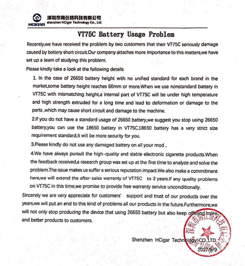

Lowbytes Posted August 9, 2017 Report Share Posted August 9, 2017 Statement from HCIGAR 1 Link to comment Share on other sites More sharing options...
Vapingwithcnote Posted August 9, 2017 Report Share Posted August 9, 2017 2 minutes ago, Lowbytes said: Statement from HCIGAR I've had mine get hot using an awt 26650 yellow battery and it made the yellow battery unusable in any other mod. Should I return my vt75c where I bought it from and get a refund? Link to comment Share on other sites More sharing options...
Lowbytes Posted August 9, 2017 Report Share Posted August 9, 2017 @Vapingwithcnote If your 26650 will not be more than 65,x mm of height you should be fine with the Hcigar - 18650 are 65mm - so any 26650 with the height of 65mm will be fine! It´s up to you to be aware to use 26650 or not - to take the mod or to replace it! I´ll go on using it with 18650! Link to comment Share on other sites More sharing options...

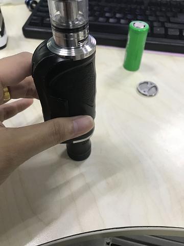

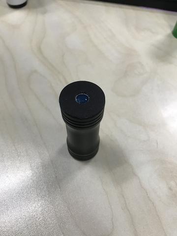

DNA Papst Posted August 10, 2017 Author Report Share Posted August 10, 2017 Here now better pictures from the mod. and Mooch have an new statement about the problem: Mooch WARNING: I recommend not using your HCigar VT75C...at all. I posted earlier (now deleted) about HCigar's warning not to use 26650's that were "too long", i.e., ones they didn't bother to test the device with. I recommended only using shorter 26650's and mentioned a few that I measured as being shorter than most. I've thought about it some more and have decided that I must recommend not using this device at all. Using a 26650 that is "too long" can lead to a short-circuiting of the battery, possibly causing it to burst. This is an unacceptable design flaw followed by completely inadequate testing by HCigar. What kind of company doesn't try out a variety of 26650's when creating a 26650 mod? Here's HCigar's statement regarding this problem: https://imgur.com/a/aK2q0 Some posts and a video about this problem, posted to my previous thread... From Milen Cholaski: https://forum.evolvapor.com/topic/68961-vtc-75c-warning/ From Milen Cholaski: https://www.youtube.com/watch?v=CH2bVu_YUL0 Not knowing what length any 26650 could be, and the possibly very serious consequences of this mod's defect, has led me to recommend not using this mod at all and speaking to HCigar about your options. If you do decide to use it I strongly recommend only using 18650's, very carefully. I realize that many of you have had no problems using 26650's in this device. But the risk remains and I must stand by my recommendation. Each person can make their own decision regarding this risk and I fully respect their decision. Link to comment Share on other sites More sharing options...
timbuc2dan Posted August 10, 2017 Report Share Posted August 10, 2017 I received a reply from Evolv recommending using only the 18650's and do not use any 26650 batteries at all. Glad I read this since I've got 2 of these 26650's on the way to me so will be returning them. A seriously major problem here for HCigar and anyone who doesn't know about this issue so spread the word please. I've only been using mine with the 18650's with no issues, doesn't get hot at all and I vape all day. I'm really happy with this mod, I've got it in blue and most online pics don't do it justice, the blue is really a nice deep blue with gloss like a car has, using an old Vaporesso Target tank in wattage mode but will be trying a Sense Blazer 200 soon so I haven't tried the online software yet, a lot of serious vapers recommend it. I'd still say buy this especially if you aren't into temp mode or don't need to make clouds, my e-liquid is 70/30 and the mtl is great with plenty enough vapor and flavor. At least some good can come out of this and that's a really good example of just how careful we need to be using Li ion batteries in any device. I think manufacturers need to start telling us exactly which size batteries with voltage and mah and A listed in the instruction manuals and online. I also think the device software should have atomizer coil type, temperature and battery recognition built into it especially since they are making mods that use up to 3 batteries now that reach ridiculously high temps. Seriously folks, how huge do you need your vapor clouds to be and why, what's next, battery banks you wear on your waist wired to the mod? For me it was all about quitting cigarettes, e-cigs allowed me to just stop cigs and start vaping same day, never went back. So stay safe and keep on vapin'. Thank you HCigar for such a fine mod! Link to comment Share on other sites More sharing options...

Opanos Posted August 14, 2017 Report Share Posted August 14, 2017 This the answer from HCigar to my email asking them to recall and replace all the VT75C devises "hello dear We noticed this problem, due to the size of the market 26650 battery is not standard, the use of non-standard battery caused by short problems, We already upgrade it, we will send you a small accessories, you only need to install this small accessories, will solve all problems;, you will be able to use any type of 26650 battery, you can temporarily use the 18650 battery. Please give me your address and phone number, so we can send you the parts." 1 Link to comment Share on other sites More sharing options...
Lowbytes Posted August 15, 2017 Report Share Posted August 15, 2017 vor 22 Stunden schrieb Opanos: This the answer from HCigar to my email asking them to recall and replace all the VT75C devises "hello dear We noticed this problem, due to the size of the market 26650 battery is not standard, the use of non-standard battery caused by short problems, We already upgrade it, we will send you a small accessories, you only need to install this small accessories, will solve all problems;, you will be able to use any type of 26650 battery, you can temporarily use the 18650 battery. Please give me your address and phone number, so we can send you the parts." So please - if they send you the parts, upload pictures of the parts here! I´m that interested........ Link to comment Share on other sites More sharing options...
Opanos Posted August 15, 2017 Report Share Posted August 15, 2017 They already send me photos of the "parts" In fact the "parts" is an insulator that they believe can protect the positive of their shitty device. I am done with HCigar. hello dear Very easy to operate, do not need to disassemble, as I sent to your picture operation, put the gasket on the 18650 battery tube, and then posted at the bottom of the positive. Without any additional cost, we will send to you free of charge. Best Regards 2017-08-14" Link to comment Share on other sites More sharing options...
