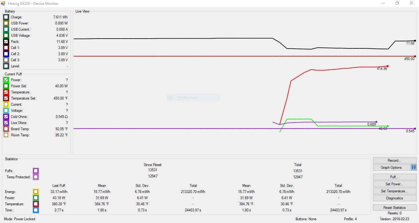

dwcraig1 Posted July 20, 2017 Report Share Posted July 20, 2017 A screen like this would be helpful: (SS430) 1 Link to comment Share on other sites More sharing options...

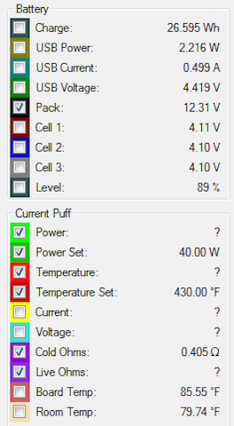

Abdul0786 Posted October 27, 2017 Report Share Posted October 27, 2017 Go to material tab and select your material as temp sensing , make a tick in the box in describe. Link to comment Share on other sites More sharing options...
