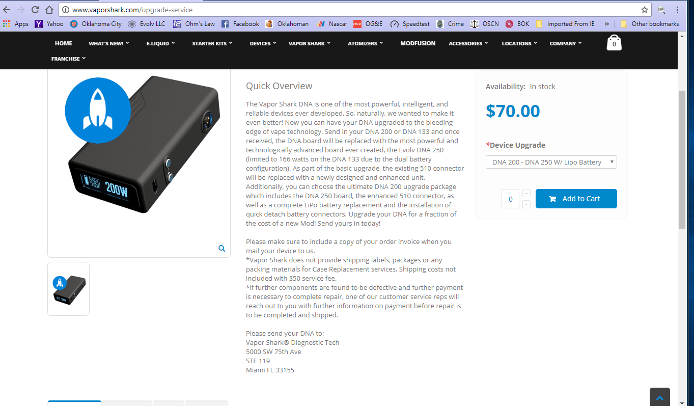

retird Posted June 9, 2017 Report Posted June 9, 2017 If memory serves me the Vaporshark does have a proprietary DNA200 board and what you are experiencing may be a board issue. Posters here over the years have experienced the same thing that you got.Your best option, I, guess, is to have a "modder" or repair facility look at it where you are located to determine the definitive issue (may be board related). You might want to contact customer service at Vapor shark also. They do offer the cheapest replacement cost converting their VS from 200 to a 250 board that I've seen. 70 dollars gets you new board, new 510 connector, and new battery (plus shipping).. I guess you could compare the cost of Vaporshark service and replacement including shipping to the total cost of local vendor replacement of the board plus their labor. 1
