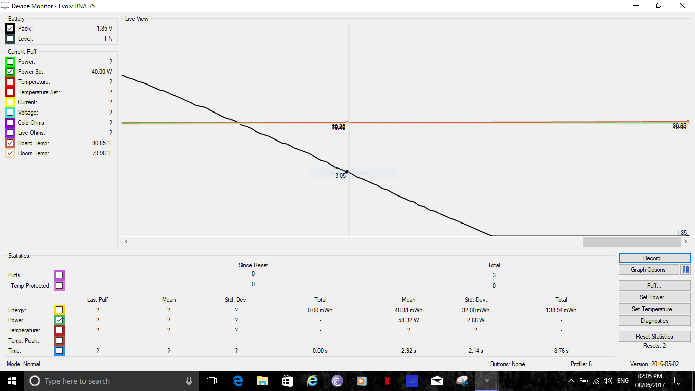

Hi peeps, just got my first dna 74 mod today (aimidi etaliens x3) ive put in fresh new batteries straight away (18650) mod says check battery. so far ive tried 6 other fully charged batteries and it still says the same thing. also downloaded the software from evolve and updated my mod but nothing seems to help.

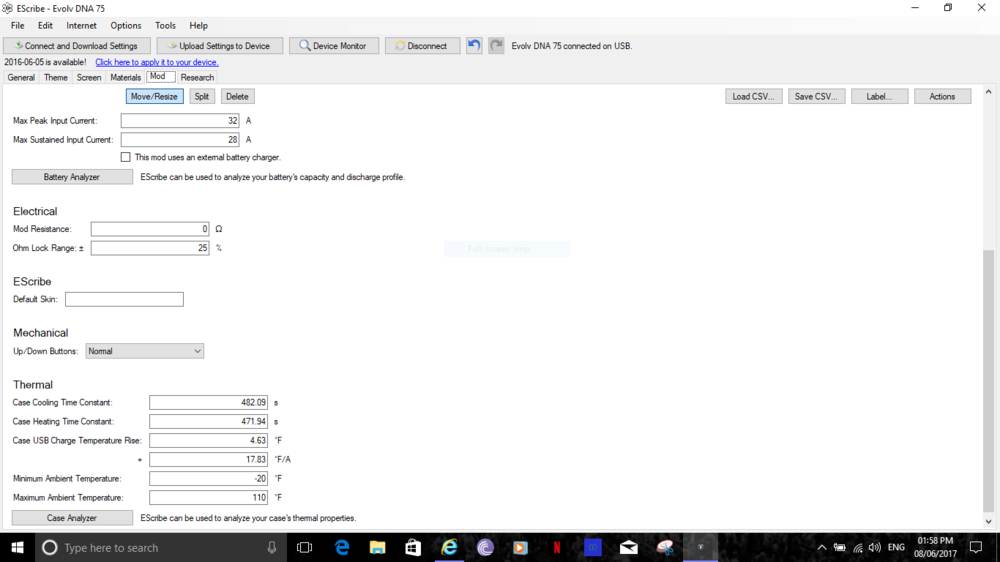

What kind of batteries? Can you post a screenshot of the 'Mod' tab in Escribe?

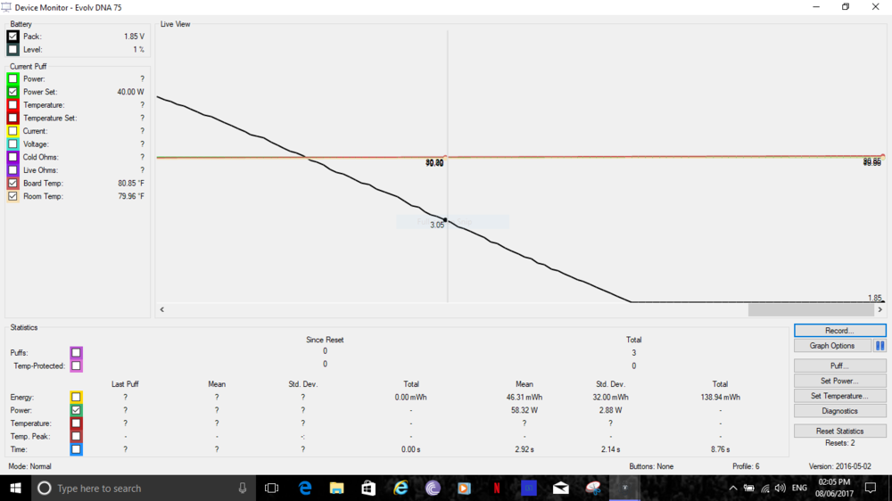

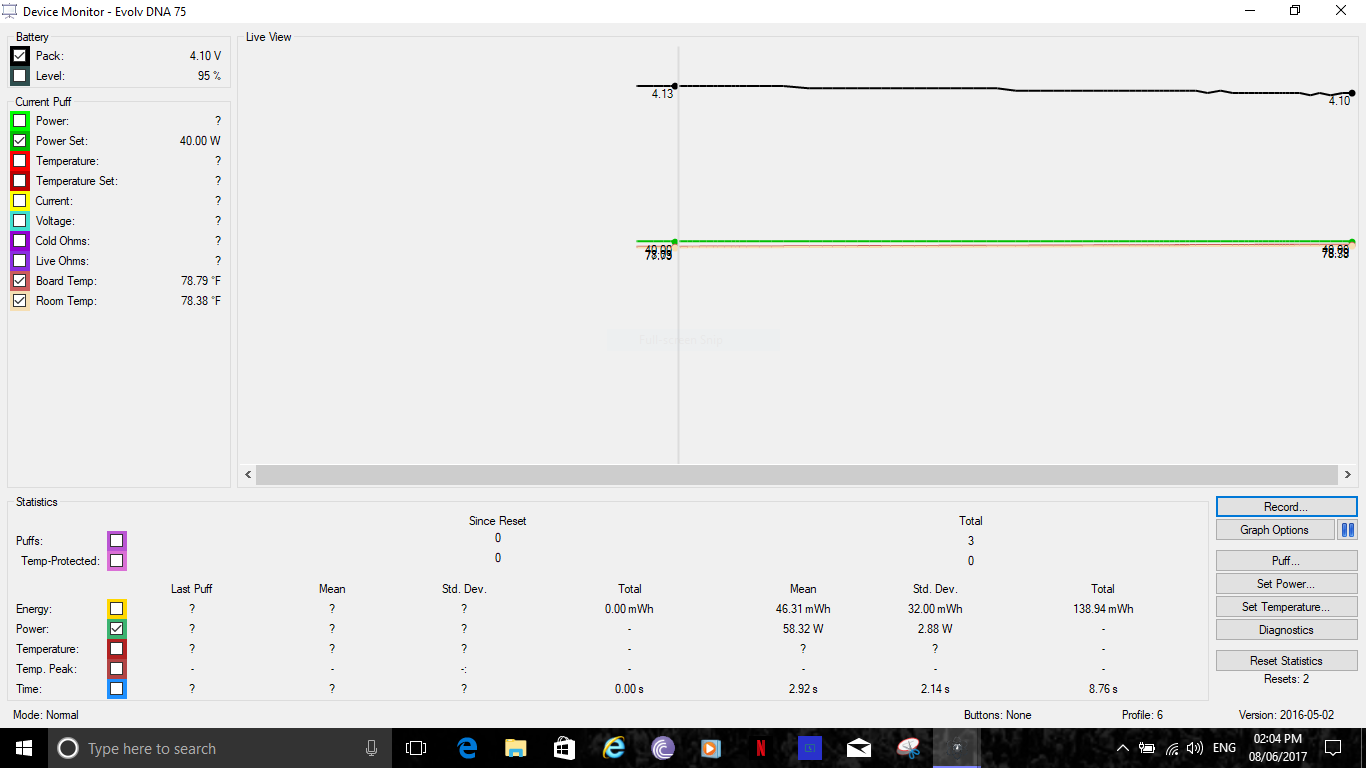

On ‎07‎/‎06‎/‎2017 at 11:14 AM, VapingBad said:
Look in device monitor in EScribe to check the battery voltage is reading correctly.
ok I can do that but I'm new to this so I wouldn't know if it reads it correct or not.....I did notice last night it said o.23v
yeah I can do that......I will do it shortly

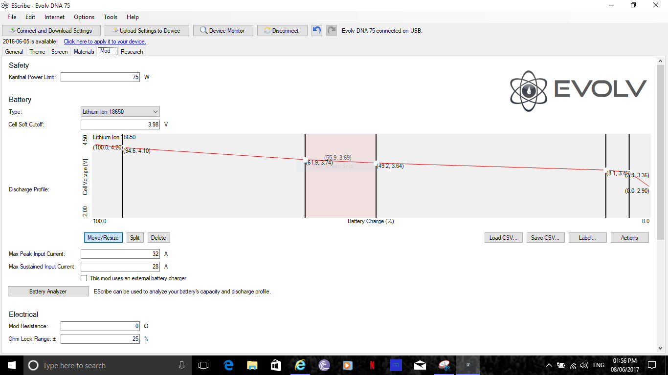

Posted
8 hours ago, Wayneo said:
Whew baby. For starters change that 'cell soft cutoff' value to 2.8v, upload to device, and see how that helps
ok cheers Wayneo, I will give that a go now and let u know

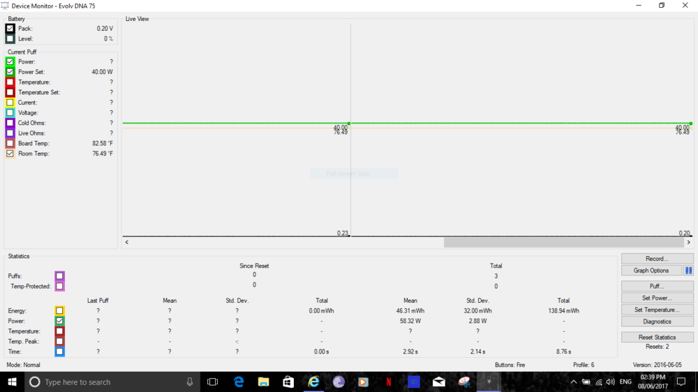

Then another printscreen of device monitor while firing. Lose the board temp tick, add the green 'power' tick.
still saying check battery
Posted (edited)

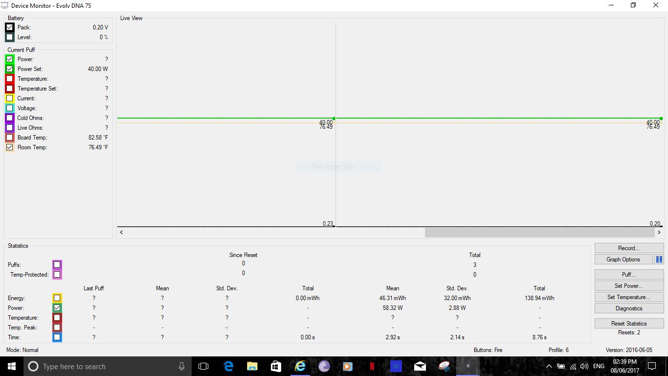

Sounds like a battery connection wiring or grounding issue. Can you check any external screws around the battery compartment
Showing .2V yet, in an earlier post your battery showed ~4v?
to be honest that was the first thing I thought of mate
Posted
yeah ive just double checked, so basically my settings are fine?? a flat battery is flat so learly a connection problem as u say.    obviously I'm gonna have to send it back to the vendor which is what I wanted to avoid
Posted
Yes, for the most part, your settings are now current, and fine (except for your mod resistance which is not relevant for this). Much wiser to work with your vendor then manufacturer before opening it up.
