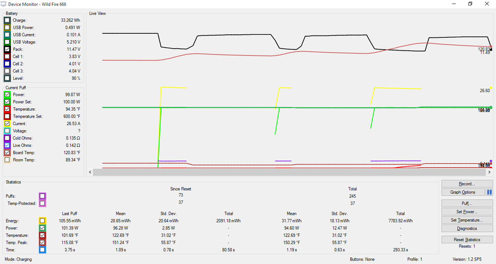

CuriousVaper Posted June 4, 2017 Author Report Posted June 4, 2017 (edited) here it is please help me. Edited June 4, 2017 by CuriousVaper
VapingBad Posted June 4, 2017 Report Posted June 4, 2017 Ok it's not the batteries, you can deselect all the battery fields and voltage, temperature, board temp and live ohms. I noticed it fired fine the first 2 of the 3 puffs in the second screen, I would check the coils screws are tight.

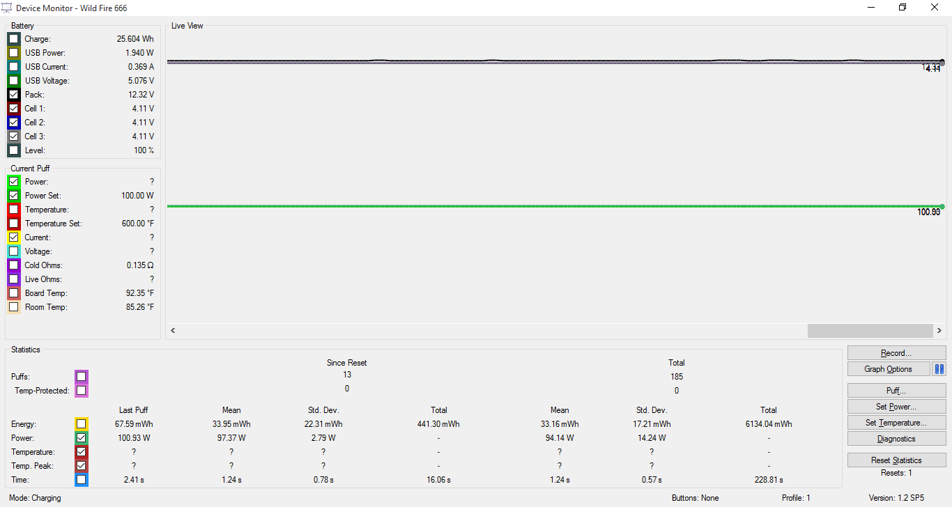

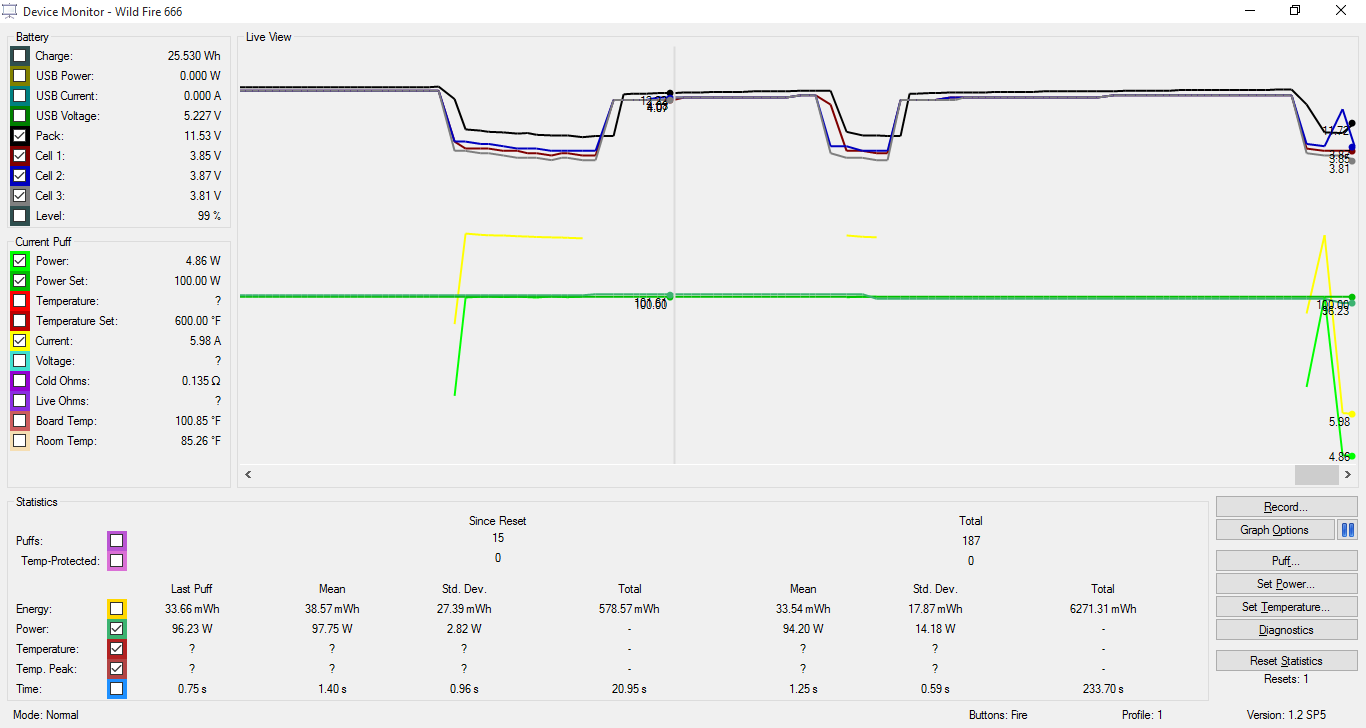

VapingBad Posted June 4, 2017 Report Posted June 4, 2017 Another shot of device monitor without the battery fields checked and with temperature, board temp and live ohms checked in addition to what you already have selected.

VapingBad Posted June 4, 2017 Report Posted June 4, 2017 Yes, but when it is not firing at the power you want, it is working fine in that screen shot.

VapingBad Posted June 4, 2017 Report Posted June 4, 2017 But Device Monitor is showing it stable at 100 W and that is the same data that drives the screen, except in your 2nd screen shot, but there is info in that to see why, the batteries are not too stressed and the current is reasonable, bat cant see the voltage, live ohms or temp. It would also be helpful to see the profile & mod settings.

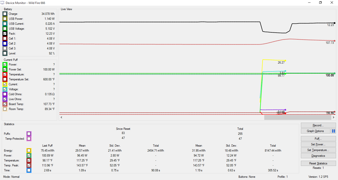

CuriousVaper Posted June 4, 2017 Author Report Posted June 4, 2017 16 hours ago, VapingBad said: But Device Monitor is showing it stable at 100 W and that is the same data that drives the screen, except in your 2nd screen shot, but there is info in that to see why, the batteries are not too stressed and the current is reasonable, bat cant see the voltage, live ohms or temp. It would also be helpful to see the profile & mod settings.
VapingBad Posted June 4, 2017 Report Posted June 4, 2017 Again that looks to be working perfectly, if you set you current limit to 26 A it may cause it to back off on the power, voltage is fine, it's is not attempting to do temp protection.

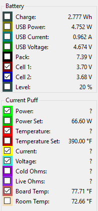

eucalyptus. Posted June 4, 2017 Report Posted June 4, 2017 Hi. "temp mode" may be the cause. When "Watt mode", temperature is not displayed in device monitor. I think temperature is displayed because it is "temp mode".
