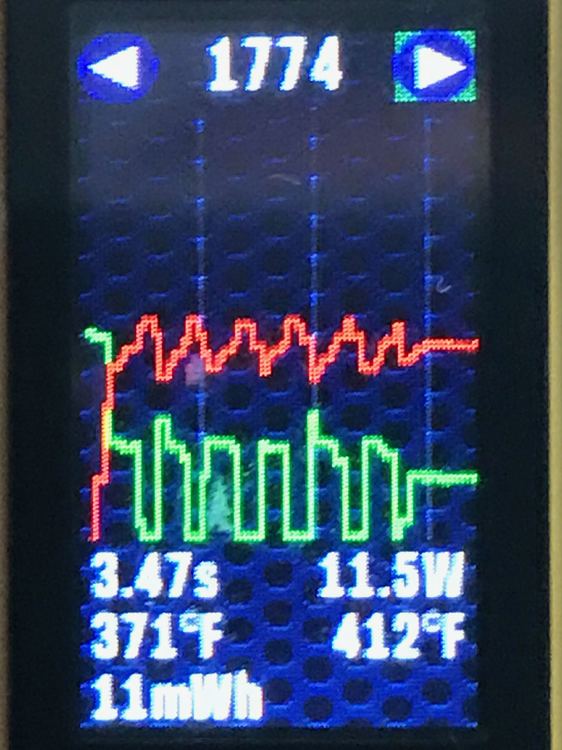

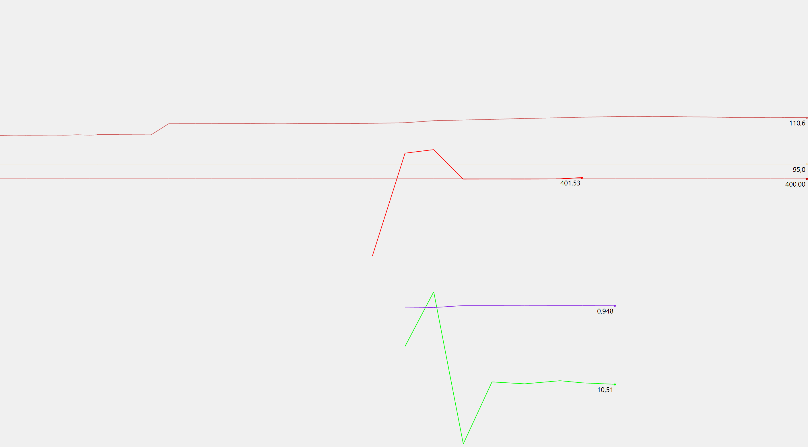

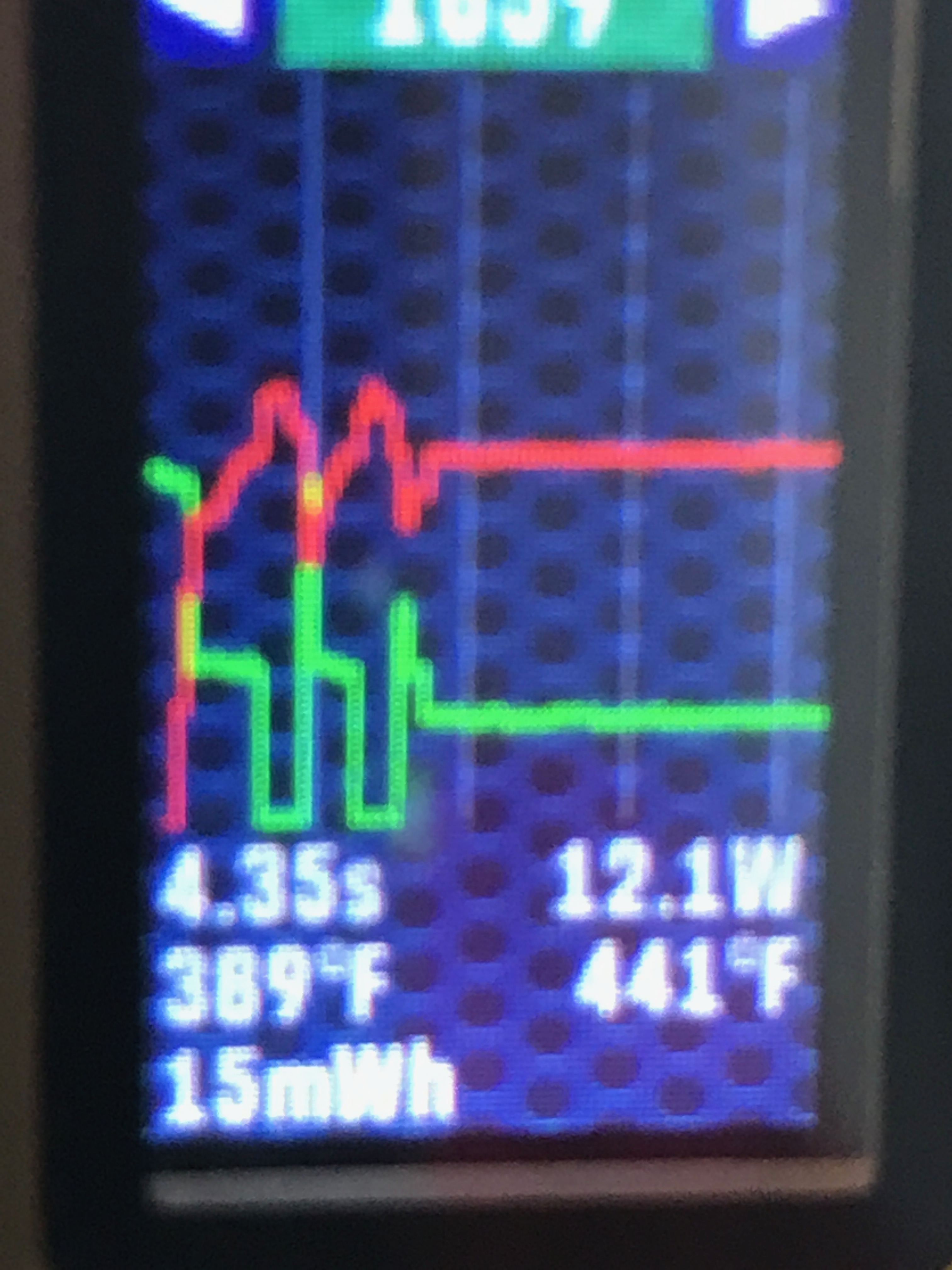

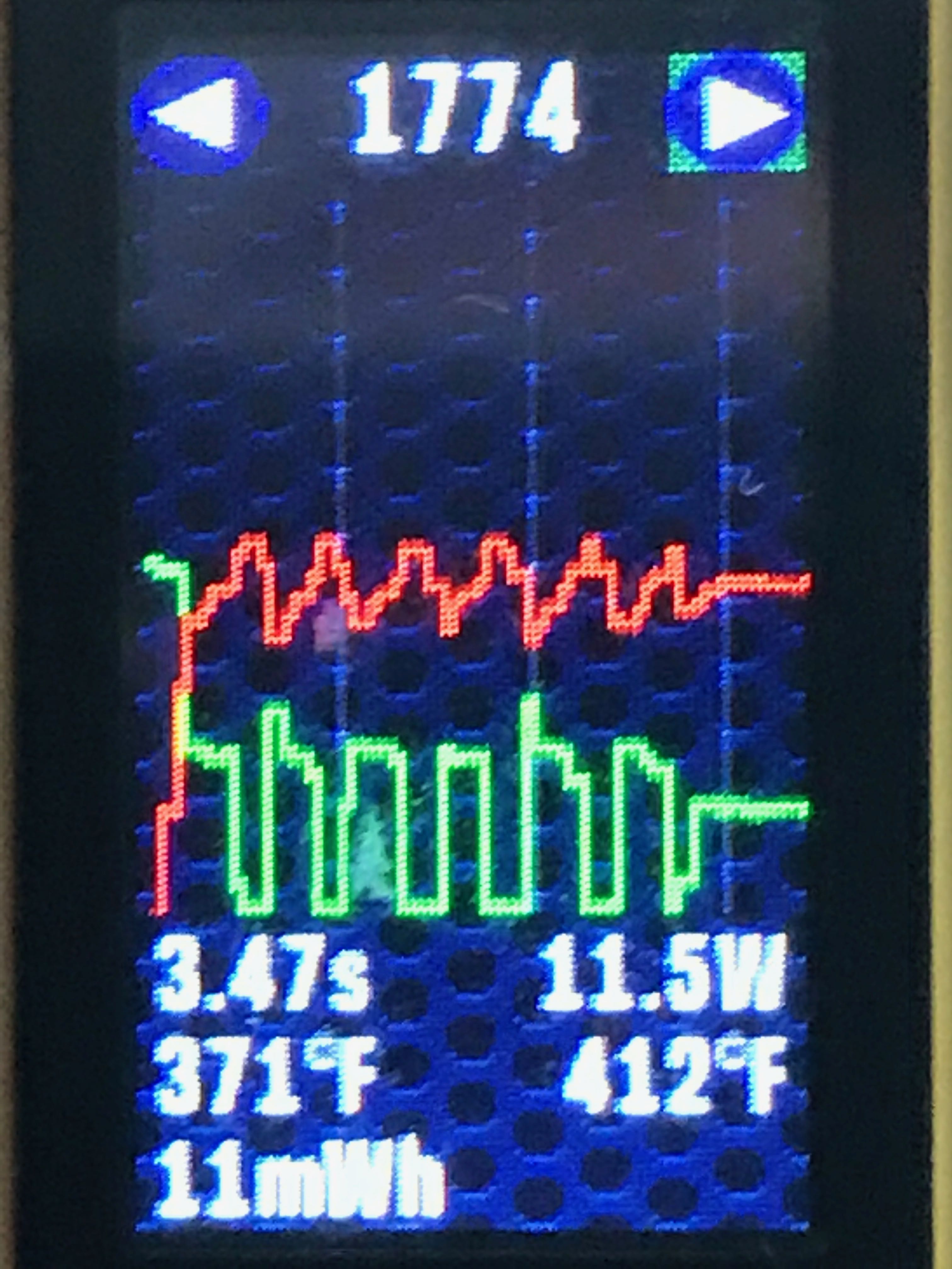

ndb Posted June 15, 2017 Report Posted June 15, 2017 @James I did some testing with the last cold values (.08253@83F). I did a series of puffs, approximately 3 seconds each, every 5-10 seconds, giving the "X=READ DEBUG" command after each. The vape parameters where: COIL: SS316L, Steam-Engine profile TEMP: 380F POWER: 17W PREHEAT: 35W, 365F I then saved the log of the terminal session and annotated each result with the classification of the puff it refers to: REGULAR for a good stable puff for the entire puff duration PULSING (PARTIAL) for a puff that pulsed at the beginning of the puff and then stabilized PULSING (FULL) for a puff that kept pulsing for the entire duration Below is the annotated log, and after that, the screenshot taken on the device for the last puff which was the worst in terms of pulsing. (I'm not attaching the screenshots for the other partial as these images are quite heavy and I've no reliable internet connection at the moment, but if you want to see some of them just let me know and I'll upload them too. You can just picture them has being the same as the attached one, with just the power square wave lasting for about just 1/3rd of the puff). Here we go: ANNOTATED TERMINAL LOG: X=READ DEBUG X=-0.050 REGULAR X=READ DEBUG X=-0.097 REGULAR X=READ DEBUG X=-0.101 REGULAR X=READ DEBUG X=-0.096 REGULAR X=READ DEBUG X=-0.098 REGULAR X=READ DEBUG X=-0.129 PULSING #1 (FULL) X=READ DEBUG X=-0.098 REGULAR X=READ DEBUG X=-0.021 REGULAR X=READ DEBUG X=-0.096 REGULAR X=READ DEBUG X=-0.122 PULSING #2 (PARTIAL) X=READ DEBUG X=-0.096 REGULAR X=READ DEBUG X=-0.092 PULSING #3 (PARTIAL) X=READ DEBUG X=-0.100 PULSING #4 (PARTIAL) X=READ DEBUG X=-0.096 REGULAR X=READ DEBUG X=-0.166 REGULAR X=READ DEBUG X=-0.121 REGULAR X=READ DEBUG X=-0.122 PULSING #5 (PARTIAL) X=READ DEBUG X=-0.080 REGULAR X=READ DEBUG X=-0.126 PULSING #6 (PARTIAL) X=READ DEBUG X=-0.224 PULSING #7 (FULL) ON-MOD DEVICE MONITOR SCREENSHOT FOR "PULSING #7 (FULL)" PUFF: Hope this will be of some use...
James Posted June 15, 2017 Report Posted June 15, 2017 OK. Well that rules out X=READ DEBUG being the problem. Out of curiosity, what power level is it dropping to there? (To get to the recording, go to Device Monitor -> History -> Download All Recordings). It looks like a current offset issue, to be honest.
