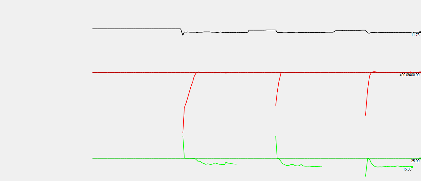

The first thing I noticed is that when in TP mode, the temperature will go a couple of degrees above what I set.  So, if I have it set to 450F, when it's throttling back on the power it will cap out between 450F andd 453F, unlike my DNA40's (I have 3 of them) which all throttle back to exactly the set temperature.  I believe my positive connection to be very solid, so I don't believe that is what's going on.  Is this just the board being more accurate than the DNA40?

The control loop is different between the DNA 200 and the DNA 40. The 200 will control around the set temperature (using up to the set wattage), whereas the 40 will avoid the temperature limit at all costs. The 200 should be much more resistant to the pulsing that you could get with a 40 if you had a high setpoint and limited airflow or other low power requirement situations. It should be smoother, but the control error will be distributed on both sides of the setpoint rather than strictly below it.

Brief answers to some points, nice mod BTW.
It it more accurate than the DNA40.

With the switching to temp limiting could it be that you has resistance locked, or you could reduce the value of Ohm Lock range on the Mod tab and see if that works better for you.
Thanks guys!  It was a relatively easy build, tbh, the solder pads made soldering the thick wire a breeze.  It's a very tight fit but I love the form factor.  There is no real wasted space.  Thanks for the info VapingBad..  If it continues to be a problem, I may mess with the ohm lock range and turn it up a little bit.  But ATM, it hasn't been too much of an issue.  The Charging Fields thing is what is really making me scratch my head.  I wonder why it's working for you, but not for me?  There's no option I can see to toggle the Charging Fields on or off that I can see... On the Default Field 2, I have it set as Battery Pack and Charging Field 2 set at Battery %, but when it's charging I still see the Battery Pack's total voltage.  I tried changing them up and putting other options for the other fields but still no luck.
