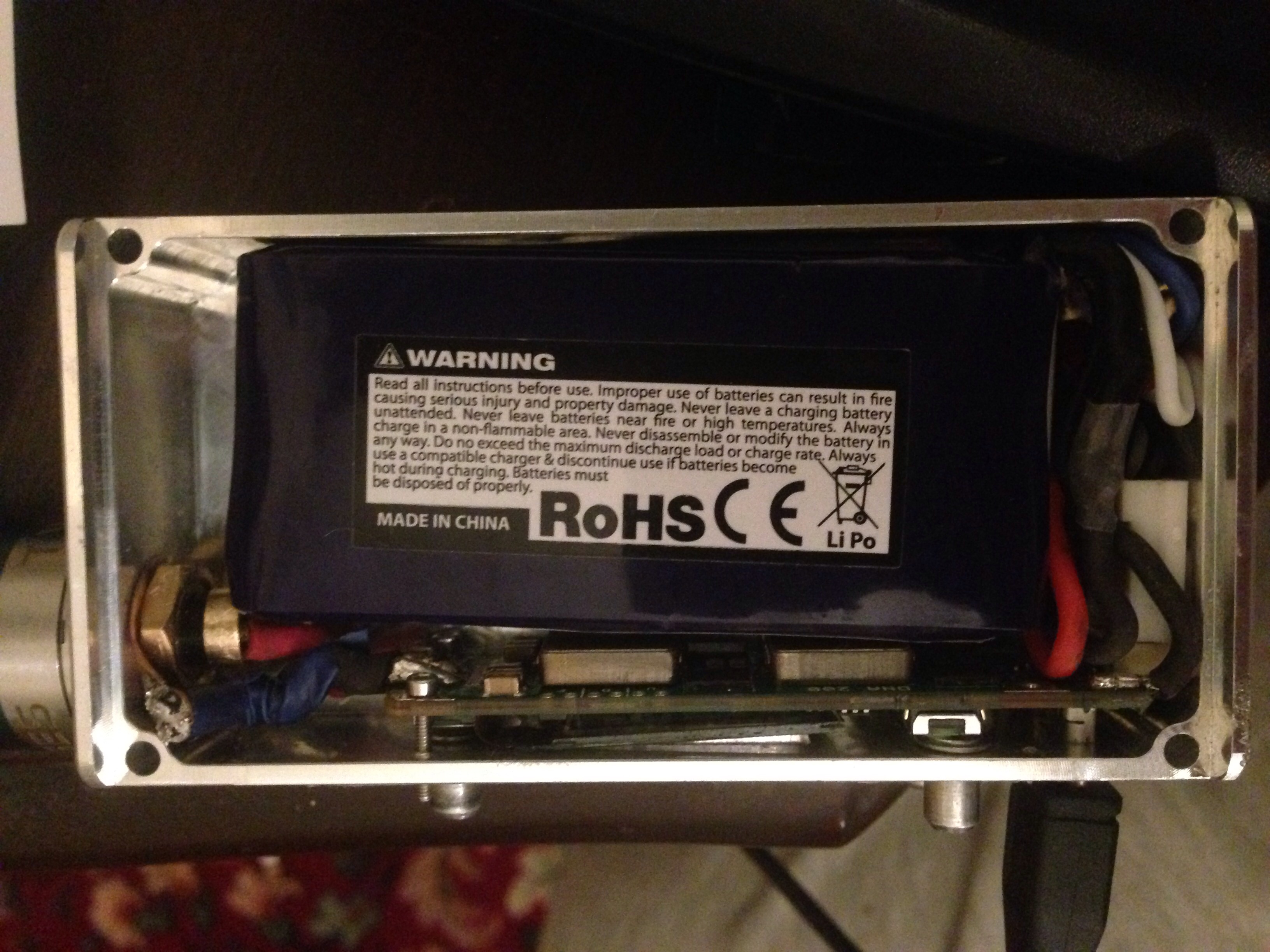

Gm111 Posted July 30, 2015 Author Report Share Posted July 30, 2015 John said:It definitely shouldn't do that. What firmware version? Is it running hot? It should go completely to sleep after an hour. A device monitor screenshot so we can see what it is doing would be most helpful to diagnose. And a picture of the mod. It was on 9/27 firmware, no it wasn't running hot from what I noticed, it definatly wasn't in the morning. What would you like me to set on device moniter? Here's a photo Link to comment Share on other sites More sharing options...

John Posted July 30, 2015 Report Share Posted July 30, 2015 That looks pretty normal to me. Maybe post your settings file?It isn't shorting to one cell or draining unusually, or you'd have imbalance. If the fire button was being held down or stuck then it would drain overnight, but otherwise it shouldn't. How big is your battery? Link to comment Share on other sites More sharing options...
