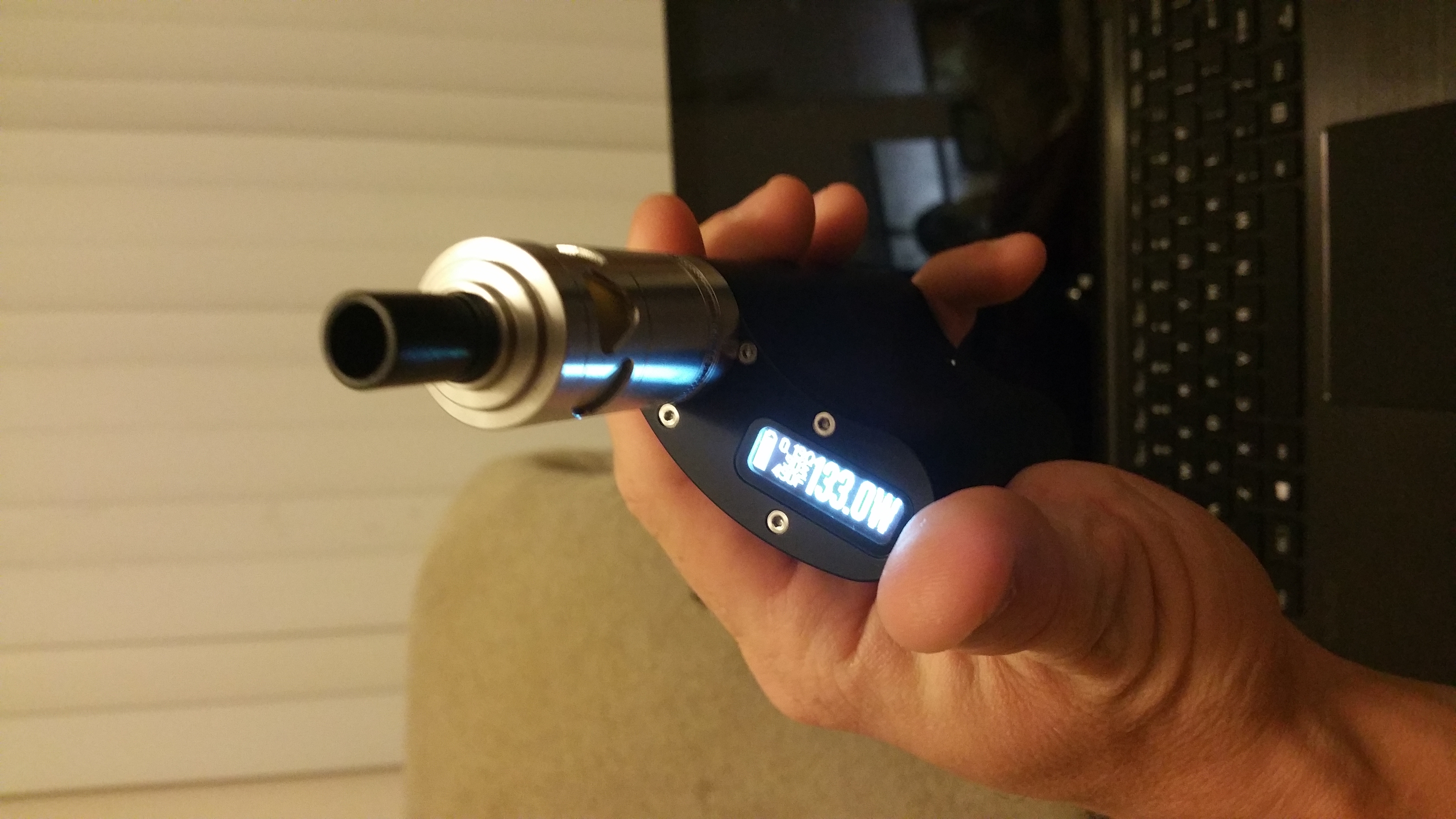

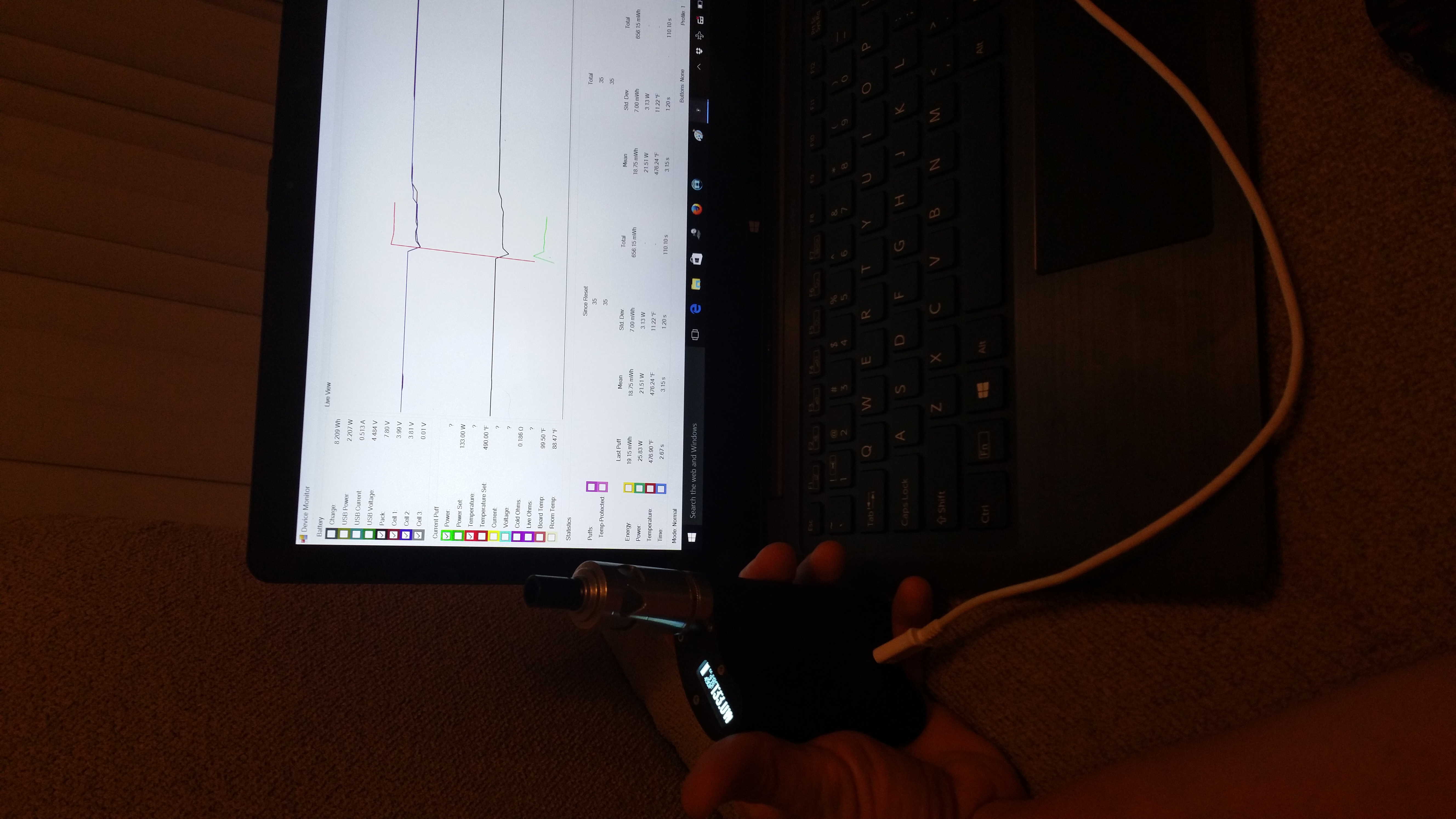

iandvaypes Posted September 4, 2015 Author Report Posted September 4, 2015 This was an extremely difficult build. From extending the screen ribbon, removing the on board usb, soldering an extension micro usb, fitting the dna 200 in the plastic sled, isolating the positive and negative contacts on batteries, fitting extra large wiring, modifying the up down button board to getting it all to fit. These batteries are removable. I used a combination of kapton tape and copper tape for one side.
